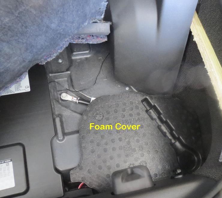

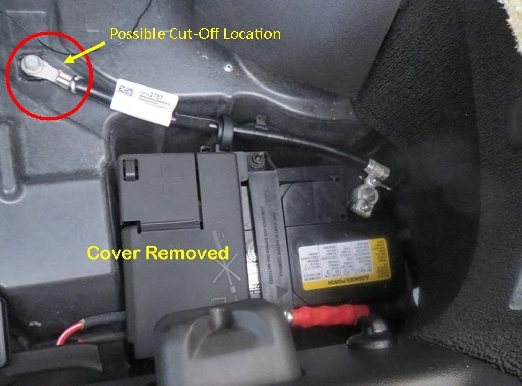

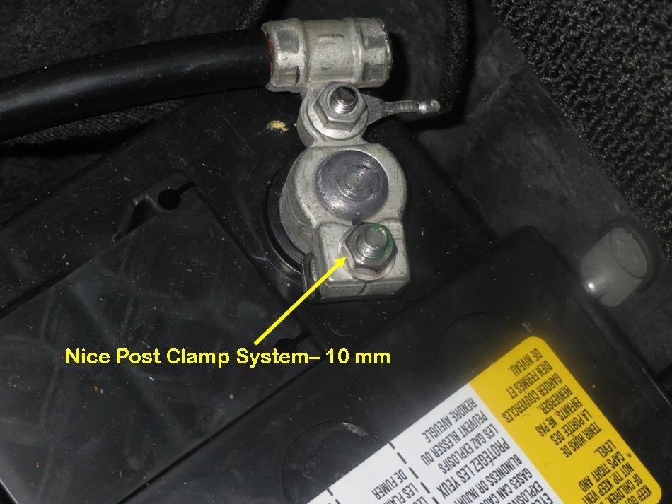

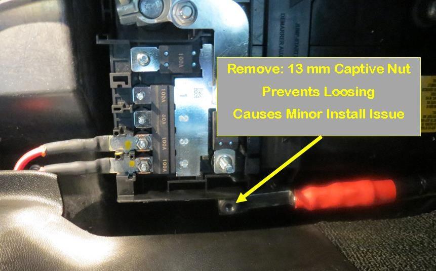

I would remove the battery. We have lots of lighting storms in spring. summer and fall. If leaving for months would not want my Vette connected to a device on a power line!
Hopefully someone who installed a cut-off will post.
However looking at the Battery location, here are some pics from my PDF of an AGM install. Noted a spot one might fit one in the ground cable connection to the chassis but would be a lump in the carpet and to access would require removing the carpet. In addition, there is a neat clamp on the ground terminal that is clamped with a 10 mm nut. Might as well just remove the ground terminal.
Rather than add a cut-off might as well just use the nice post clamp with a 10 mm wrench.
Not easy to add a cut-off on the positive terminal as a large power board is attached.
Best option might be to remove the battery and put near a window, wherever and use an inexpensive solar powered batter charge, like this ~$15 unit from Harbor Freight.

From the picture @jerryU posted, the positive terminal will be very hard to disconnect, as you see it is a plate that has several wires leaving it, one is for the starter and if I had to guess the other 2 100A wires are to the fuse blocks among other things..
As I read the schematic in the Service Manual there are several 100 amp fuses and fuse F6BA on the power board is 350 amps! Guess one could mess with the copper buss bar that carries all current but not simple!
Now if you were drag racing in a class that required an external operated cut-off that's one thing but much easier to unbolt the ground post for other needs. IMO.

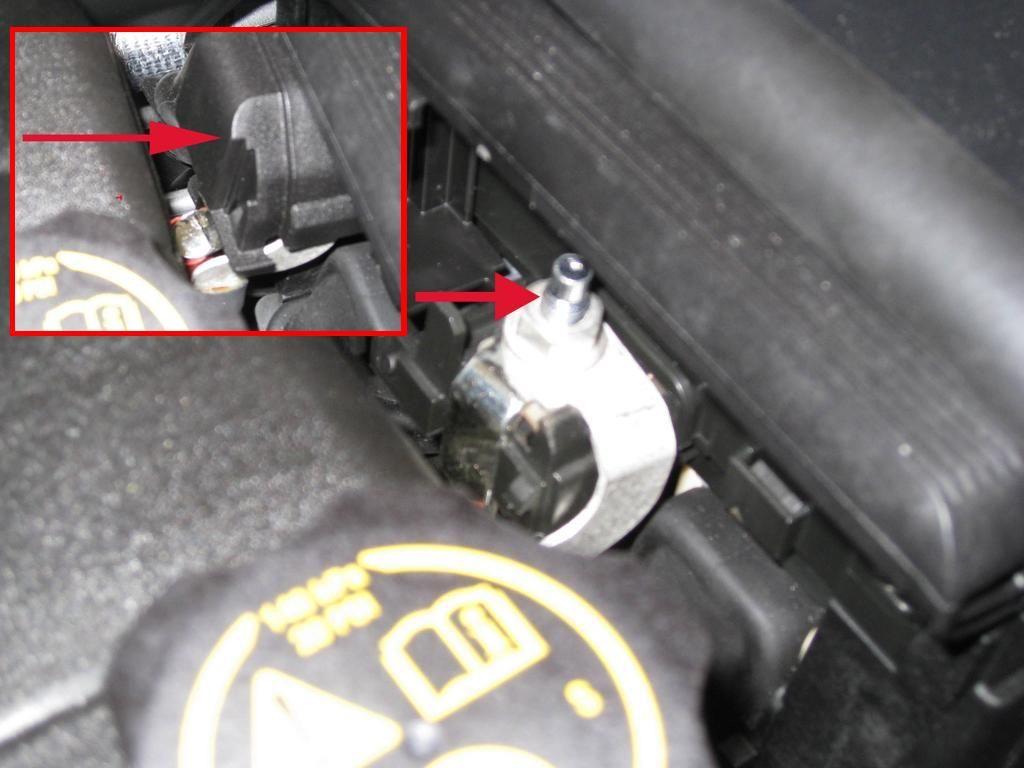

This is another pic from my PDF re an AGM battery replacement in my C7.
PS: Yep, lots of controversy about not having a post in the engine compartment on the C7 when the intro to the 2014 Owner's Manual said there was a location to jump start from the engine compartment. However all the pages it referenced said only jump from the battery! I sent PM's to the Chevy folks who monitor the forum (much more often in 2013/2014.) I asked where the post was when folks said it was the one in the pic below. However I wired my street rod and it's battery is in the far right rear. After calculated the needed wire size o carry tarting current, I used a wire 4 to 5 times the size of that going to the front fuse panel! First they said, "their sources" said the Owner's Manual was correct. Then I asked, if correct, where is the location. After several attempts the Chevy Monitor said they could not get an answer "from their sources!"
Issue resolved with subsequent year Owner's Manuals! The Owner's Manual ERROR in the 2014 into was eliminated. There is no location! Have found they will never say there is anything wrong with the Owner's Manual even when there is!
Pic of front fuse panel power input connection. It can be used for accessories or a charger BUT not recommended to jump start etc. Can connect positive power wire here with a ring terminal and ground on one of the chassis bolts with alligator clip. DON'T REMOVE THE NUT, ADD RING TERMINAL THEN ANOTHER NUT ON TOP.

That stud in the picture would probably work for a clip on connection for a battery tender or other battery charger (up to 20 or maybe 50 amps).
I wouldn't consider that for jumper cables to start the car, though.
That is definitely an alternate connection point for a battery tender, though, without having to dig for the battery.
I wouldn't consider that for jumper cables to start the car, through.
But had many forum members telling me I was wrong to question it’s use for jump starting. They quoted the incorrect 2014 Owner’s Manual intro as proof. But then they also questioned my inability to latch the hatch without a door open only exhonorated when GM reverted to what I had in my C6 in 2016, a motorized pull down.
They overhyped the “magic memory wire activated vent” that did not work for all C7’s! Never said why, just switched after enough folks had paint crack in the lower hatch frame and several had the lower hatch frame crack from excess flexing from pushing hard to latch.
