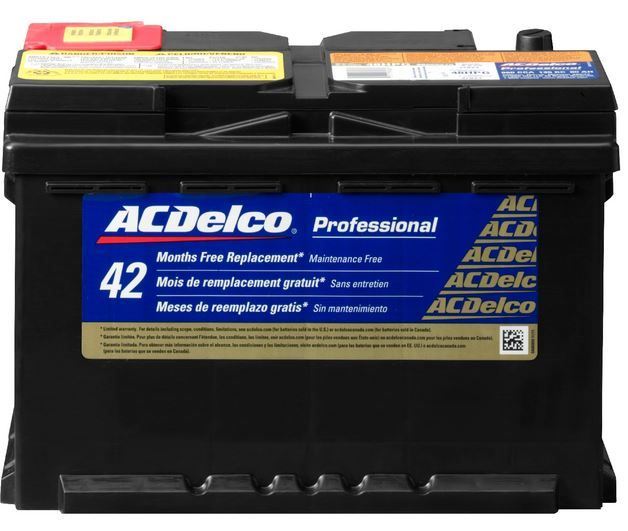

My 2014 came with just a 36 month battery, so you can easily upgrade to the AC Delco GOLD series battery with a 42 month free replacement.
I have had good luck just staying with the Delco Professional grade batteries.
Bought mine at a local parts store that carries AC Delco, list for $216, bought it for about $130.
I think it has around 770 CCA, and 960 CA.
Most other brands are going to be down around 650 CCA
