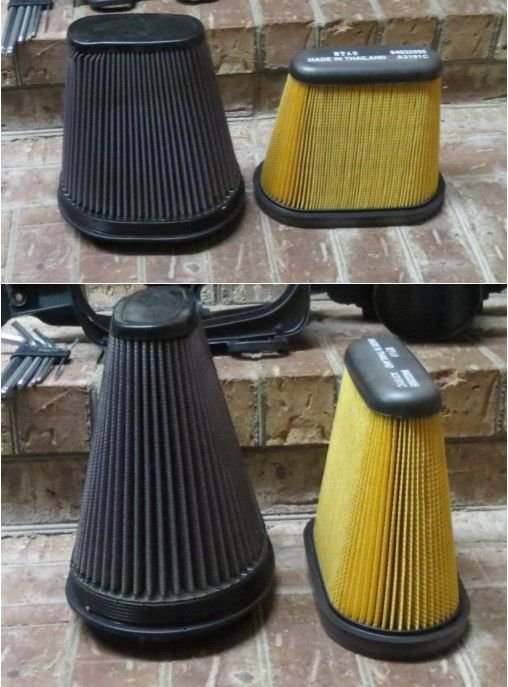

7) No way! I posted one pic. the aFe filter is not only lower restriction but larger! It needs a larger housing and shorter tube.

Smaller OEM paper filter right, larger oiled cotton left.
