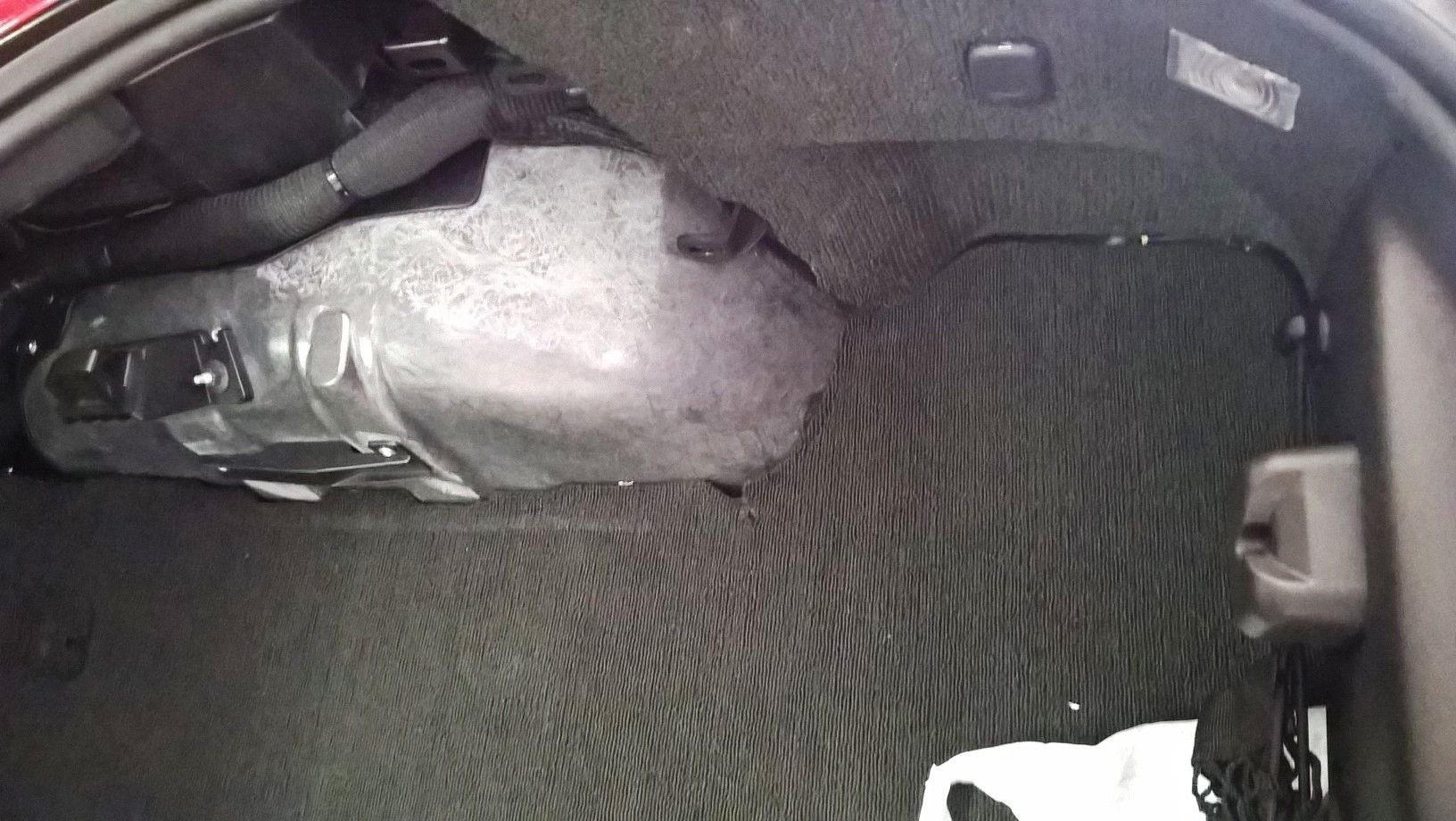

My mirrors are now misbehaving, nothing else, but hey, after as many miles on C6s as I have, this is the writing on the wall.
I have always let the boys at the autopartstore replace them, and am an inclined to do so here, is there any reason not to let them do so?

You have to be very careful about getting the carpet from under the side trim and folding it back or it will rip the backing.. I ended up just removing the whole side panel to be safe. Still not easy to get battery out of well and over the fender.. remember there is a vent tube next to the fender side that will hang up if not removed.
