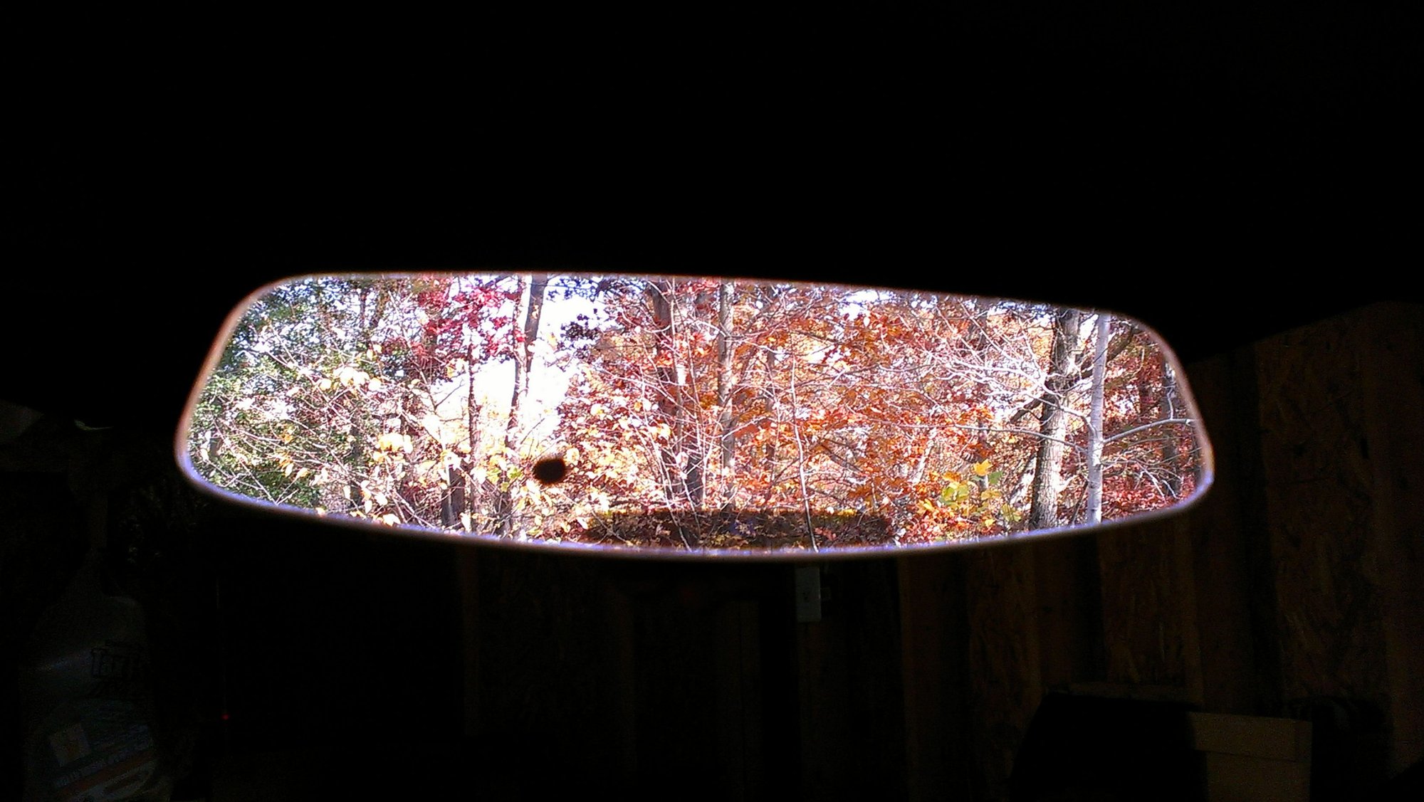

The mirror uses a combination of the dash dome sensor and a sensor in the RV mirror itself.
When it determines lower light via the dash and bright light in the mirror, that is when it will dim. The DS mirror is slaved to the RV mirror. There is no on/off switch.
The black dot is exactly where the sensor is on the mirror:
To test it, you can put something over the dash dome, and shine a light in the sensor on the mirror. A dark garage with the door open and bright sunlight outside should do as well.

You may find your mirror is dimming but not as much as you are used to. My 2017 dims less than I would like and less then any of our other cars.

I think that may be the issue. My other vehicles seem to really get darker as i like, the lights never seem to bother me but on the vette they bother me to the point where i sometimes tilt the mirror out on my view.

The seat heaters aren't as strong as the ones in my previous C6. Definitely not as strong as the ones in my 03 Tahoe. The Tahoe will blister your behind and back if you leave the setting on high. On the high setting the C7 seats seem to run about the same temp as the low setting on the Tahoe. Our 2015 Terrain seats heat about the same as the C7. Maybe we have another deal like the McDonald's coffee being too hot.
Seat cooling works fine by blowing a gentle breeze up underneath your body on a hot day. I try to remember to turn it on when I am on track.
I have noticed the auto dimming mirror field of view seems to be pretty small. If the lights of the car behind you don't hit it just right it will not dim. I prefer the old fashioned manual mirror that you flip up and still see even when there wasn't anything behind you.

Like others I find the mirror dimming to be a little anemic. And as Bill noted and owC6 nicely illustrated the sensor capture area is small. At night I slightly readjust the mirror so that it is more responsive to headlights, it is worth having this over the optimal placement although it is an annoyance.

I'll have to fiddle with the mirror adjustment to see if it is more responsive. The DS mirror works as I expect, much dimmer than the rear view.
