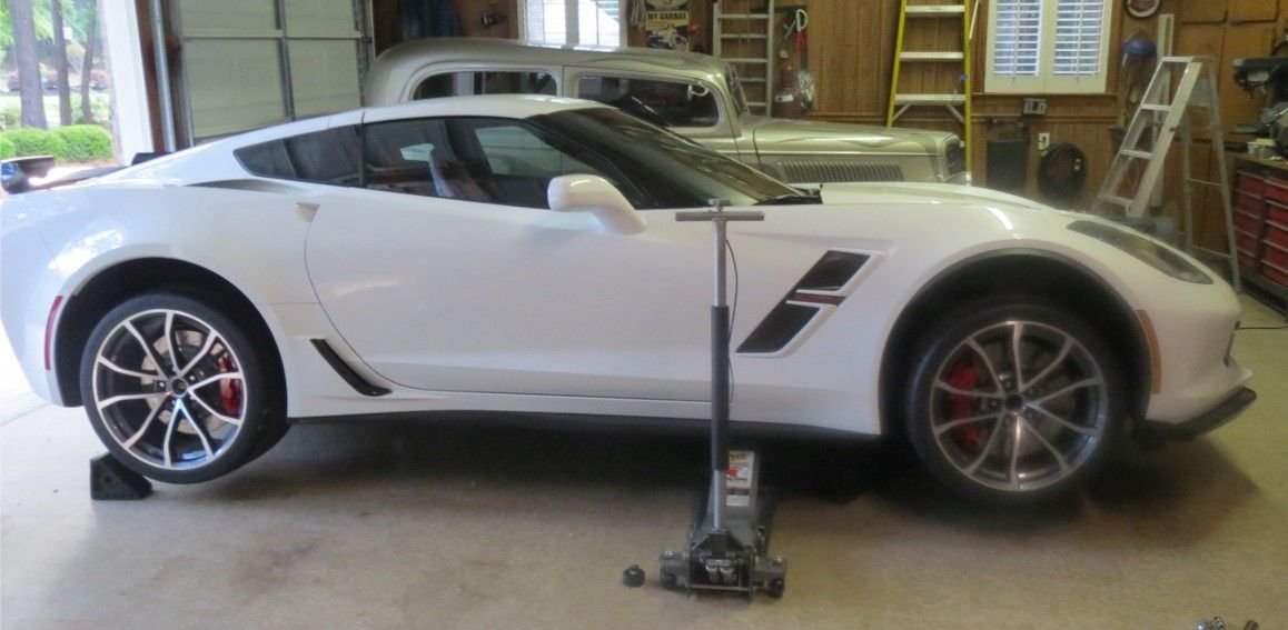

First, GM says for C7 to use 2 1/2 inch max diameter pucks. I found the rocker panels are closer in my 2014 C7 than my C6 and those 3 inch aluminum pads did not work for that reason. As suggested above try them, they may fit and NOT hit the plastic panels.
A 3 inch Hockey Puck works for most folks as the eye hook can be pushed to one side of the frame slot.
I would NOT use any simple pad, wood or Hockey Puck without something that holds it to the frame IF you are using a hydraulic jack! The jack MUST move into the car as you lift so the jack saddle stays under the pad. Pads anchored to the frame "help" pull (but do not guarantee) it along-MOST times! I know because it didn't once when jacking on a rough concrete driveway!
See pics below:
How Much Jack Must Move in to Stay on Jack Pad Depends on Jack Size
Note: Measurments assume all lift height is the max for the small jack.

I keep my jack pads in the compartment in the rear in case I have to go to a dealer ("cringe") or a tire store. I put one of my now 4 hydraulic jacks perpendicular to the Vette AND carefully swivel the rear casters so they are ready to move in. In the 30 years I have had Vettes (and before) never had a problem! But only takes once!
The issue occurred with my small, short arm jack so went and bought a long reach jack from Harbor Freight that needs to move in much less! However it weighs 95 pounds and when I went to use it on my very smooth tiled garage floor it was not moving in! The problem is to have the jack spec showing it can reach very low they made the jack saddle very shallow! Solved that by welding a 1/2 inch steel strip to the edge of the jack saddle! Now, with a proper jack pad that inserts into the frame slot it pulls in fine! Would pull in on my concrete driveway as well! The key is to watch the saddle jack pad relationship as you lift!
Even jacking on my smooth titled garage floor, the newly acquired, long reach, 95 pound jack was NOT moving in as it lifted! Would be worse on concrete!
Welded a 1/2 inch steel strip to the jack saddle using spot welds than filling in-between, (the reason for the rough appearance but functional!)
This is where the slipping issue occurred on my prior 2014 C7. The surface is NOT that rough and the jack did move in but NOT enough. My bad for not watching the jack saddle jack pad relationship after each pump. No one was hurt but it did slip! Just providing the info to make all aware of the issue.

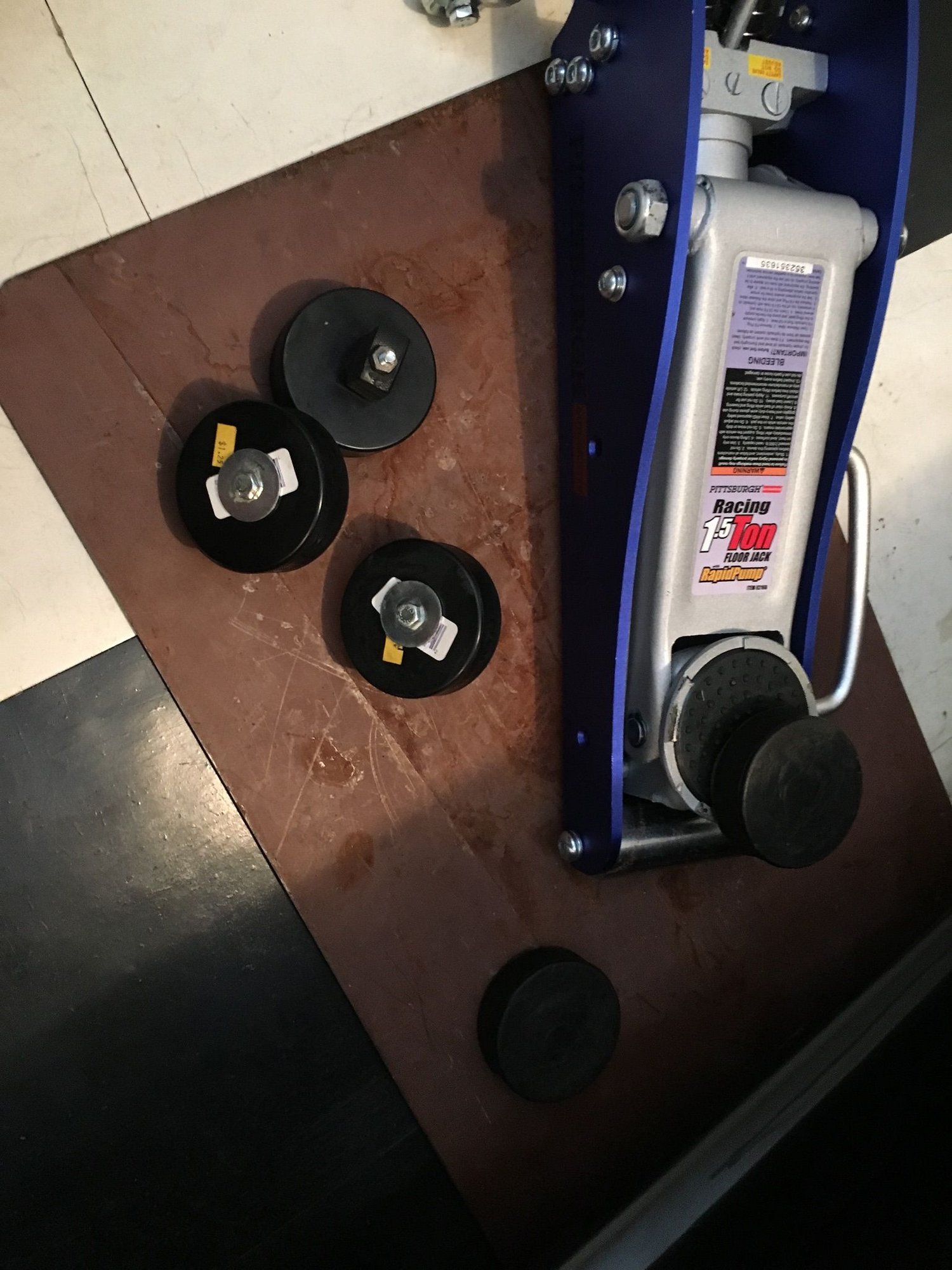

Here’s my rig. I went to a metal shop and picked up some sheets of 1/8 metal. I never jack any vehicle w/o these under the jack. And I pay attention that the jack is rolling lifting and dropping.

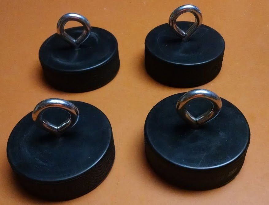

When we bought our C5, I purchased real hockey pucks and stainless eyebolts from Home Depot. Drilled the holes through the pucks slightly smaller than the threaded shafts on the eyebolts and the bolts cut their own threads as I screwed them in. The bolts can be adjusted by screwing in or out so they fit just right into the frame slots, so they worked just fine on our 2001, 2006, 2009, and now 2017.
17 years later, still using the same pucks.
