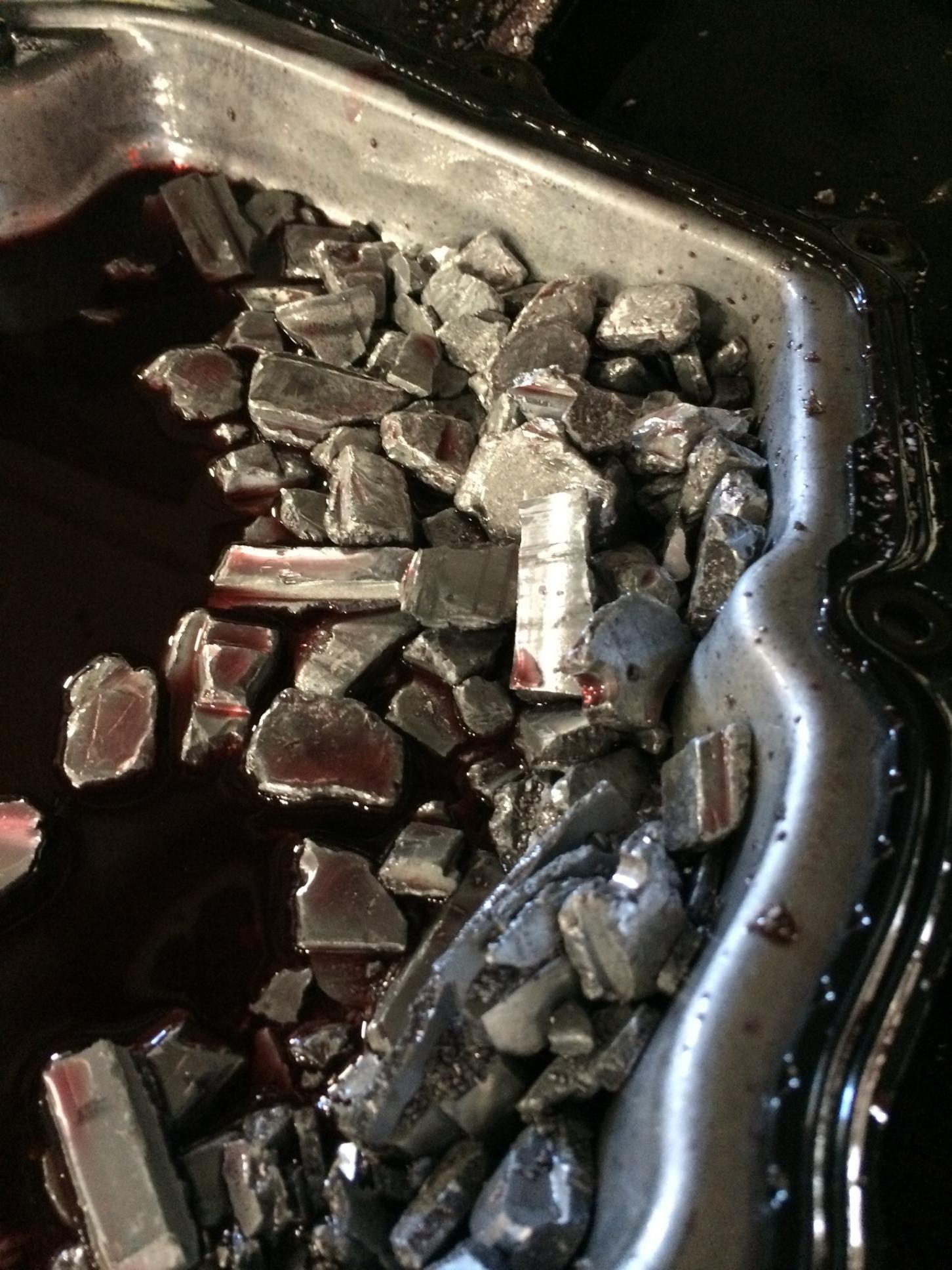

Originally Posted by SRQStingray
Never heard of any Corvette transmissions “blowing up”. Have been reports of problems with A8 torque converters on early A8s.
A8 in a 2015 Z06 with 7,000 miles.
Photo of pan full of transmission internals.
I would say it "blew up".
WOW!...

Old Joe has been posting that photo forever. Companies keep replacements for every transmission they sell in the repair inventory because, guess what, they all have instances of failure from the cheapest Chinese stuff through industrial Allison and Aisin transmissions.
The A8 in my 2016 Z06 works beautifully in all kinds of driving conditions however I do NOT let the engine go into V4 mode because constant modulation of the torque converter clutch is going to increase wear-there is no way you can constantly cycle a friction clutch multiple times per second without having far greater wear than one that locks and stays locked at cruising speed. Different fluids with different levels of friction modifiers can reduce and mask the issue but they don't make it go away.
Had that happen to an Audi.
Three sides to every story. Was this car beaten like a rented mule? Modifications? And, of course, a valid warranty claim / manufacturing defect. My A8 is a hoot! Runs like a top.
