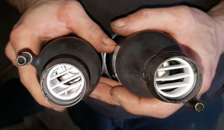

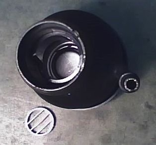

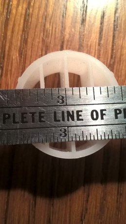

I wish now that I had gone ahead and left the anti-siphon grid out of mine when I had the fuel inlet off just to see if that made a difference in having the pump shutoff.. It is very easy to knock out if anyone wants to try it while they have the wheel well liner off...(possibly to remove the fuel door lock actuator)
Same here. I never had a problem before allowing the recall* to be performed, and now it's hit or miss. Some pumps, it happens most if not all the time.
When it does happen, the 180 degree trick always works and shuts off automatically, and sometimes I can slowly rotate it back to normal position after a few gallons, and it will behave.
*some '14s, but not widespread, so don't worry.

Well I so far have only filled mine once at a station the other two times i used race gas cans as i was getting non ethanol super in preperations for winter storage, however on my ram 5500 Cummins i have to rotate the handle 90 degrees, I used to have to rotate 90 degrees and go slow, especially in hot weather but i removed the siphon grate and installed a locking cap instead (more worried about people adding things then stealing fuel anyway) Now i can pump w the handle straight on most pumps but if it does kick off turning 90 degrees sideways will now let it full speed. Perhaps try the same on the vette?
