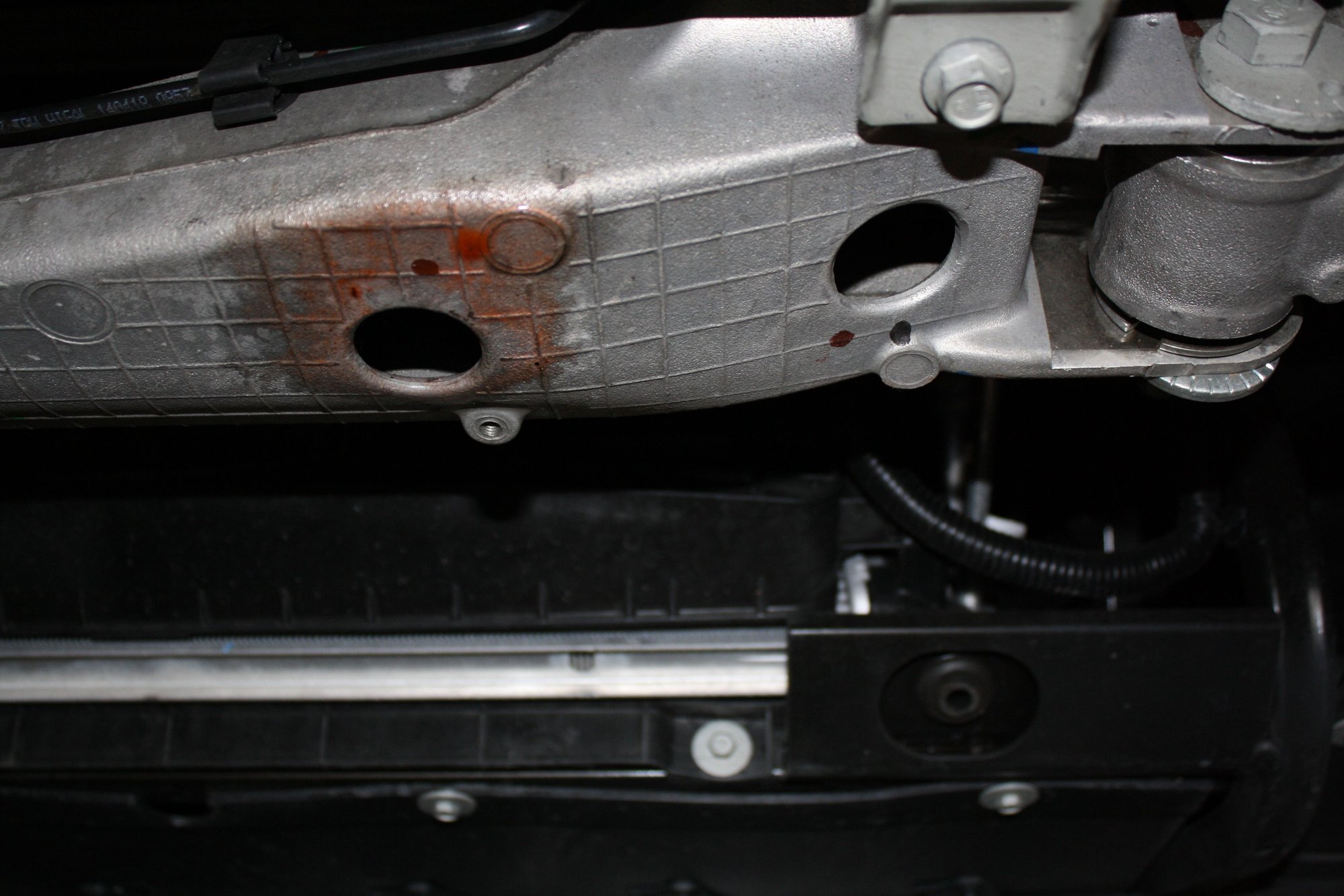

This is got me stumped, right side and i believe its one of the coolant line leaking but no real drips and its a greenish color. The only thing i have done is installed a haltech and had to reroute lines. the coolant does look a little low but thats orange. Can it turn green sitting? No codes or anything and runs strong and temps all within range.

I don't think it's coolant, isn't Dexcool pinkish orange?

its not orange. im leaning towards a a/c compressor leak....gonna have to make and appt.

This pic is a C7 water pump leak, orange. Better get your car on a lift to get a better view.

its def. a green tint

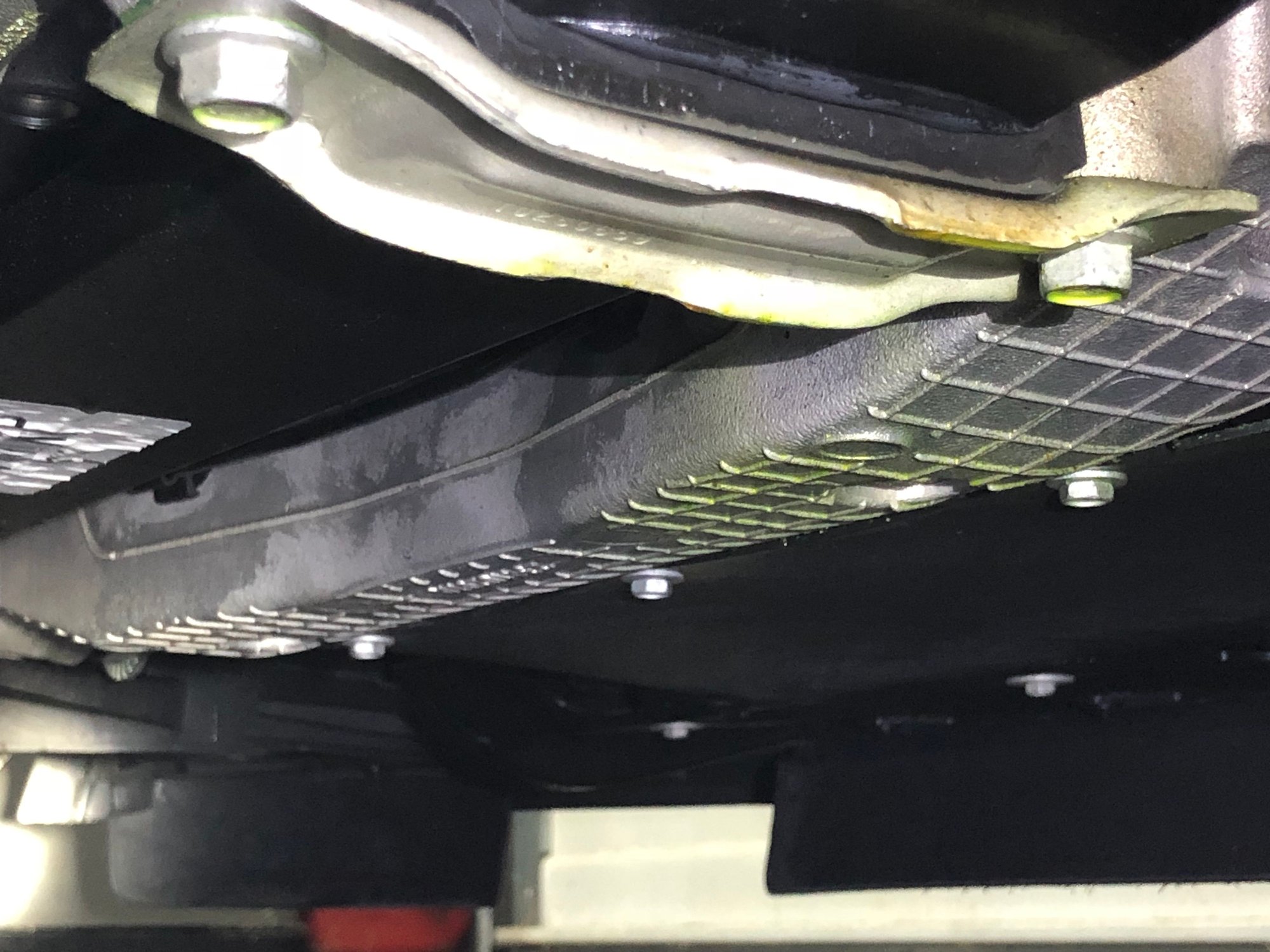

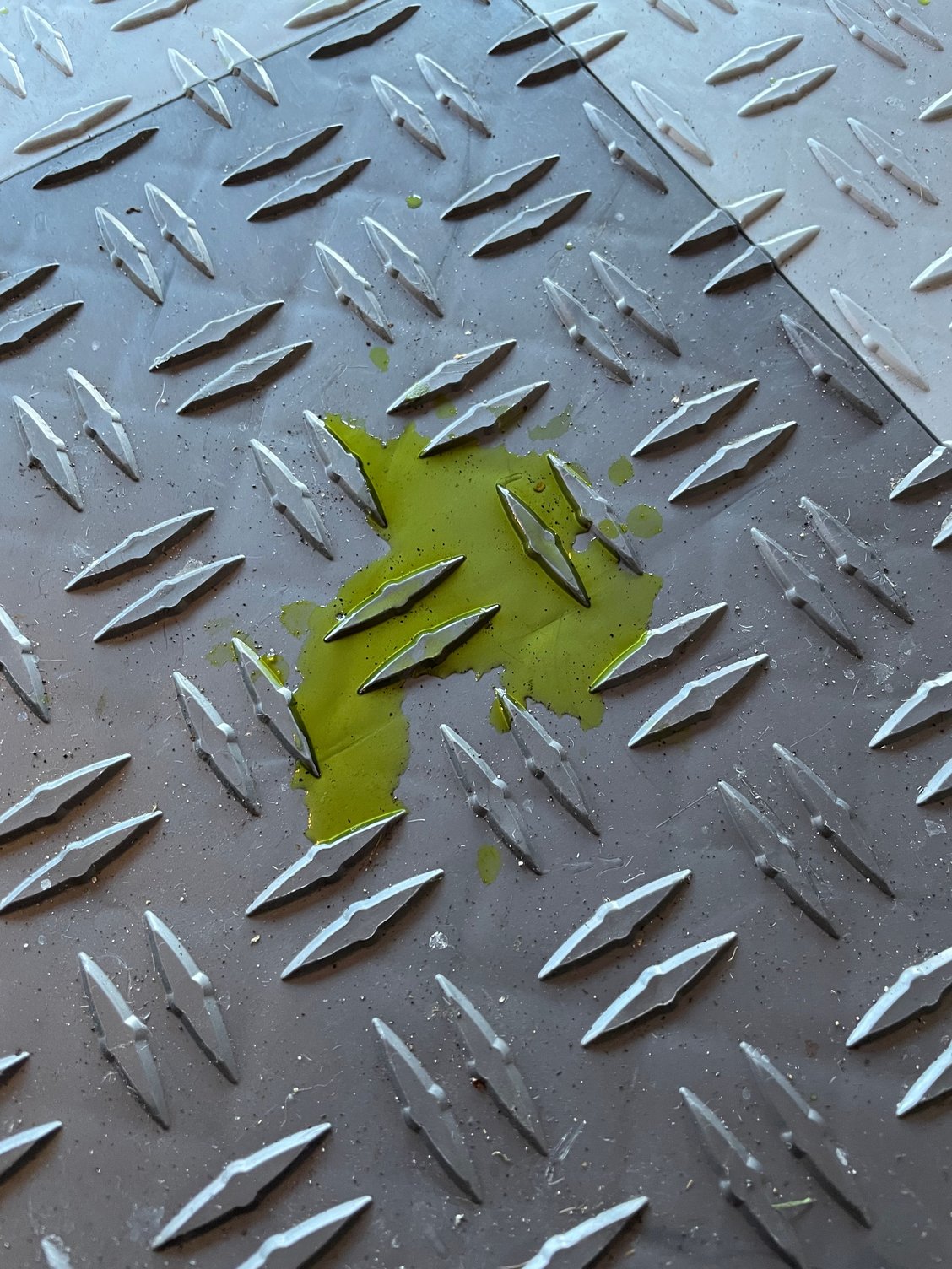

Was it this color? Went for a drive today (after the car had been sitting for about 2 weeks) and discovered this when I got back. Checked the underside and the engine bay and can’t see any similar fluid anywhere on the car (nothing else is parked in this spot). It didn’t feel like engine oil, never seen ac compressor oil before. Any ideas greatly appreciated it. Going to let it sit overnight and look for something hopefully obvious tomorrow.

So nice the oils/fluids are color coded.

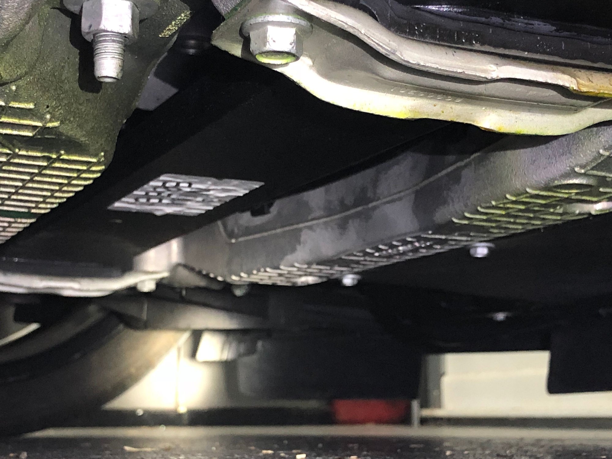

didnt find anything from overnight. I’m kind of stumped.
