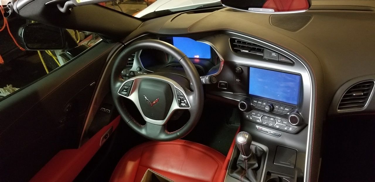

This weekend I finished up my "2.5LT" dash conversion. I wanted to do the piece on the door, and couldn't find anyone to re-cover my current piece for a reasonable price. Since it's not available as a separate piece from GM, I ended up buying a whole 2016 door panel for only a little more than I was quoted for just the leather work on the standalone trim piece. Now I have the red piece I need, and a whole spare door panel with switches and other parts.

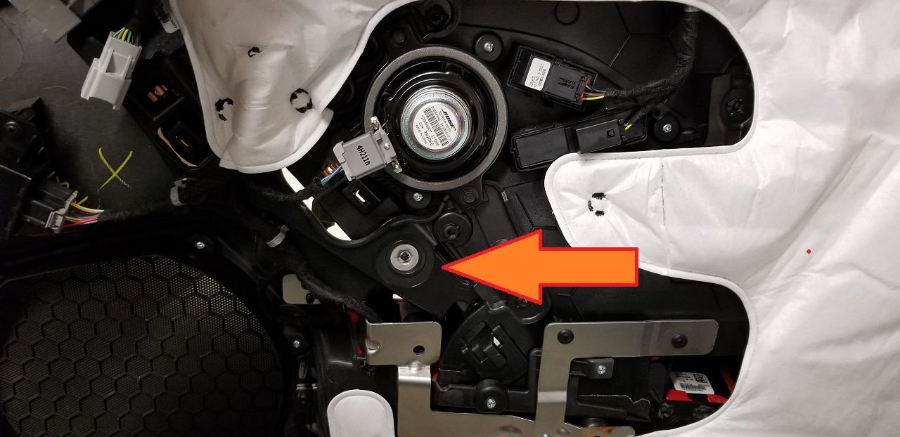

Anyway, one of the threads on the forum suggests you can remove that door "spear" without taking the trim panel off the door. That is not true. It's fortunate that I bought the entire door panel, because I discovered a nut on the back of the door spear.
When I disassembled the front side of my 2014 door, I found that the spear wouldn't let go. So I went through the very difficult process of removing the entire door panel and sure enough, there was a nut on my 2014 door too.
These door panels are held on with some very tenacious fasteners. I was sure I was going to break something. Fortunately I only damaged one clip, which I was able to replace from my spare door.
When I reassembled everything, I left the nut out just in case I ever decide to put it back to stock. I can swap the part without taking the door panel off again. The door spear is still firmly attached thanks to all the other fasteners and overlapping trim pieces. I think the only reason the nut is there to begin with is to allow for quick and accurate alignment at the assembly plant. The door spear is independently adjustable so it can be lined up with the dash hood. There's 4 bolts behind the aluminum trim piece that hold it in place.

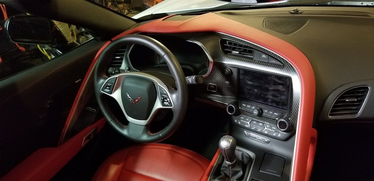

The results were worth it, but just barely. While I was at it, I installed an OEM carbon dashboard.
Before:
After:
Something else to keep in mind if you're shopping for parts. Doesn't matter what color you're swapping to. 3LT/3LZ cars had the full leather wrapped upper dash. 2LT/2LZ cars, including the 2016 and up 2LTs with the colored dash, had a harder synthetic covering. Try to get your donor parts from one car, or find someone who can give you rock solid answers on part numbers. Otherwise you may end up with a material mismatch between your dash, passenger handle and door trim. Fortunately I was able to get all my parts from the same car (2016 2LZ Z06) so everything matched.

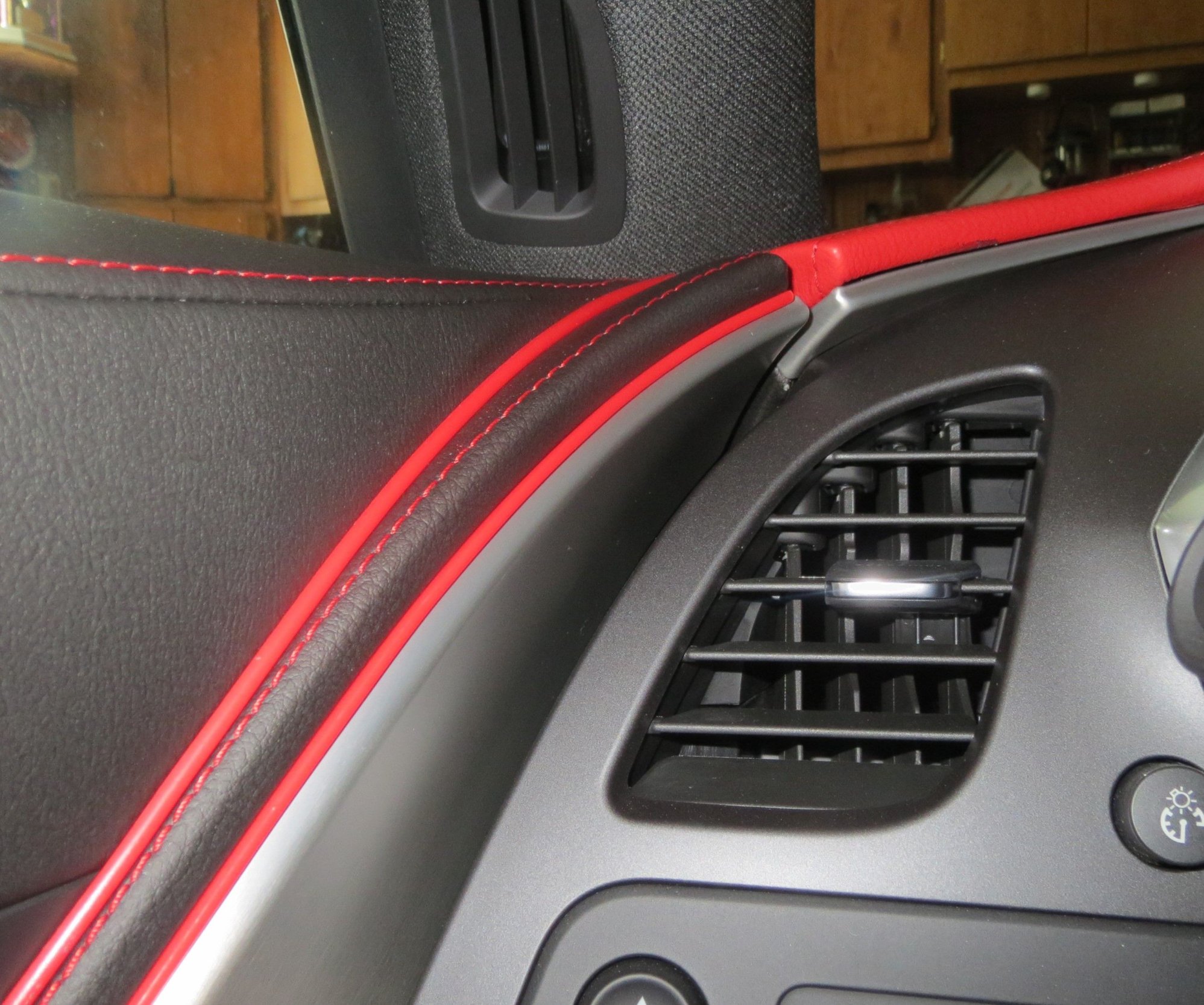

Great job! You answered the question I raised on my 2.5LT PDF! As you note, one pic in a Thread said it could be removed without removing the door panel! However the company who would recover in any color (for a high price) did not know as they only recover! Another post said it had to be removed!
Just updated my PDF and used your Forum name and pic as the person who documented the "must remove the door panel" question!
I took the easy, cheap way out and happy with the <$10 solution and also added a line of red on the drivers door. See pics. You did it the right way! That is how the 2018 and 2019 2LT's are coming from GM! They copied your idea!
My solution was to add these inexpensive matching red trim strips on both sides of the black spear. Not as good as your red spear but easy and cheap!
Added one to the passenger side as well.
