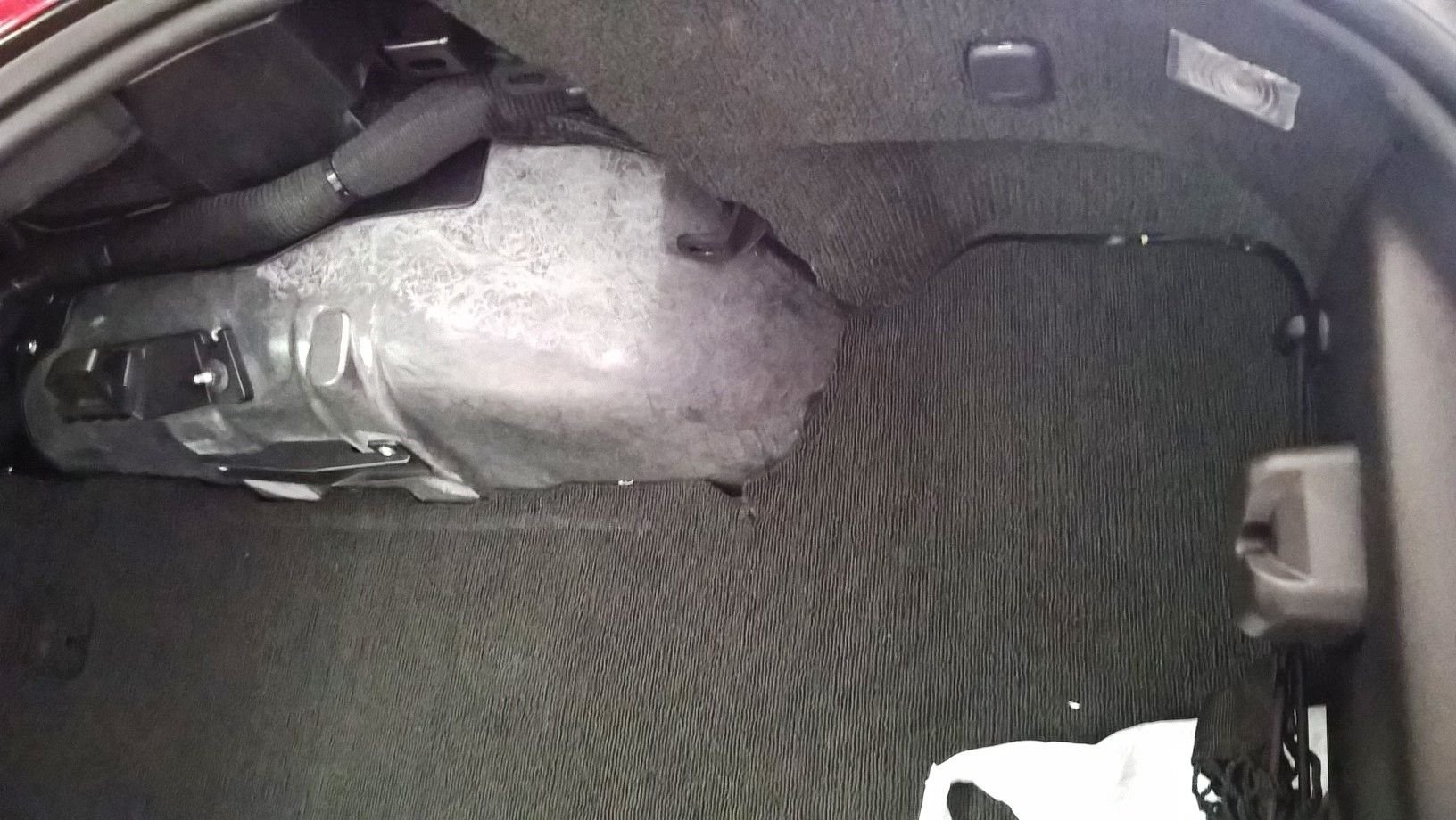

If you do find someone who will change it, good chance they will rip the carpet getting access! There were posts where a dealer tech ripped it! Not easy to avoid as the unbound carpet is a tight fit, especially under the right plastic wheel well cover! In my PDF (link in post#5) I show a way to unclip that cover to reduce the chance of ripping the carpet. That is NOT in the Owner's or the Service Manual! If you call AAA to jump start a dead battery for sure that tech will rip the carpet getting to the battery!

Good pic of unbound edge under wheel well cover!
