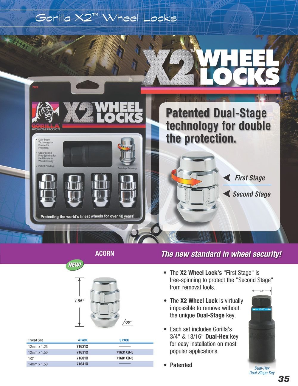

Not a standard item although some dealers provide them free especially if you ask during negotiations.
Of all the locks I've seen out there, these new X2 locks look that they will thwart thieves that use the most common tool to remove wheel locks. That being a hammer and a slightly smaller socket that is hammered onto wheel lock and removed with a breaker bar. If they try that on these it will not work because the end of the lock that the socket is hammered onto will simply rotate and will not remove the lock. Part # 71631X
Because the will be very hard to remove without the key, I'd suggest the first thing you do is buy a spare key.
