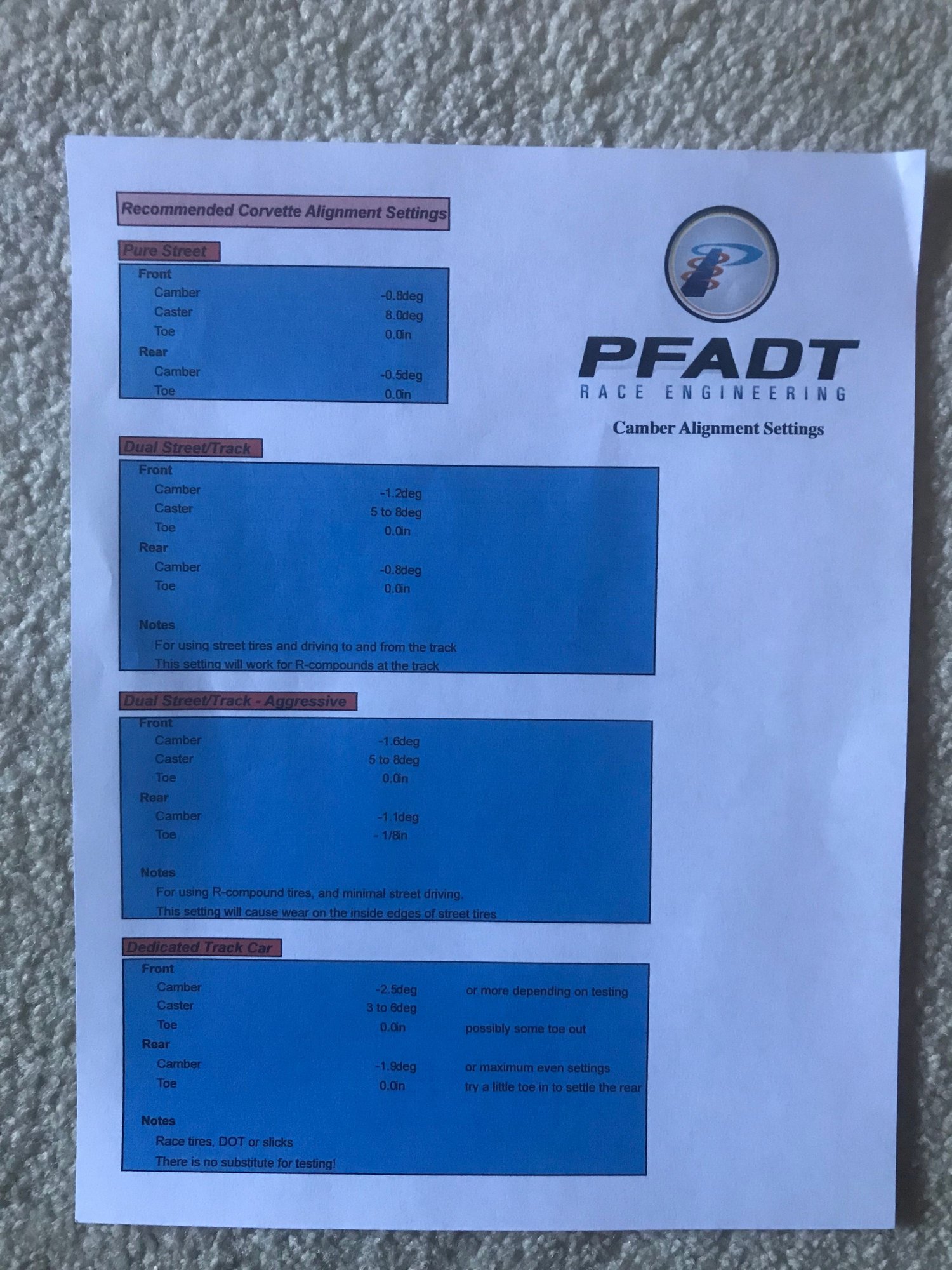

Sorry to start another thread on this but I can't wade through a bazillion posts looking for it. What are the most current DSC alignment specs for street/occasional track use?

Are these good pure street driving specs and are they current? Thank You

Sorry, just saw this. PDF of latest DSC specs attached below:
