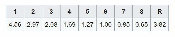

Perhaps you're now noticing something that has been happening all along. The A8 does shift through the gears fast and frequent, especially if your driving moderately. The engine sounds like its lugging, the tach rarely goes above 1500. All for gas mileage.
Let me share what little I think I know. If you're used to a manual transmission like used in the Corvette you may not know what's different in the A8. M7s and the like reach the 1 to 1 ration at 4th gear. The A8 has 6 gears in that same range, it reaches 1 to 1 in sixth gear. This means more shifts to reach 60 mph compared to the manual, both being driven alike of course. 1st gear is also a lower gear ratio so a faster launch should be possible, even though final drive ratio at the differential is slightly higher with the A8. This also means that with correct application of shifts the engine is always closer to maximum efficiency or power, depending on needs. The other 2 gears are overdrive, of course, and the computers shift into 8th at about 60 mph, if memory serves. That's a lot of shifting.
Here's a chart of the A8 I found on the internet, so you know its gotta be correct.
Here's the M7 chart, just for comparison.
Both charts are for 2014 and '15 models. Later models may be slightly different.

Originally Posted by Frodo
Perhaps you're now noticing something that has been happening all along. f
Your probably right.I was gonna remove range on my next time out.Haven't had a next time yet.
Thanks for the excellent post
