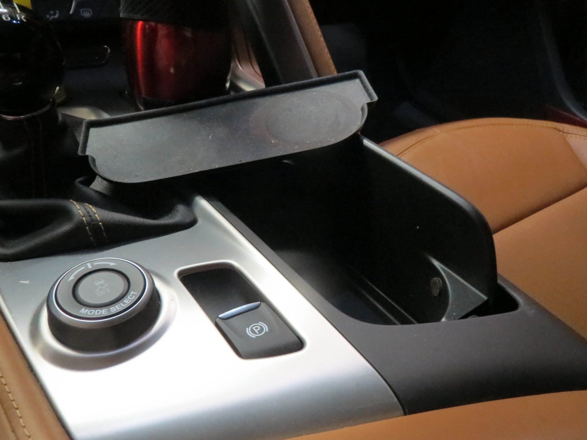

Is there a way to keep the useless cup holder divider in place on the C7 ? the thing is flipping useless.

Yep! Easy to do. Did it soon after I got my 2014 Z51 in October 2013 because a full water bottle spilled on a very hard stop! That insert tilts.
Developed easier method I also have in my Grand Sport. It holds in a 1+ "g" turn and 1++ "g" stop.
This is a PDF of how: http://netwelding.com/Improved_cup_Holder.pdf
Here are a few pics for those who don't want to download the PDF. However the PDF also covers what I tried that did not work!

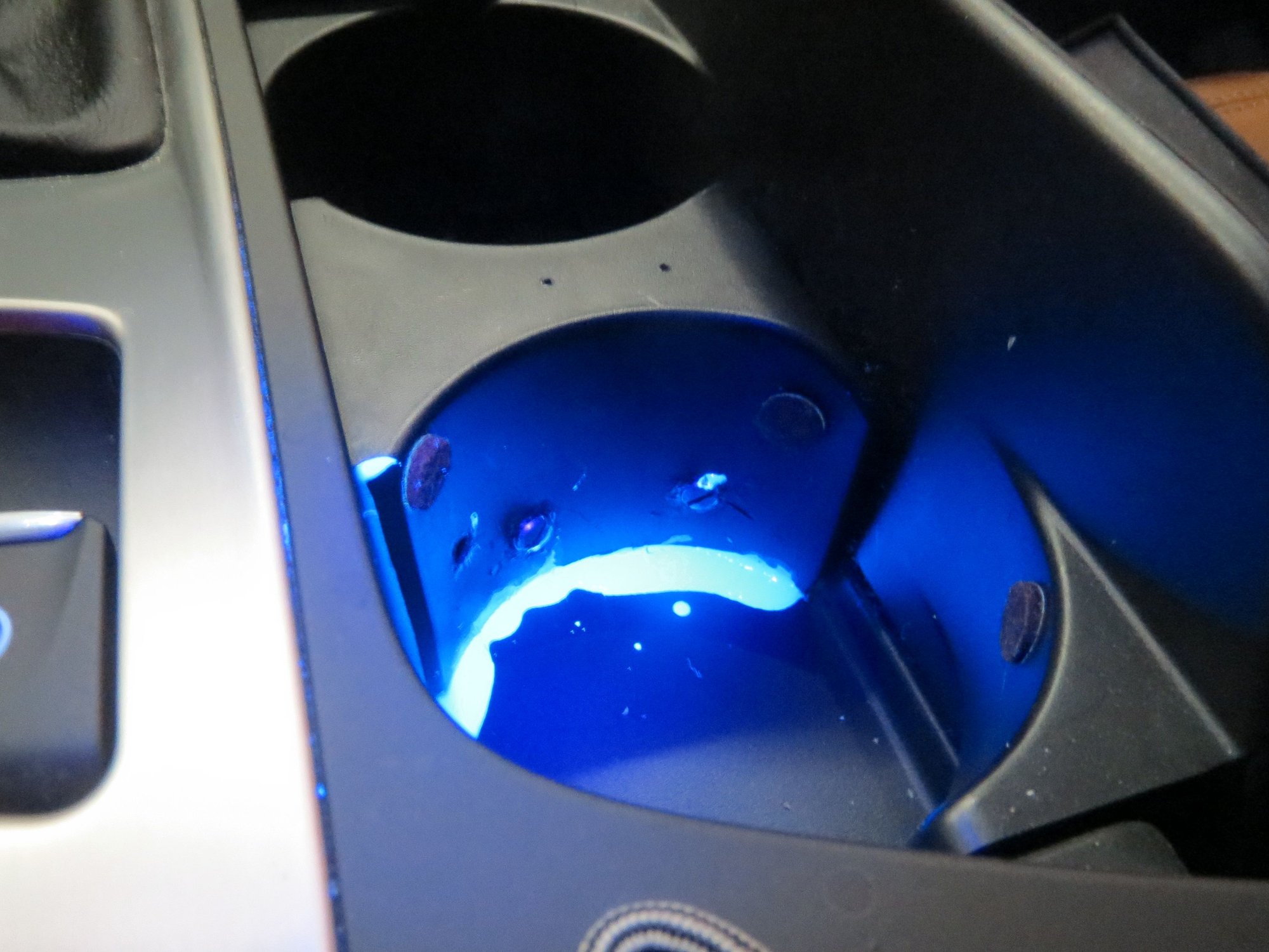

First, pull out the rubber on the floor. Gives you 3/32 more depth and a surface to glue the insert
Then use UV Activated adhesive. Great stuff.
Take your time and put in a fillet of adhesive on both sides of the insert. Nothing happens until you activate with the light

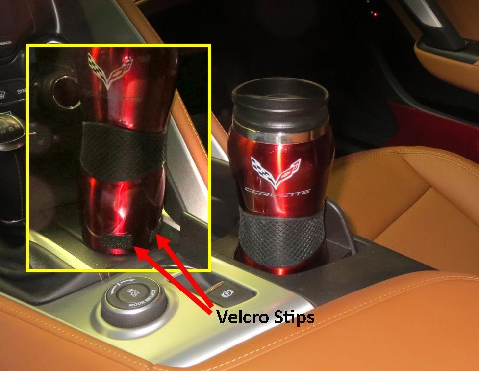

I use this C7 logo stainless thermos and make it snug with felt. I used the soft side on Velcro because I had it. It does NOT attached to the mating side just acts like the felt pads. It's just snug enough but bottle comes out easy. The thermos can keep things hot or cold, amazing how it knows which to do! I only have water in the Vette and always start with it full.

It is. Suggest making three small fillets (being a welding guy) as one large one does not harden as well. As I said it is easy to do as nothing happens until you turn on the UV light. Leave it on about a minute.
Put the first one at the apex filling any gap. Harden it.
Then put another bead of adhesive at the outside base of that previously deposited and hardened bead.
Than after activating and hardening it, another on top of those two and against the vertical insert.

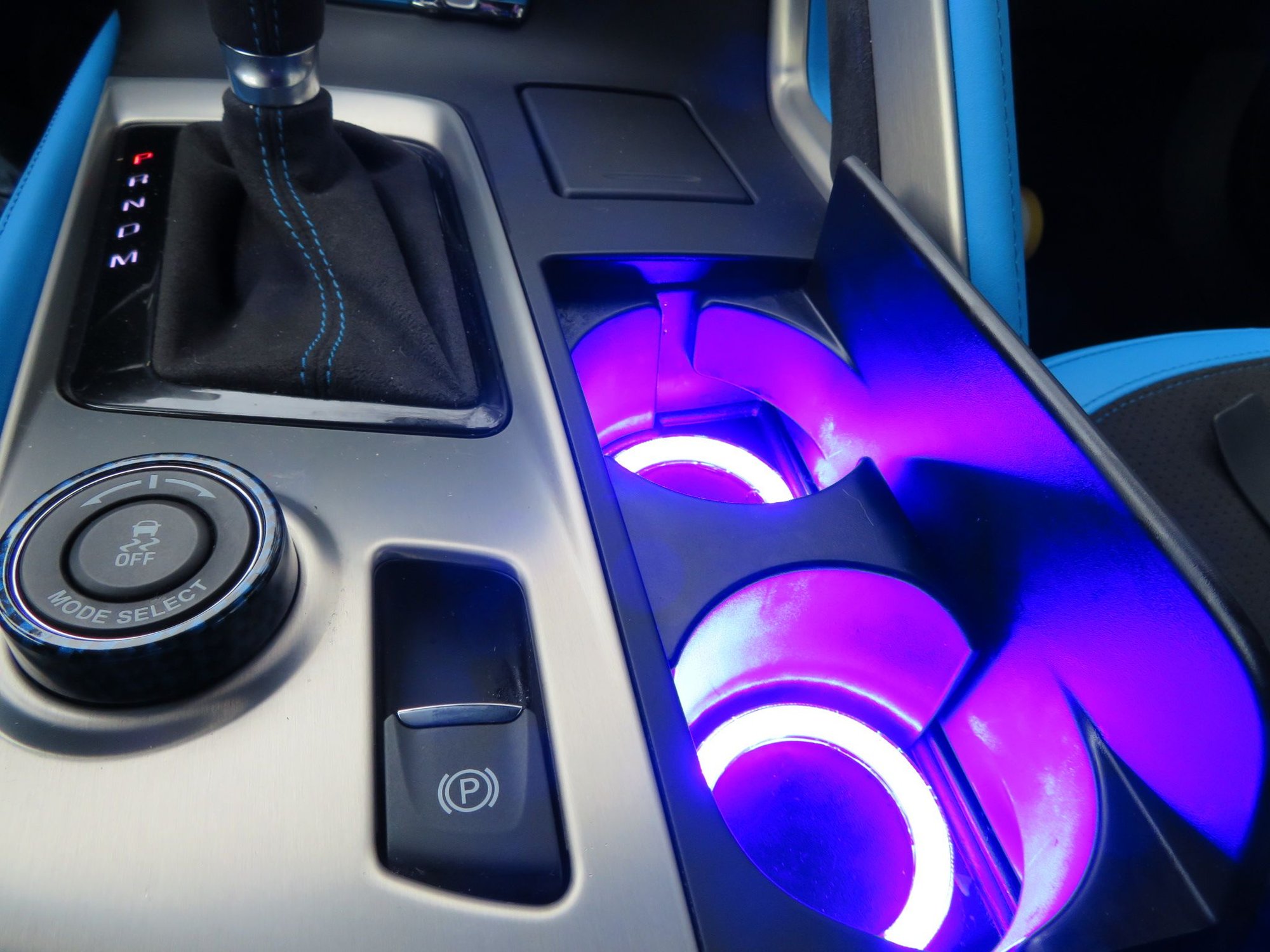

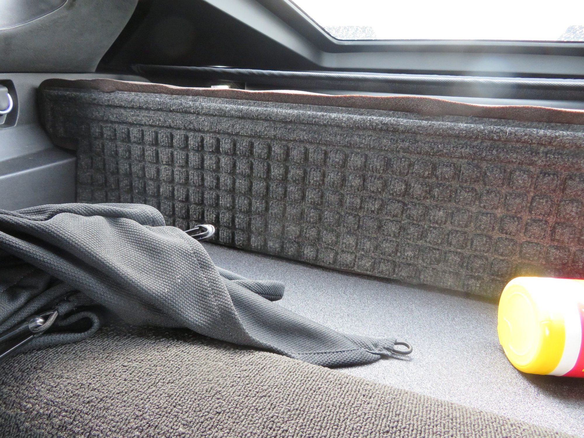

I like to see my drinks spill, so I put in lights to see better day or night. I haven't found a better one for the c cockpits, so I'm molding one out of a 5" T hick piece of Grey Foam (You should get at a Hobby shop like place)
add a could pieces of velcro Corvettmods $ 34.95 1/2 hour Useless cup holder , not deep enough for me
my foam & Velcro cup holder for 2 " />My trunk divider/sound barrier leaves 12-15" for
and stick behind the seats. Got a pix of the lights and a pix of my homemade divider/sound barrier that will leave me space between the home made "Wall" and the "Hump" behind the seats.
