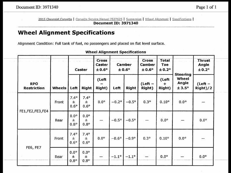

Here are the GM alignment specs for the C7:
Notice the adjustment range. It can actually go further than that since the track alignment takes camber out to -2.0 I have -2.3 on my Z06 for the track season. You can get pretty good tire mileage with the -0.2 left front camber and -0.5 right front camber.
All it takes is moving some cams on the lower control arms and adding removing shims from behind the upper control arms. A real advantage of having a double wishbone race car suspension. Much better than a McPherson Strut Suspension that exists because it is low cost.
