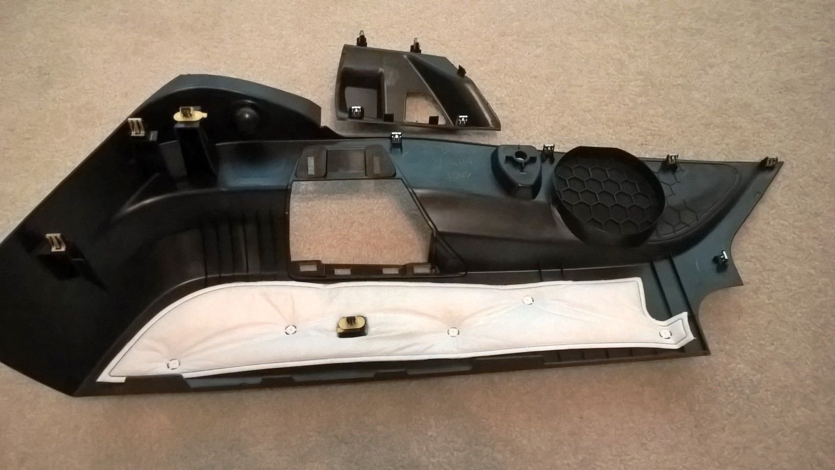

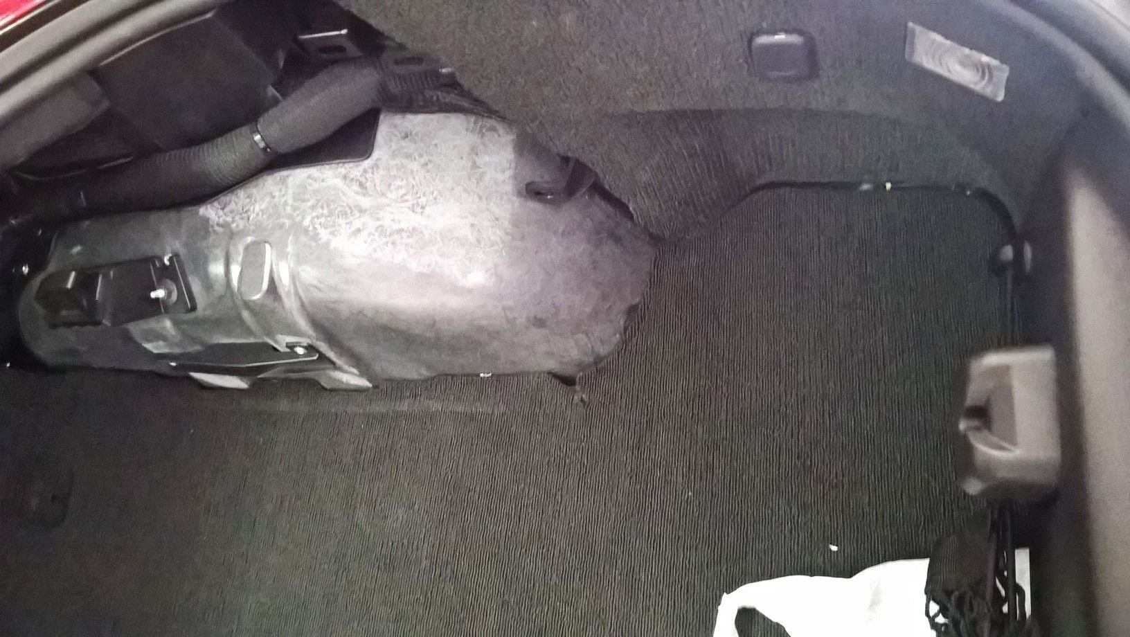

Unfortunately, there are several pitfalls in getting a new battery installed, including ripping the carpet if you are not careful..You need to look up instructions from Jerry U. It pays to remove trim and take your time. I removed the whole side panel to be able to fold the carpet completely out of the way...be sure to remove the vent tube or it will hang up when you try to pull the battery out. I also removed all wires from box on top of the battery so I could get it out of the way instead of just folding it back...the more you can get out of the way, the easier it is to get the battery in and out...

There were still posts where that happened when I changed my battery 1 1/2 ago! But soon after I got my September 2013 built C7 Z51 I had to access the rear fuse panel that is to the left on the battery (as a source of power for my radar detector.) Saw it was easy to tear the corner of the unbound carpet that is under the passenger plastic wheel well! Can guarantee if you were to call AAA to jump start the car they would rip it!

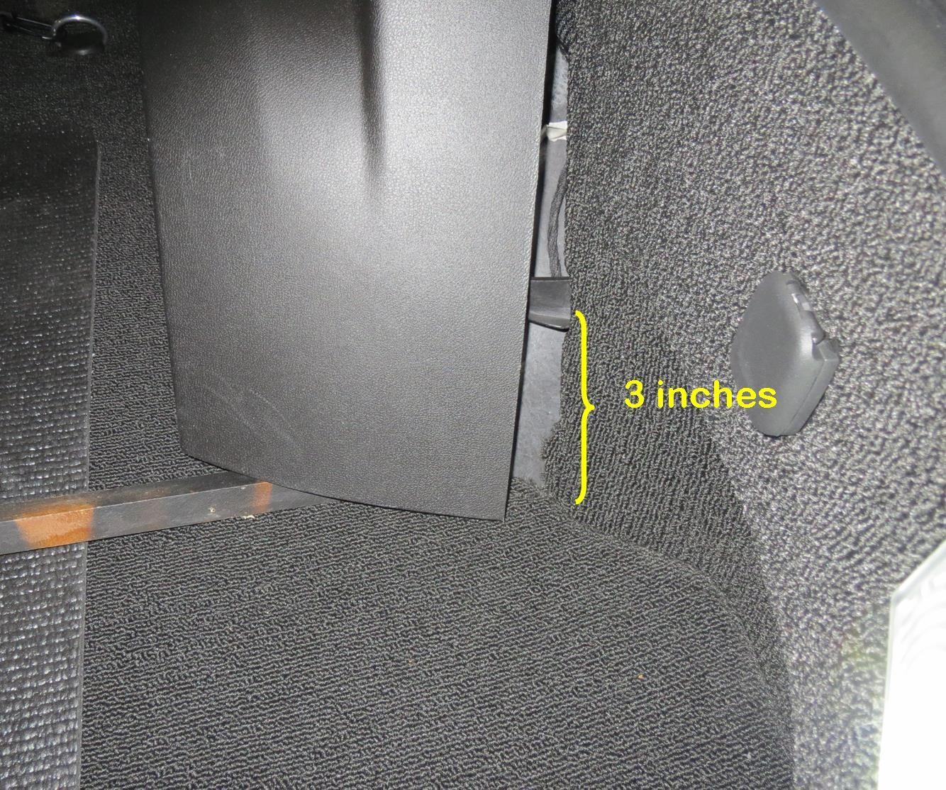

My PDF shows an easy way to avoid. In fact since you may have to access the battery at some time, why not use this trick (pic below) and at least pull the carpet out yourself if you don't want to change it yourself. This suggestion is NOT in the Owner's or the 4 volume Service Manual.
See pic, your car your choice!
You can see the unbound carpet under the plastic wheel well cover. You must pull it out from under. The carpet back is stiff (cheap) and will tear! Best to remove the clip that is ~3 inches from the floor. It is NOT like the very strong clips used to hold most trim. You can unclip with your fingers or a screw driver. If you have plastic trim tools fine but it's not really needed. I only disconnect the lower rear clip and do not remove the more difficult other upper fasteners, which TEXHAWKO shows in his post. You can see the unbound carpet even better in his pic. You can see from the wood molding I used to take the pic, it will provide room. Just hold it out with one hand as you pull the carpet out with the other. It goes back with the closed side of your hand.

The carpet rips so easily, I have even thought about cutting the corner of the carpet out with a clean cut where I can just remove it, and not even mess with trying to keep it folded back.. I may still do that. I could hold it in place with velcro or something.
