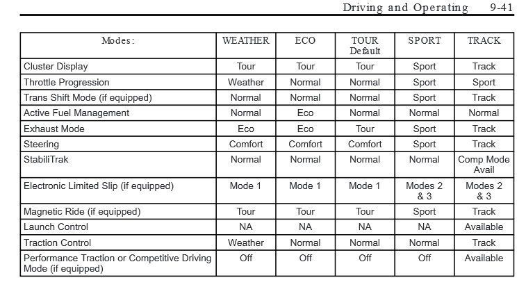

I printed the chart for future reference. Thanx.

The steering settings are overridden when in Track/PTM modes for MSRC-equipped cars as specified in the following chart:

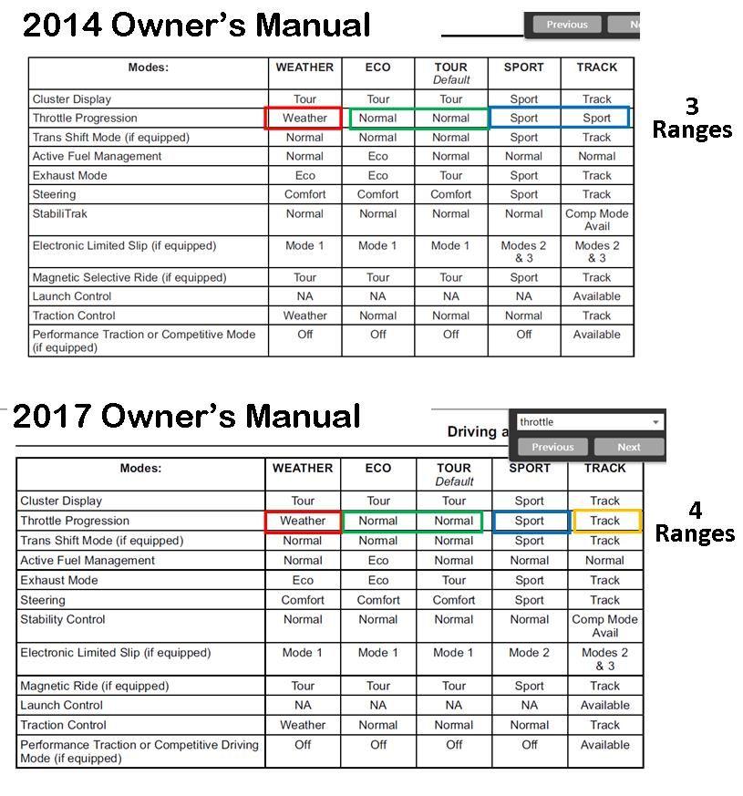

Nothing you can do with the throttle. It is what it is. (linked to drive mode) I hated it everywhere, and installed a Vitesse throttle controller. problem solved.
In fact I was used to driving my none MRC control in 2014 Z51 in Sport Mode and had max throttle response. That is what I was used to for 3 1/2 years. In my Grand Sport max throttle response requires setting at Track! That rattled my teeth so was driving in Touring (now with my MRC software upgrade that is changing.) That was sluggish IMO and not acceptable as I was used to a faster response.
I also added a Vitesse throttle controller! Solved the issue. I have it set at 4 or 5 and that, IMO, is about the same as my 2014 none MRC set at Sport.
Below are some graphs to so the approximate issue.
Note in 2014 Sport = Track. For my 2017 Track is more aggressive than Sport that is more aggressive than Touring.
Note, 4/5 setting is linear, which is what matches my 2014 Z51 set at Sport=Track mode. A 9 setting I refer to as "Boy Racer!" IMO too sensitive. Note all settings at 100% pedal are 100% throttle body opening. It does not give extra power but at 9 feels like it!
