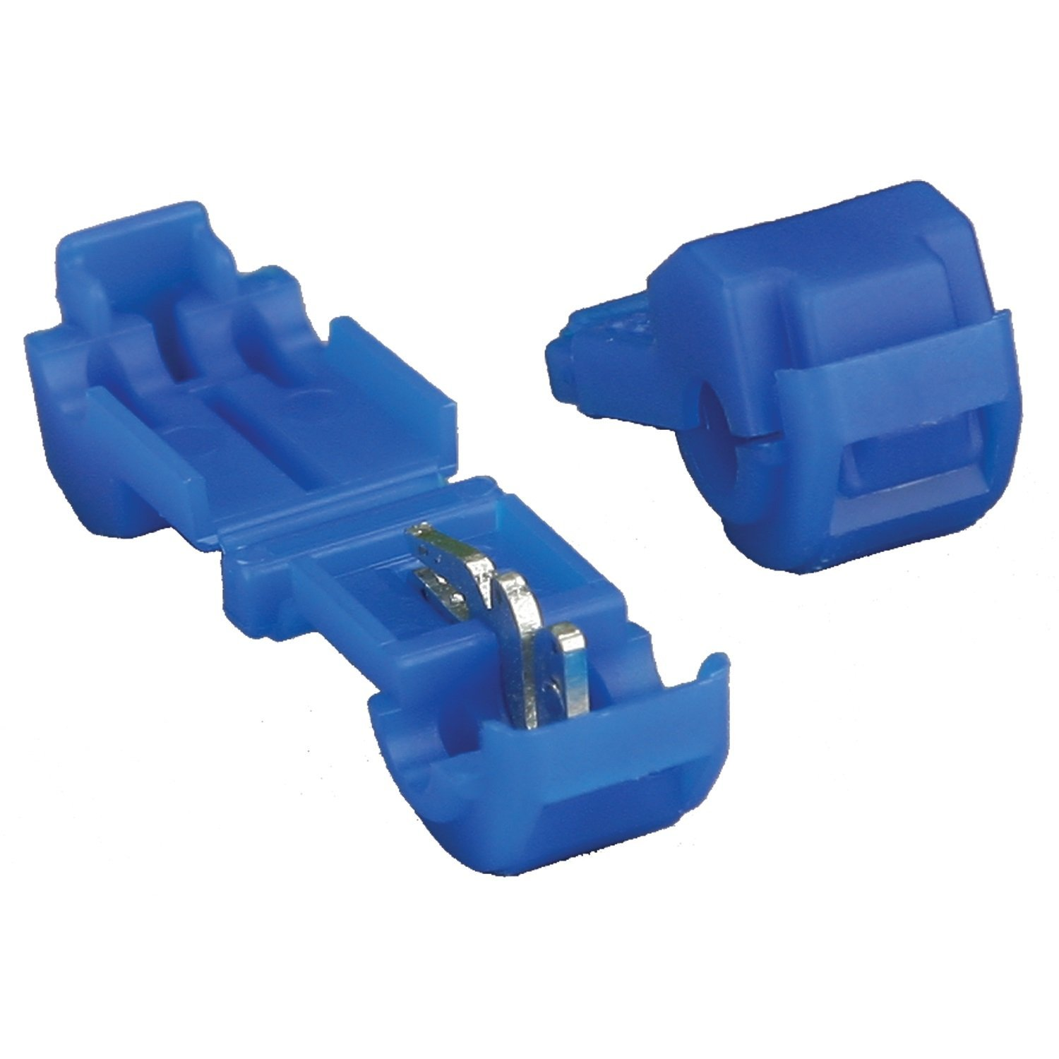

Originally Posted by Dave80C3
Actually its very simple, and easy. The big tricks are selecting the right size tap out of the kit, and getting it inserted far enough. A small set of needed nose to push the tap all the way in is a huge help. Less then 30 minutes to tap the mirror for power, and to install and mount the detector on it.
That is key, getting the tap to seat all the way.
I found if if you push the tap in on the cent side of the plug cavity it goes in easier and deeper.
What do mean by “cent” side?
Center side. there are two rows of wires, tap the wire on the side to the center.

From: Lansing MI
I cant think of a worse way to complete an electrical circuit than back probing a connector.
I can. But then I'm a nut who likes to solder everything too!
I wish these were reliable though, I need them so often but never use taps.
Lol …. I stand corrected; that style connector is in fact worse. Much worse actually …
Yep, bought those for my C6 and have a bunch! Also like to solder!
However the C7 does not lend itself to either. Not much room! I used Blendmount wire and a dentil pick tool to enlarge the space before using a pair of small needle nose pliers to push them in. Worked fine.
