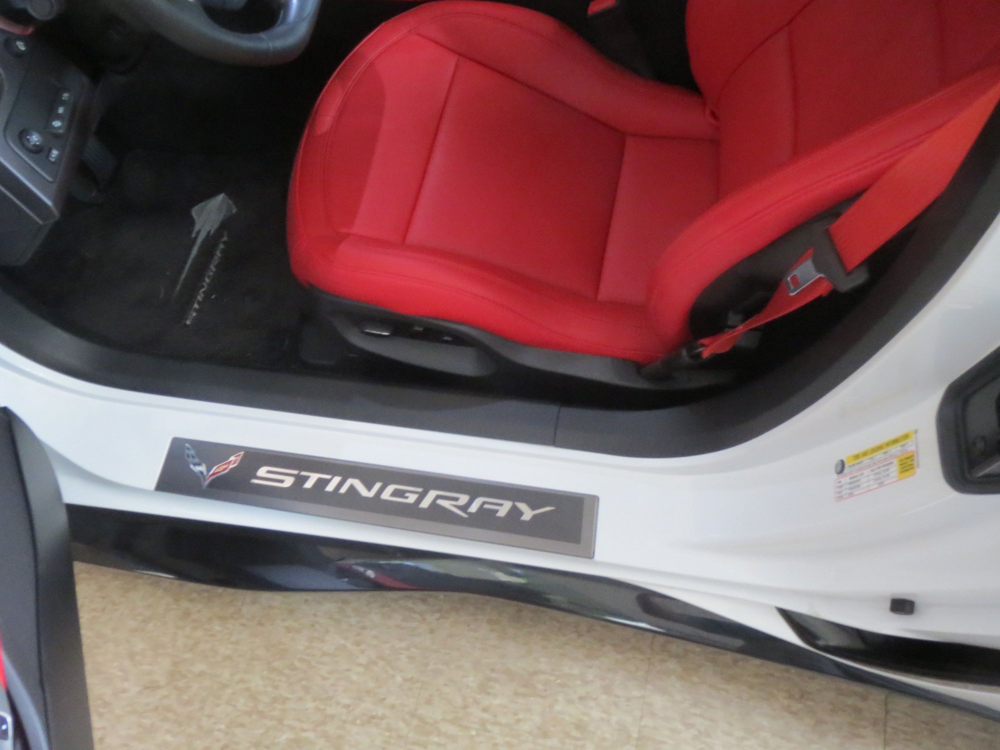

Hi Guys,
Newb question. The 2014 C7 Im looking at has some scratches in the logo'ed door sills.
Questions:
1) Can that be buffed out? It looks like shoe scuffs - typical getting in and out type scuffs.
2) If not - how hard are they to remove and replace with new ones? I searched, but didnt find any instructions in the sticky posts or DYI posts.
Thanks!

They literally pop out.
If don't have the plastic pry bar set thing typically used for body work, you can probably just put some masking tape on the end of a flat head screw driver and pop them up. Heck you might be able to do it by hand.

Always good to try polishing it out first, save some money that way, but as mentioned they are easy to swap out. If you do, maybe get some paint protection film put over them to further protect them

When I got my '15 the sills had some scratches on them. I tried to polish them but there is some sort of a clear coat on them. I replaced them with a new set I bought off a fellow forum member. I then covered them in Xpel to protect the new ones.

As posted, the first attempt should be to clean them... Suggest starting with windshield cleaner and a paper towel, then moving up to Goo Gone, paint thinner or naptha (lighter fluid)... That will remove most shoe scuff marks.
If necessary to remove, they are held in with seven push in snap clips and do pop out easily with a flat blade panel removal tool.
Using tape film creates a problem around the raised letters and details, as it is nearly impossible to get it to "snuggle down" adequately near the raised details. I used 3M 90000 Paint Defender Spray Film, which isn't perfect, but does leave a good protective film and can be removed and reapplied.

The sills have clear coat on them. Light scratches can be buffed out with a mild compound, i.e., Meguiar’s Scratch X, as you would buff out scratches on the car finish. I’ve done this several times from shoe scuffs... and as mentioned, they simply pop off if you decide to replace them.

Depending on the nature of the scuffs/dirt, you can try Mr. Clean Magic Eraser. I have had success with those in places you never would have thought it would work...good product. If you get new, or get the originals clean, you can buy clear formed plastic (hard plastic) covers that fit perfectly and can be lifted up/off to clean or show. I have had them for 10 years on our 2008...would do again.

You can get different names, Stingray etc
Here is a PDF may make you feel better replacing:
http://netwelding.com/Sill_Plate.pdf
You'll be happier with new!

Mine developed some scuffs and used a corrective polish and most came out . Cover leading edge with expel clear cover
