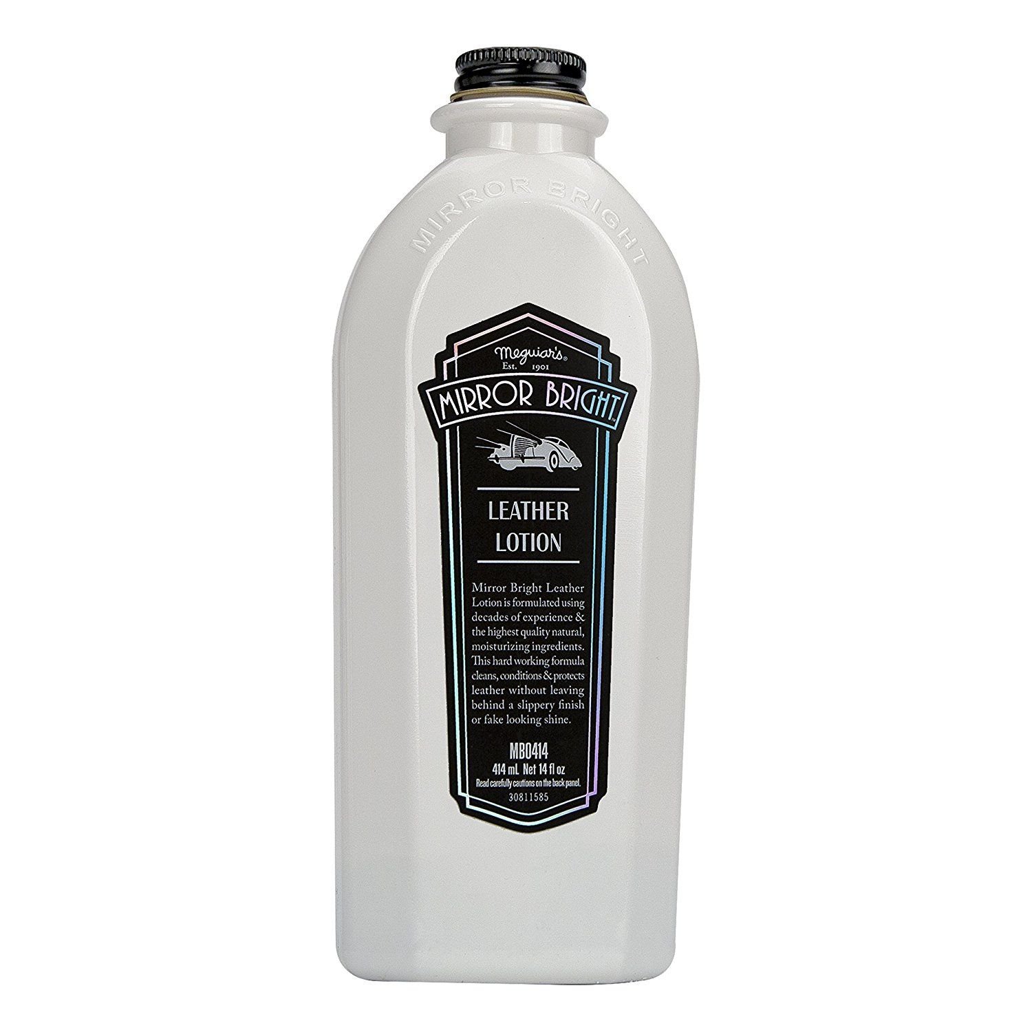

So you guys dont use any "leather" cleaner or conditioner like these:

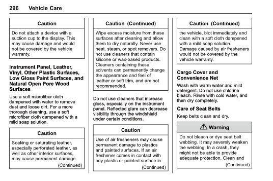

your owner's manual is the alpha-omega of care of your interior.
from the '18 owners manual
learned lessons hard way. I kept a c6 with 2lz pleather in long term garaged storage. For the first 8 years, I just dusted the seats with a damp microfiber. I did remove the chalk from the vinyl/rubber dash and door panels with armour all. In year 9 I thought "why not put leather care products on those beeyoutiful seats!" (mind you in year 9 the seat coverings looked just as good as new, no cracking or discoloration at all.) But i knew better than Chevy, and all these exotic leather cleaner/preservatives must be good. So i "preserved" my seats. Closed car cover, went away for a few months. When I returned those beeyoutiful red/black seats had ugly green mold flowers all over them! luckily, the mold had not etched the seat coverings, yet. So, for my new one, i am religiously following the owner's manual on interior care, and saving some bucks on snake oils too!
