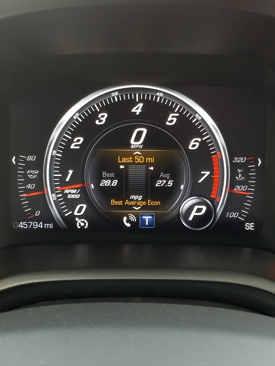

I agree. Wouldn't think oil would give me the boost I've seen in MPG. It's a DD taking the same 30 mile commute to work with spirited driving car has been doing for 4 years. Summer blend gas could be a piece of it although looking at it again yesterday my 1.5 MPG statement is probably actually understated. No monkeying around with my MPG reading. For the doubters out there just accept it or believe that my car is malfunctioning when it's calculating MPG all of a sudden after 45K miles.
As others with the 0W-40 oil have probably noticed it warms up much faster too. This is my 4th Vette and this oil is different when it comes to temps and imo MPG when I look at my facts.
