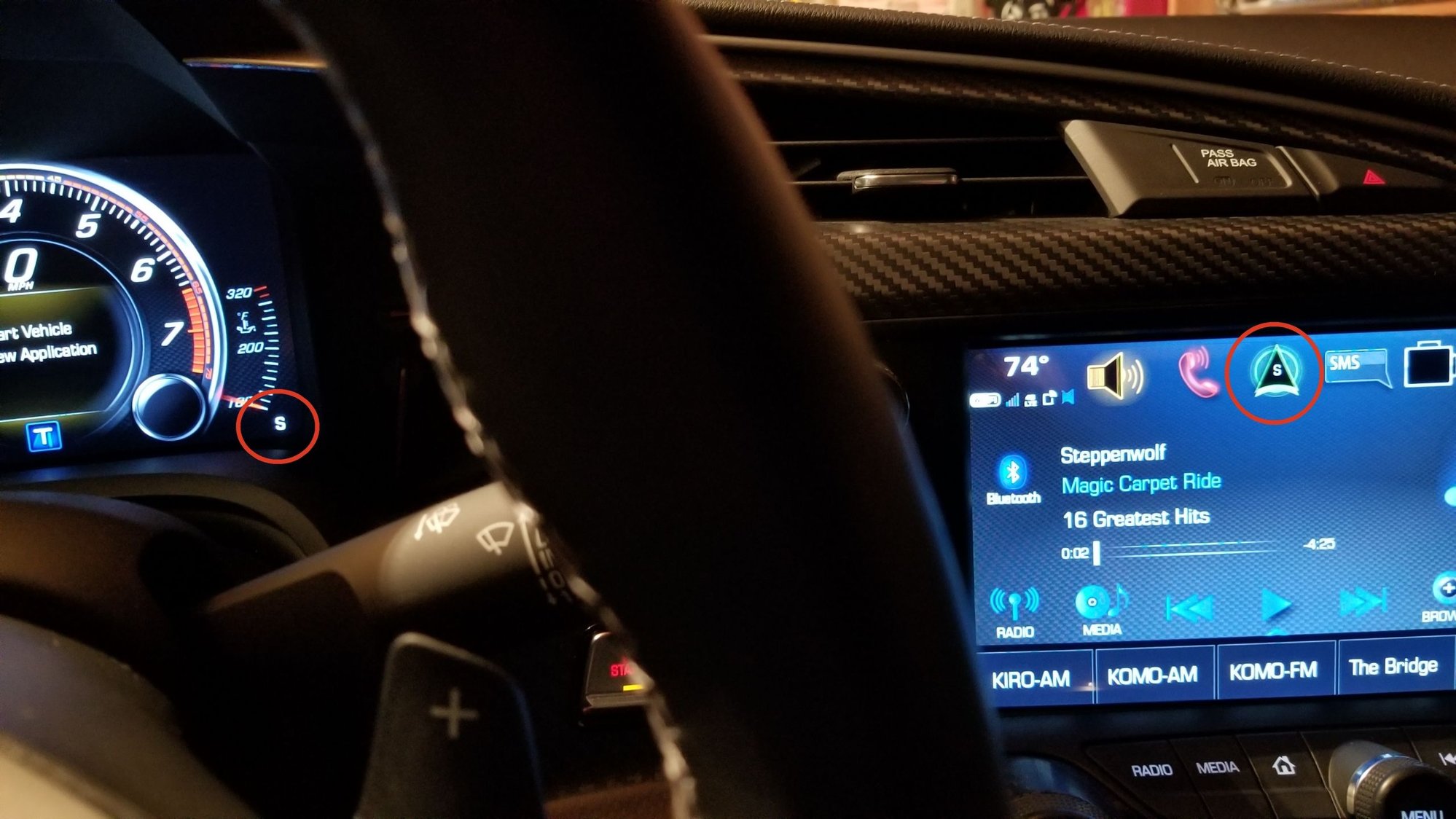

I'm not sure if I pressed some wrong button or virtual button, but I haven't been able to undo this problem. I think this happened when I was pressing some button on the infotainment screen.
The Nav "button" (virtual button) on top of the infotainment screen stopped displaying direction and instead just displays two dashes. There seem to be two modes. The "normal" button, but without the direction display and some kind of button that looks like it came from a Tim Burton movie, also with two dashes instead of the direction.
The GPS still works. The map orients itself properly set to "heading up" view or "north up" view.
Is this some kind of malfunction, or is it simply a setting that needs to be changed?
Here's what I'm seeing:

When I strolled out to the garage this morning to try out the linked suggestion (which I interpret as "try removing the shortcut and then putting it back"), the two dashes were missing from the icon. That was weird because they were there last night. And of course there was still no direction displayed in the icon.So I tried removing the shortcut and putting it back, but the same thing happened: The dashes were still missing and still no direction. I tried it again, this time removing the shortcut, then shutting off the car while I went shopping, then after coming out of the store, putting the shortcut back. This time, the dashes were restored, but still no direction displayed.Any other thoughts on this matter?

Thanks for your replay and thanks for pointing out where the manual talks about the compass. I looked in the infotainment system manual but didn't find anything. I didn't think to look in the owner's manual.
I do not get the GPS Red X problem. (I can demonstrate it in my garage, of course, where there is no GPS signal.) But the GPS Red X goes away as soon as I pull out of my garage. Additionally, the GPS is clearly working as demonstrated when using the map. The map clearly orients itself as instructed, either heading up or north up and continues to maintain either orientation correctly when driving.

I tried disconnecting the battery for about 10 minutes, then reconnecting it. Re-indexed the windows, thanks for the reminder.|It still only has the dashes in the nav icon, and the GPS still works just fine otherwise. The map knows my location and it orients itself appropriately according the north up or heading up.|Any other suggestions are welcome.

I don't recall ever seeing compass direction on the instrument cluster. It is definitely not displayed there now.

This system worked perfectly, including displaying direction on the shortcut, until a few days ago. I do not get a GPS error message except when the car is in the garage. Once it is under the sky, the GPS Red X goes away. The GPS seems to work fine when it comes to being able to pinpoint the car's position on the map, and when it comes to orienting the map north up or heading up, whichever is selected.I have put about 30 miles on the car since removing and replacing the shortcut icon earlier today.Still no joy. The icon no longer shows direction.Thank you all for your suggestions.I'll call GM customer service in the morning and will report back as any information or resolution develops.
