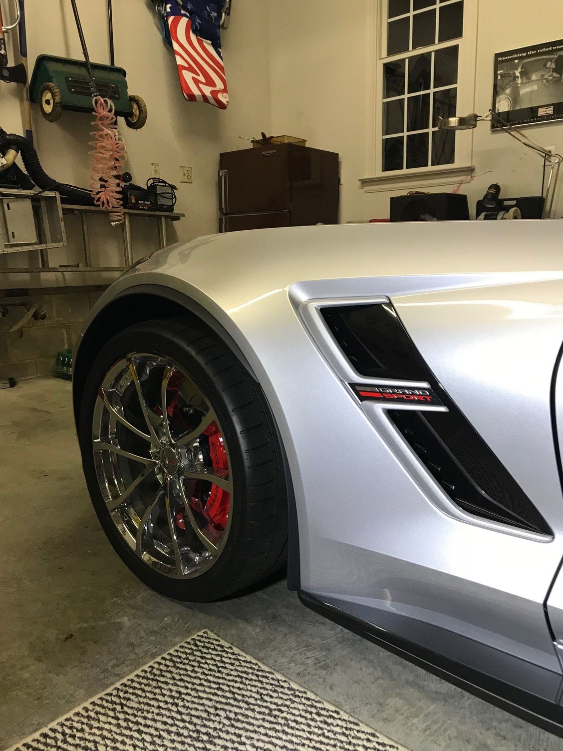

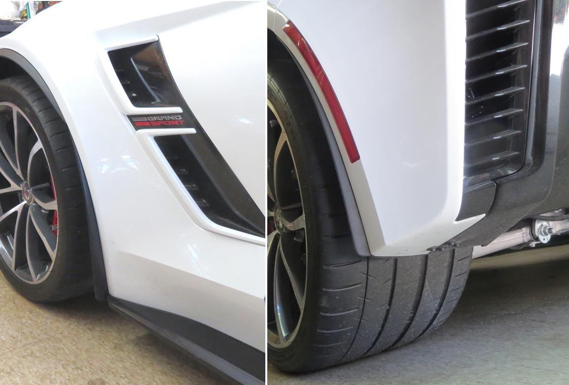

Likes: 2,609
From: Gettysburg PA
2020 C8 of the Year Finalist - Unmodified
A lot of us here made a "homemade" extended front splash guard. You can search several different threads on this forum which will give you specifics. We used off the shelf generic splash guards you can buy at any auto store and modified them to cut them to shape, and attach to the existing front GM black plastic pieces using 5 small screws.
On our Grand Sport, the tires stick out 2.25" wider than the body, so I made mine 2.25" cut and tapered them to fit and they stick down about an inch and a half lower than the stock pieces.
Works great. NO debris down the side of the car, NO sand blasting. I also use full length side skirts.
Here's one such very useful thread..... There are several good threads out there. https://www.corvetteforum.com/forums...that-work.html
