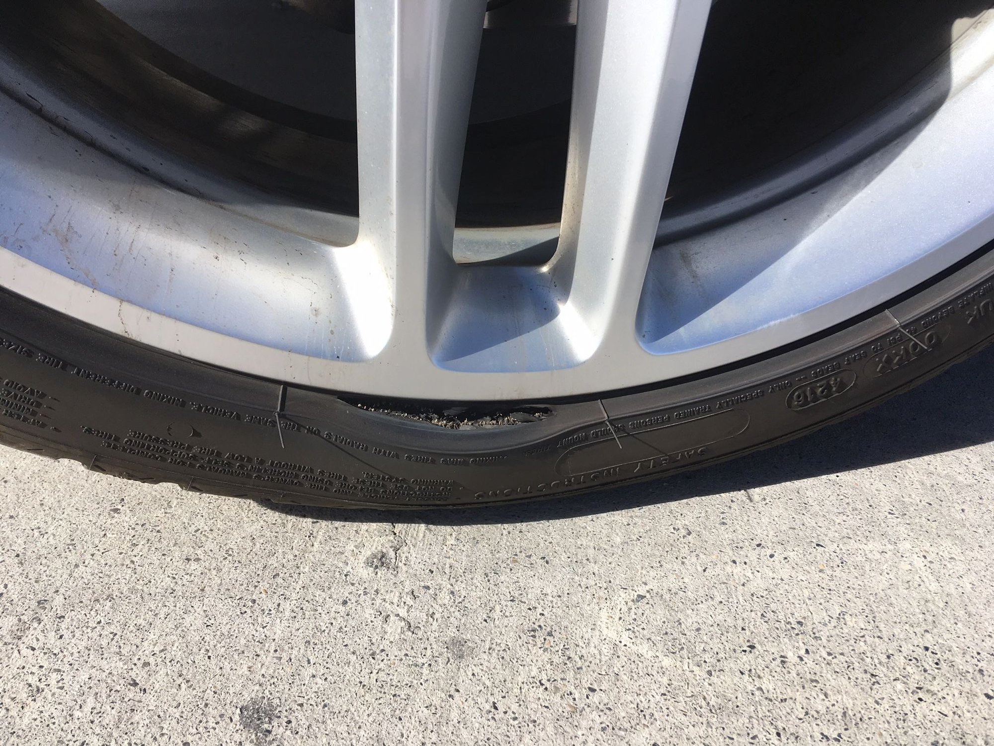

Not a GS, but a 2017 Z51. Not sure which side of the argument this supports:
We had one wheel bent from hitting an exposed manhole while the road was being resurfaced. No damage to the tire or the edges of the wheel, the slight bend was detected during a re-balancing. Possibly came from the factory that way, though I doubt it. Straightened by the aftermarket wheel insurance company, they said the bend was not enough to require replacement, I didn't like it but no choice, our local Corvette Tech told me he was comfortable with it in this particular case.
We had another instance where we hit some unknown pothole or whatever, it ruined the tire but did not damage the wheel. See pic. Tire was still holding air a day or two later!
Location of the impact makes a HUGE difference. The pictured impact is on the outside facing edge near the spokes. That's probably the STRONGEST part of any given rim. I wouldn't be surprised if the bent rim had the impact occur on the INSIDE edge of the rim.
It's simple leverage, really. Corvette C7 FRONT rims are wider than a majority of car's rear rims, on even cars with staggered offset and sporty intentions. The front rim on a GS is 10" wide, which is WIDER than the aftermarket rim that would fit on the rear of my BMW Z4 M Coupe. The end result, combined with a low profile tire AND 19"+ diameter, is impact on the inside rim edge can easily exceed 20% of the leverage a typical rim on a typical car today (18" x 7.5) would experience. At this size, it's impossible NOT to expect more damages from the same typical impact you would see on a daily basis.
It's just facts of life folks, this is something that one will have to live with and deal with to drive on such massive wheels and such low profile tires. There's nothing on the market that even comes remotely close at this price range and volume in terms of wheel size vs. tire profile.

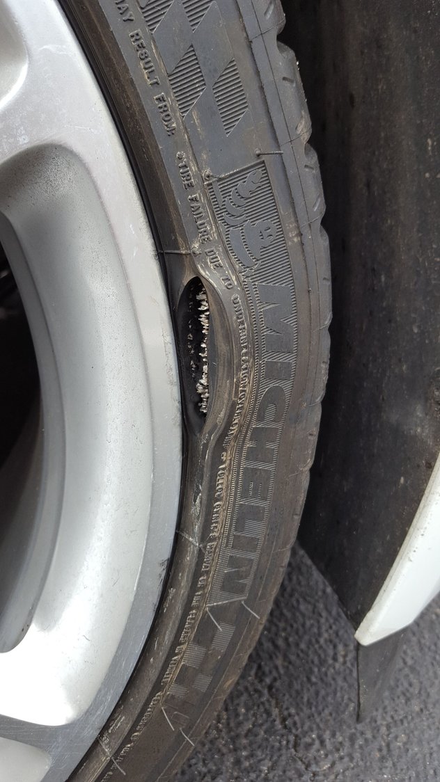

I incurred two damaged tires and bent rims on the passenger side enroute to Florida from St Louis just outside Nashville. A pothole on the highway hidden by rainwater. The tires [Michelin M&S] did not lose air and I actually did not feel any balance problems. Later had the wheels checked and discovered they were bent and had them straightened. Seem OK. Michelin was extremely helpful when replacing the tires, which had less than 1000 miles on them.
mike
Mike-
We should both have kept our damaged tires, and mounted them as a matched pair for off-roading.
As Hack mentioned, my impact was right where the spokes go into the rim, but yours was almost exactly between the spokes. It also looks like your impact was enough that the tire marked the rim at impact location, mine did not.

Default ....here is the other damaged tire...on the spoke
Was VERY careful around Nashville returning home.....terrible roads......
