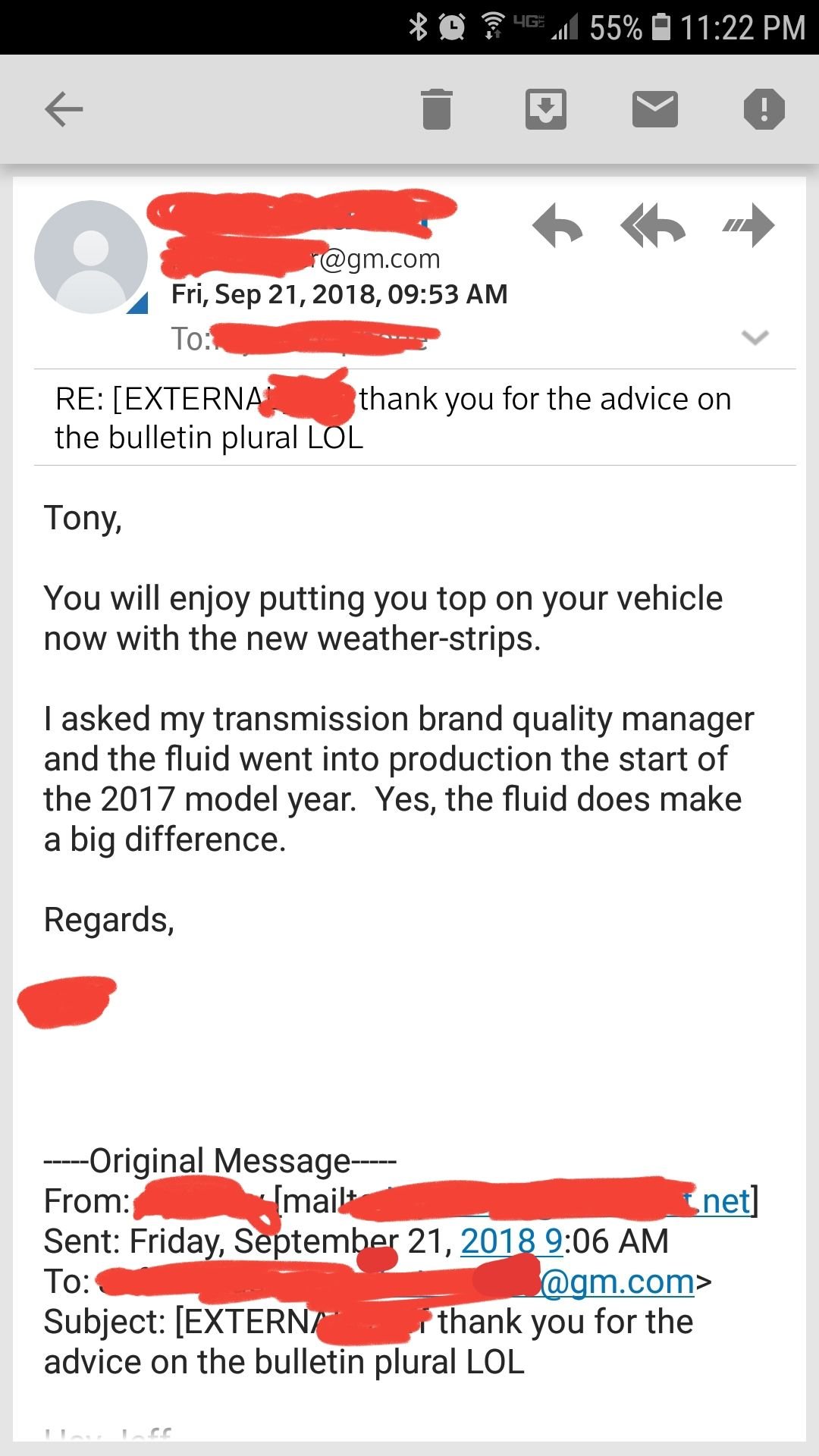

When did they begin using the new formula on the production line......Jimmy
I answered this in a couple other threads but here again.
As much as I know he knows everything 10000 times what I know the TSB itself came out I believe in December 2016. That leads me to believe the fluid didn't hit the line until somewhere around that time frame meanwhile 2017 production was well under way already. So at the earliest it's 2017 production and probably the latest right after the TSB which would mean January February 2017 I my guesstimation
