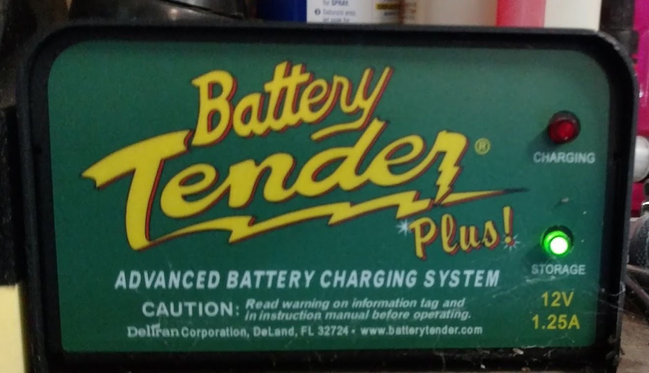

I have 4 years on mine and no problems yet. Use a battery tender all the time and store in heated garage in the winter.
Someone mentioned poor correlation with the key fob.
I had this problem after 3 years and the batteries in both sets of fobs needed to be changed.

Well I bought a battery tender the day I bought the car ( 2014 z-51 in march 2014 ) and had never needed to put the BT in place until about 4 months ago and because the Fob's weren't working very well I also changed the batteries !!! The battery tender was on the car overnight and a few hours more to reach full charge !!! Since then the car starts up fine and the clues to the problem was known to me because C 6 club owners at my Corvette club said that the car is always looking for the fobs and other things known to be battery draining events when the car is not running !!! I previously had a C 5 and That issue never came up no matter what time frame it was from one driving experience to another !!! Wayne

I have used a Deltran Battery Tender for the last 30 years and have had batteries last 9 to 10 years. My 2016 C7 is now 3 years old and i hope to get more than 5 years from the battery !!!!

After taking in all the responses from my thread and since it is near the end of the season here in New England, I will keep the tender on it each time I park it and will replace the battery in the Spring.
