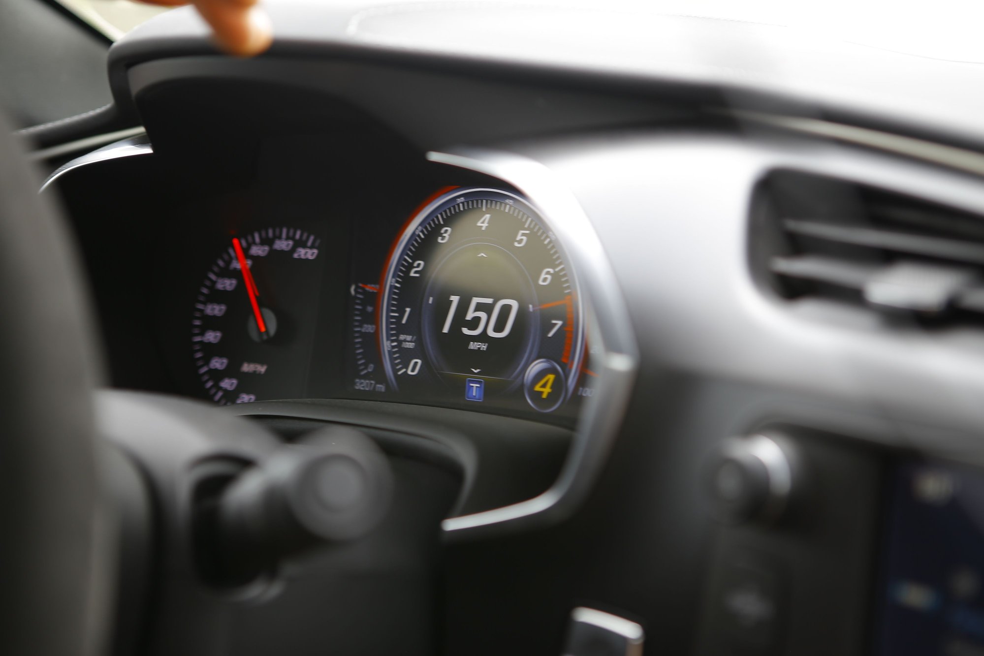

I have a manual and in fourth gear I hit 152 at redline. Car was still accelerating but I backed off because I didn’t want to blow the engine. I still had about 1500 of straight before turn one. I was on a track. So basically what I was asking is that if I kept my foot on the gas a few more seconds to get it up to 155 or 160 is there anything on the car to prevent the engine from blowing up? I heard there was a rev limiter but don’t know if it would help in this situation. Thanks again.

Regardless of gear when it hits 6600 rpm the fuel shuts off, you'll feel it Comes back on quickly when you get below. My math says you were at all you'll get. May feel like it was pulling but you'd never get to 155 without shifting.
Heck I don't track but live in a rural area with no traffic or homes between long straight roads with cotton fields on both sides. I've hit redline a few times in 1st and 2nd and occasionally 3rd! That is a fast as I'll go! You should try in a lower gear so you know what it feels like. Could try to shift to 5th at 152 mph but with the excitement of a turn coming just be sure you're going into 5th NOT 3rd!

You won’t get to 155 unless you have one hell of a tailwind to overcome the aero drag or a longer straight and no way will you see 160. In my C6 GS in 4th gear holding at 6500 was 152mph at Auto Club Speedway. Same gearing as a C7 GS which I have now. The only thing more power affects is how quickly you get to a given speed and rpm.

My GS will hit the rev limiter at 151 mph in 4th gear
