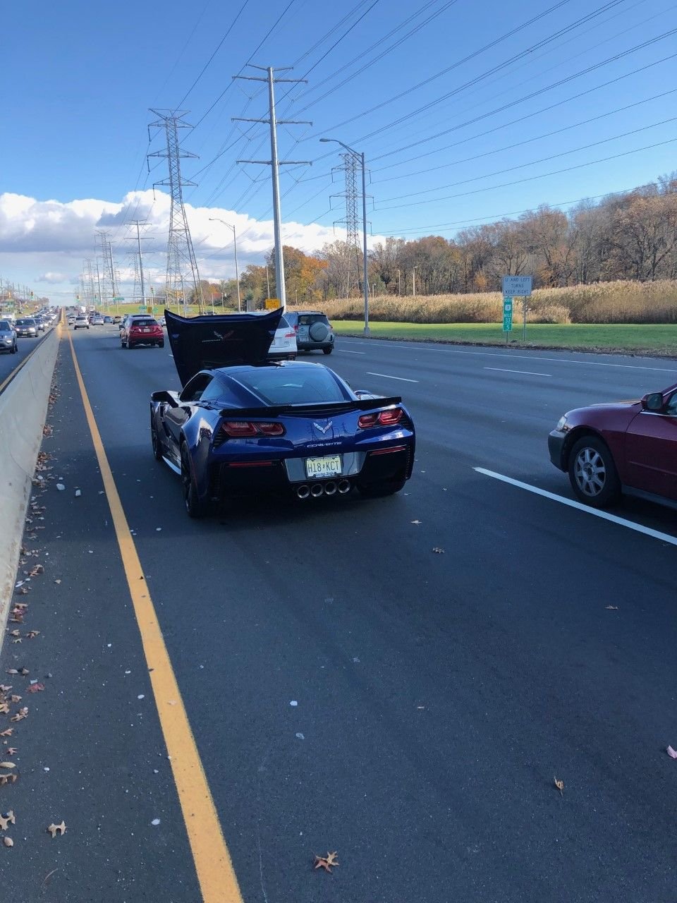

Default 2018 GS needs new engine - update
After getting engine replaced with only 4k miles, I was happy to have the car back!
Again, really love the car...just not sure the car loves me back!
After about 9 days and 300 hundred miles on the new engine, today I was driving and at about 20 mph and the car completely died on me.
No power steering, no brakes...car just completely shut off. When the car came to a stop (on a busy highway), I put in park and tried to start it and it was dead. I mean nothing worked, no lights, no signals, no horn...nothing!
I was in a bad spot, left lane of highway, hazard lights not working (see pic below). Even door would not open (luckily I remembered the manual lever on side of car). Got a tow truck to Chevy dealership and now they are working on it...again.
At this point, I'm not sure I want the car back. Let me be clear, I definitively want another corvette, just not one with a engine that had to be replaced under 4k miles and apparently a car now with electrical issues / other issues.
Going to call GM corporate Monday morning.
Will keep everyone updated.
Regards,
Mark

If it shut off and no power i will bet the problem is a bad ground wire somewhere?

I suspect when the engine was installed a main power feed was pinched or otherwise misrouted and the large fuse at the battery is now open. It could also be a connection at the positive or ground came off but usually if one of these connections is so loose that it can physically jump off from a bump or sustained vibration then the car likely wouldn't have started in the first place given the large voltage drop that occurs across this poor of a connection during the heavy starter current draw.
Hopefully this is a single issue with a simple cure but the dealership, in cooperation with the GM mothership, now needs to step up with some goodwill buying goodies to make up for the additional inconvenience. As an owner, if you aren't mechanically inclined then bring a friend who is to look at the overall workmanship of this when it comes back to you. Poorly routed wires, greasy fingerprints, scratches, etc. would be a big red flag and an indication that there is a high probability of other issues due to careless work.
