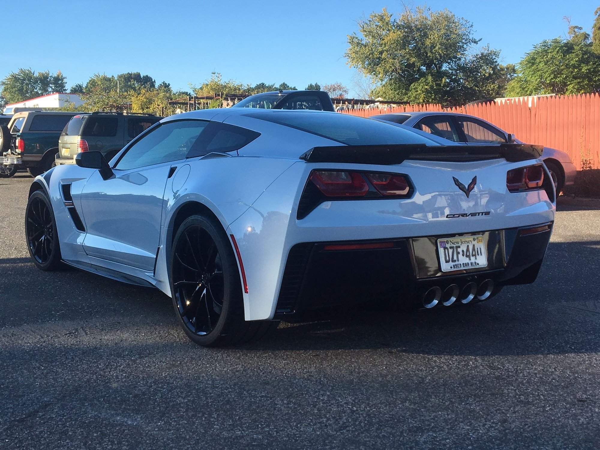

after a 7 week wait I just picked this up. 2019 grand sport in ceramic grey 2lt with grey interior. I have a couple questions:
memory: do I have to hold the button and wait for everything to go to position or is there a setting that lets you just push the button and release?
I didn't order or pay for the carbon flash ground effects package but my rear spoiler and rockers are painted carbon flash, did I get lucky?

The memory seats - you should only have to push and hold when you're setting the features. You can then just push 1 / 2 to get back to those settings. The skirts and spoiler come that way for the GS unless you opt into another package

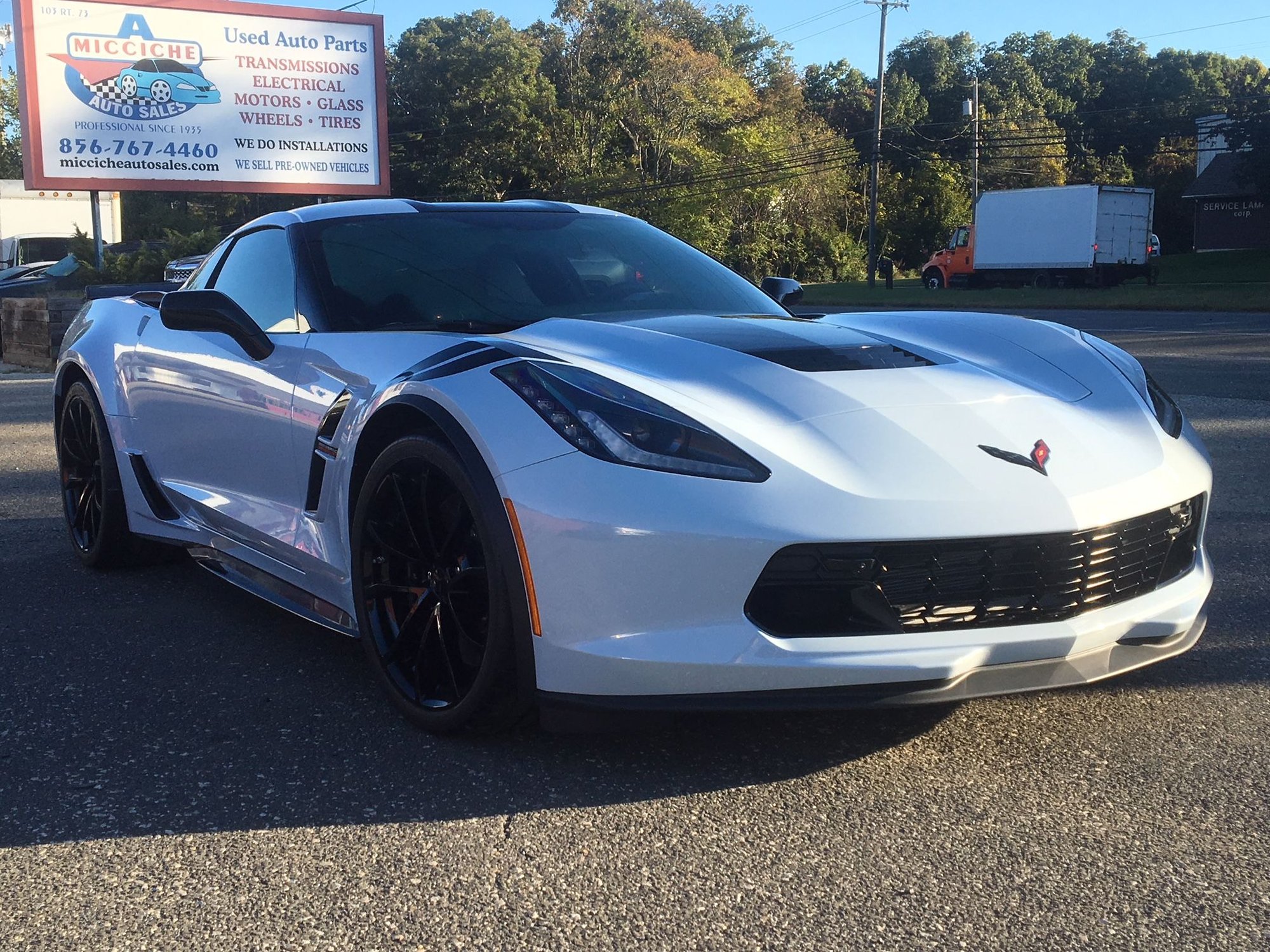

Nice car. Congrats. I remember riding in my parent's car in the early 1960's and passing Micciche on route 73. Was a huge junkyard back then, somewhere between Marlton and Berlin. Saw that sign in your photo and couldn't believe it's still around.
