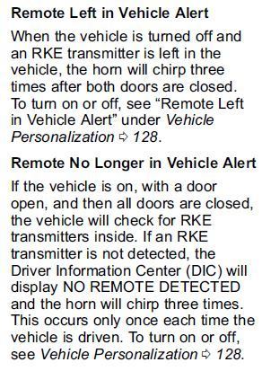

Few more reasons that will chirp the horn three times
^^^This.
Maybe the OP left a FOB in the car after he exited?
