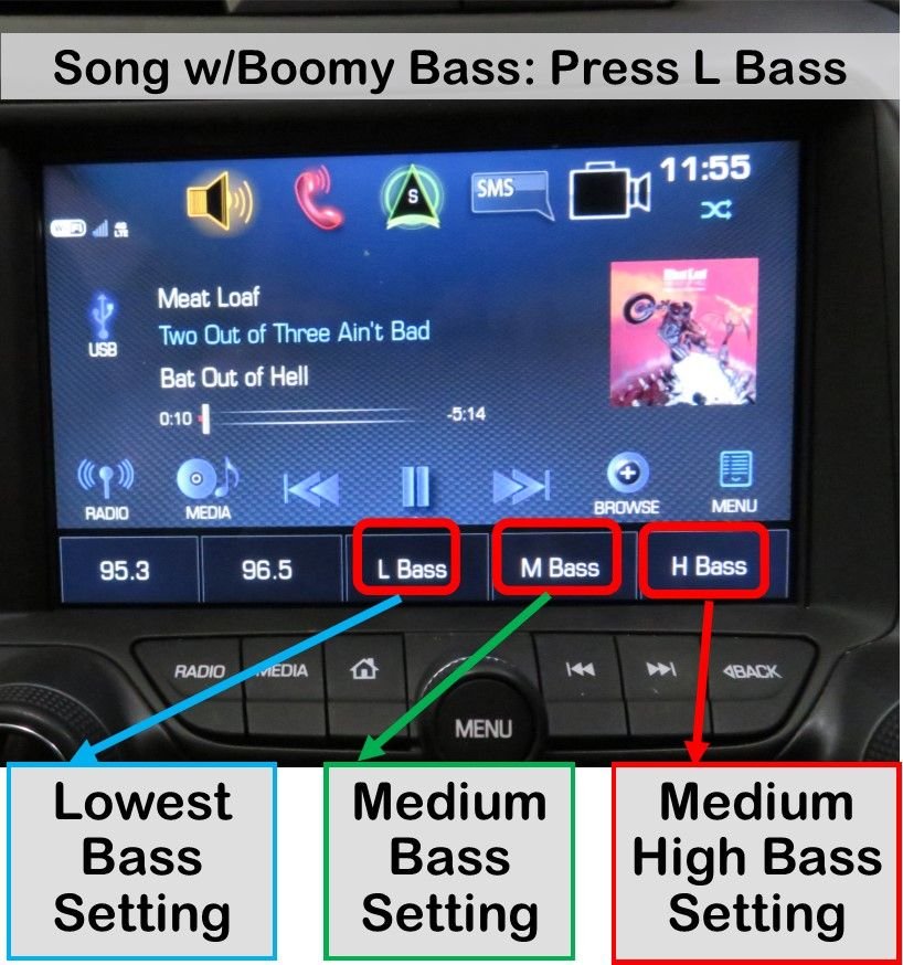

My method of dealing with the C7 Coupe very noisy interior may not be for everyone but works for me. Had an early 2014 Z51 that was the noisiest Vette of 4 I have owned. My current Grand Sport is a bit worse! My solution is simple. I have the sound system always on, playing one of over 1000 songs in shuffle mode from a Thumb Drive as soon as I start the car. It comes on automatically.
Janis Joplin singing "Cry Baby" or a more modern Joss Stone singing "Tear Drops" drowns out the tire and road noise. The issue I had, that is now solved, is some songs, like Joss Stone's "Tear Drops," has a very boomy bass when set at where 90% of my songs were fine. In fact the bass is needed to cover the interior noise. Compared to my C6 Z51 that needed a subwoofer but with Bose hard to add the 2LT, 3LT added subwoofer works great for my purpose!
A poster had a solution similar to the custom subwoofer and amp I added to my S10 pickup that included a remote base volume adjustment I mounted on the console. I could adjust the base to fit certain songs without having to lower the total volume, which for the C7 defeated the noise covering! This is a PDF on how to do what is shown in the pic below: http://netwelding.com/Boomy_Bass.pdf
When a song stars playing that has a boomy bass I just press a lower bass volume preset!
I have 3 presets at different bass volume levels. You can set any balance, volume etc desired and remember it in a preset. As I did you can also label the presets to whatever you like! The PDF has a step by step pic/text as how.
