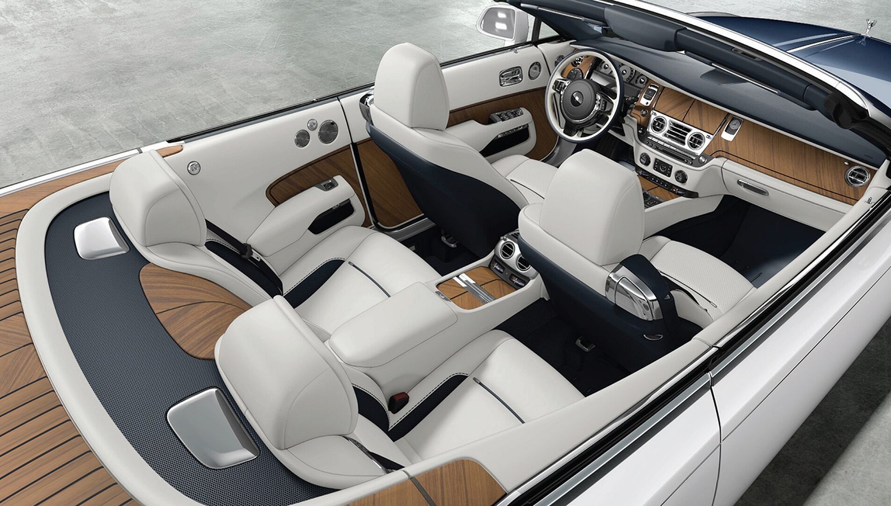

biggest problem is,
not enough material to pull over the edge ,to get a good hold on the back-side,use an extra inch of leather on the backside ,and don't pull so tight on it
you don't see Rolls-Royce/Bentley dashes pulling apart

Originally Posted by dmaxx3500
biggest problem is,
But then if GM used the same materials/process that Rolls-Royce uses for their leather interiors then the 3LT/LZ package would probably be around $40,000 as opposed to the ridiculous $9,800 GM now charges.
Skid Row Joe, is probably the only one who would purchase the 3LT package at $40,000.
It takes several hundred hours to process/create-fit/install a RR interior. It takes hides from approx 12 steers (only male hides are used, as female are prone to stretch marks). Steers are specific breed, raised in special climates, and have special diets which helps keep skins/ interiors from drying out. Free range, no fences/bard-wire to reduce scaring. So you are correct, RR interiors don't dry-out, crack, pull apart.
