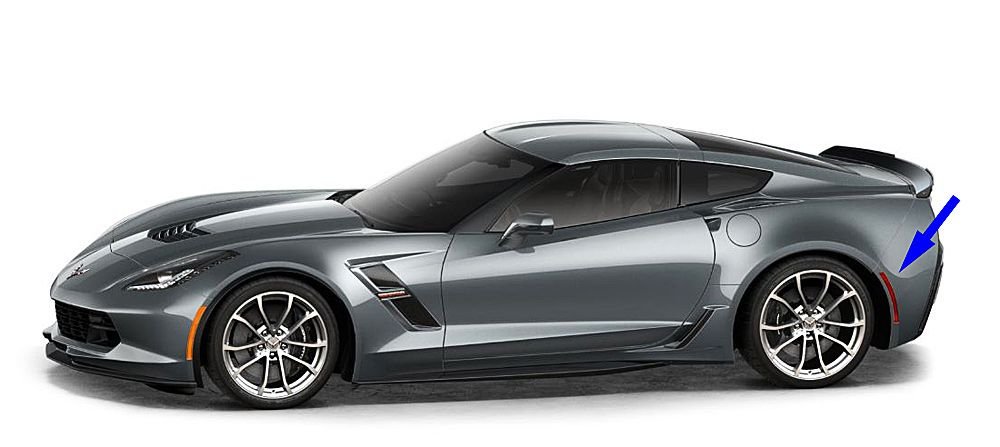

What's involved to replace the left rear side reflector on a 2019 GS 2LT? How is it done?

Those are actually pretty easy. They're not bolted, just clipped on. You could either get a trim pry tool and pop it out, or you could unscrew the nearest bolts on the wheel liner, squeeze your hand in there and push it out.

I popped them out to replace with the led Oracle's. I removed the liner first. I haven't had luck using the pry tools from the outside.
