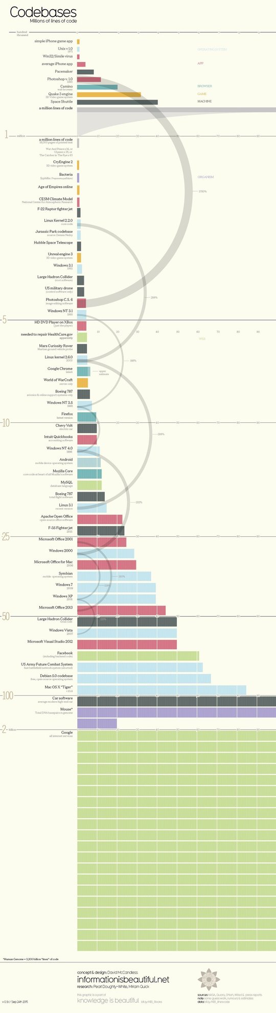

It's amazing how much code a modern car has:
Comparing the lines of code for just the Linux kernel to all of car software is a pretty disingenuous comparison. To be closer to reality you'd need at the very least the kernel, probably Google Chrome and/or Firefox (including Mozilla Core), MySQL, Open Office, The Debian 5.0 codebase (which I assume are things like the various shells, compilers, linkers and loaders), the X window system, a package manager like synaptic/apt/yum, a desktop like gnome, kde, etc.
Wired stated in https://www.wired.com/2012/12/automotive-os-war/ "a typical new car has about 100 million lines of code" whereas Computer world stated in https://www.computerworld.com/articl...tribution.html - "The results of applying these tools to 2008's Fedora 9 Linux came out to a total of 204,500,946 physical SLOC (Source Lines of Code)" - and that was 2008! Plus I doubt that car engineers are that thrifty with their code and there's probably a ton of waste, whereas gcc, for example (https://www.phoronix.com/scan.php?pa...tem&px=MTE1OTg) - "there's been 24,456,429 lines of code added and 17,108,190 lines removed"

Take your complaint to informationisbeautiful.net. It is their comparison.

I don't think they were necessarily making the comparison, just reporting things. I'm just trying to set the record straight that Linux != just the kernel. Comparing say MyLink to say VLC would be a fair comparison. But I've quite a few people here seem to say that car software is way complex when compared to other things. This is not true.
