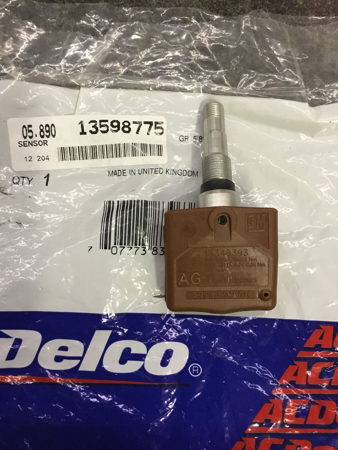

PN: 13598775 got mine from cultrag performance on ebay

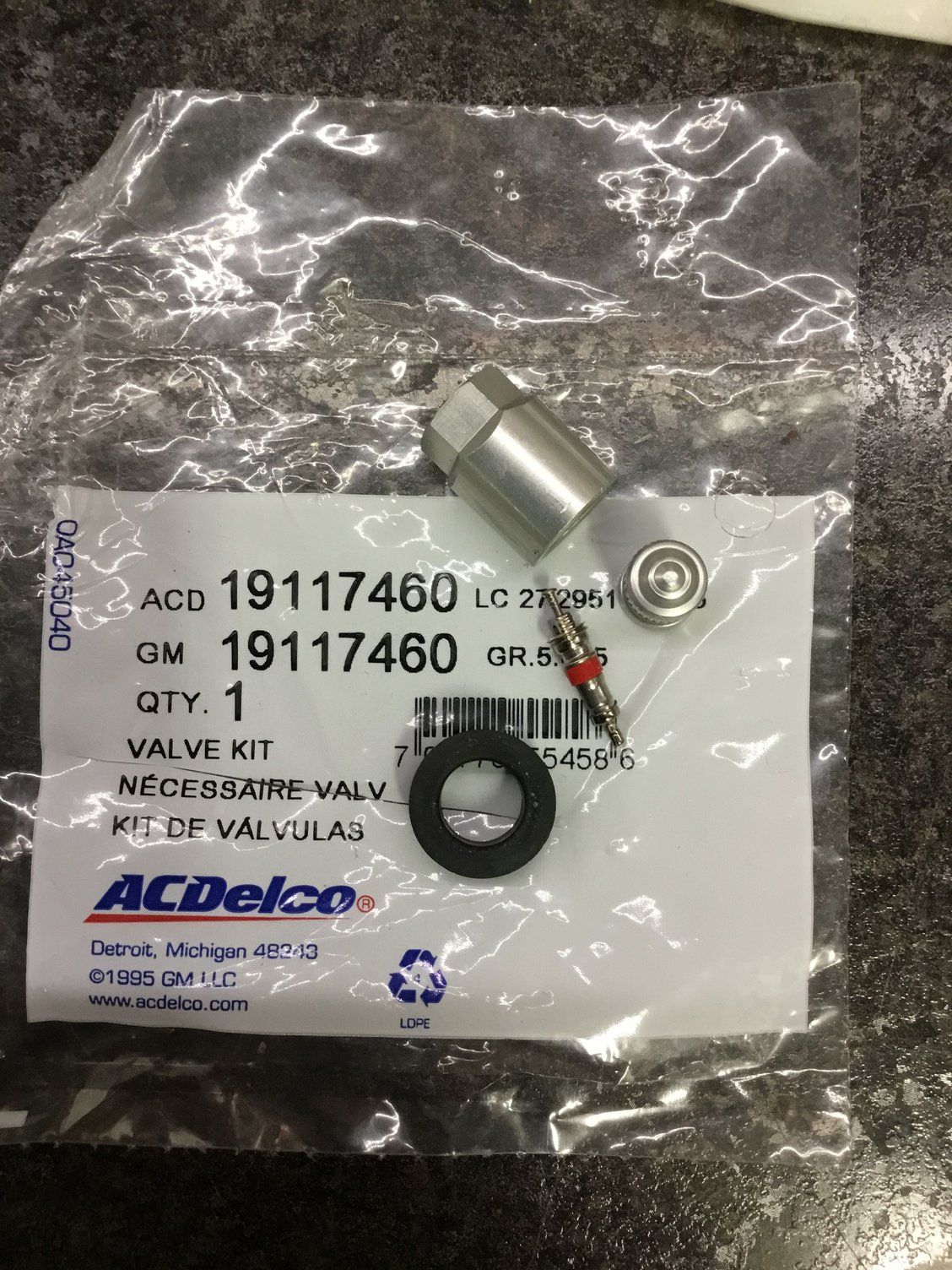

Just bought them today for a new set of a Forgelines I’m having mounted and balanced.
TPMS sensor doesn’t come with kit, i.e gasket and nut...GM mentality....

You dont have to buy these really expensive aluminum pieces. Just search for other GM TPMS with 433Mhz. They come with the black rubber end instead and are much cheaper and read the same.
