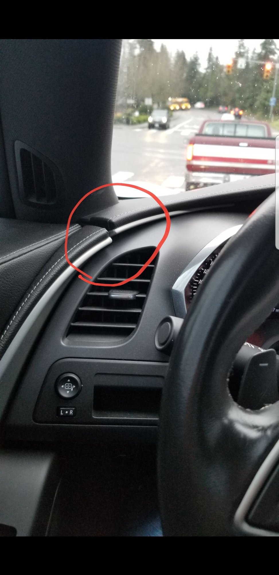

Misaligned door is bugging me. Is this normal?
Old Jan 23, 2019 | 02:32 PM
Bruno Stuani's Avatar
Bruno Stuani
Cruising
Joined: Jul 2018
Posts: 11
Default Misaligned door is bugging me. Is this normal?
Also, when I'm at an speed above 60mph, I can hear the wind through my door, on my left shoulder. Could this be related? How do I get both of this fixed?

the trim piece on your door is adjustable. the metal trim pops out and there are screws holding that long thin leather trim piece, and the screw holes have slots...mine was misaligned, with the outside looking normal, so I just adjusted it myself...

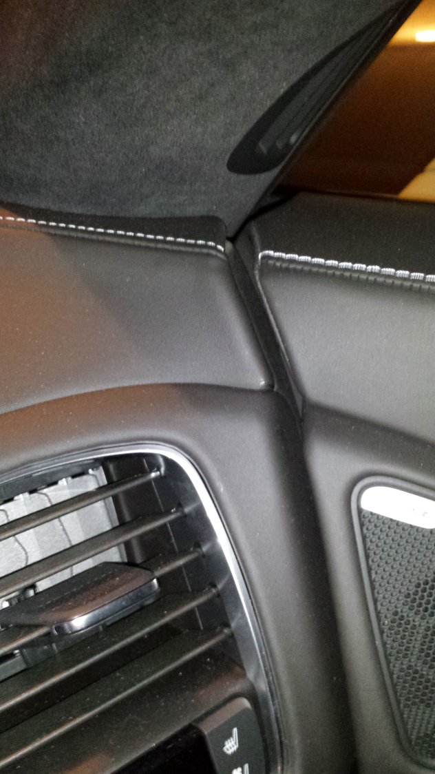

Yours definitely looks off to me.
..Here's my drivers/passenger side photos:

If everything is aligned properly from the outside, then your problem is limited to the interior trim.

Ah, yes. I missed this question earlier. From the outside everything looks normal, properly aligned

If the door looks nice and straight and even all the way around on the outside, its the door trim panel on the inside that needs to be adjusted or modified..
