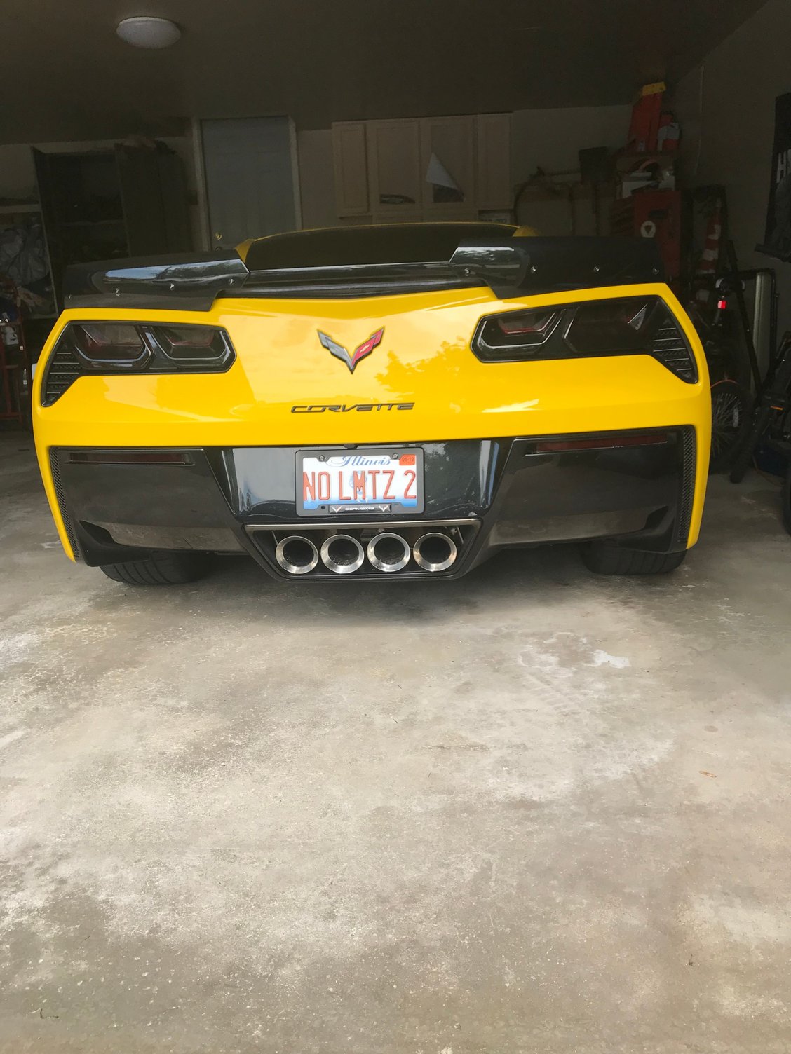

The spoiler you have is just the stock Z51 spoiler, there are no different stages for it like there are with the Z06 spoiler. As far as adding a stage 2 or 3 Z06 spoiler you can do it one of two ways. The harder way is taking off the rear bumper and remove your Z51 spoiler and install an aftermarket or OEM Z06 spoiler. The OEM spoiler will stick out past the rear of the car about an inch or so. I have seen aftermarket ones that mount flush and are made for the Stingray. The holes will line up the same so you will not have re- drill to make them fit. The second way is the way I did it. I bought the OEM Z06 winglets (not the entire spoiler ) and mounted them to my existing Z51 spoiler. It’s fairly easy to do and looks just as good in my opinion. Here is the link that I posted from when I did the conversion. Hope this helps.

Yes the difference between the the stage 2 and 3 is the transparent piece. There is also a stage 1 and the winglets are shorter in height than the stage two. This is my car with the stage two.

Thank you!, this was also an answer I needed. Any issues at high speeds and does it hang of the sides a bit? It looks great to me also and I already have stage 2\3 ready to install but didn't see a point in buying a Z06 spoiler as they look the same.

No they do not hang off the sides, the winglets are flush with the rear of the car. If you plan on adding the stage 3 center piece then they may have to stick past a bit, as that it is the only way to make it fit. I had no plans of adding the center piece so I lined them up so that they would be flush with the rear of the car It’s been over 2 years so far and zero issues with high speeds.
