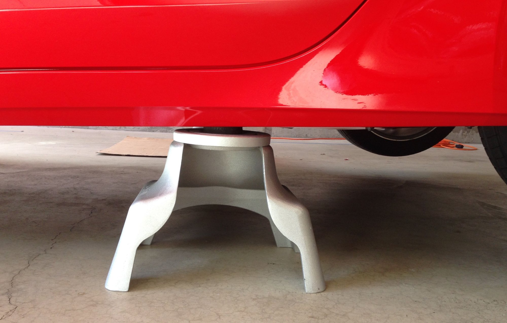

Doing the front first keeps the car level and allows the rear tires, which are locked by the transmission and parking brake, to ensure nothing moves. The car naturally pivots on the wheels so going front to back doesn't introduced any weird angles between the floor jack saddle and jacking pucks. Of course this method requires two jacks, takes more room and time, but in the end its what I am most comfortable with.
I use the above method for inserting ramps (which are too steep to drive onto) for oil changes or positioning jack stands on the subframes for brake work. One of the best systems I've seen, aside from a QuickJack lift, is this: http://www.jackpointjackstands.com/

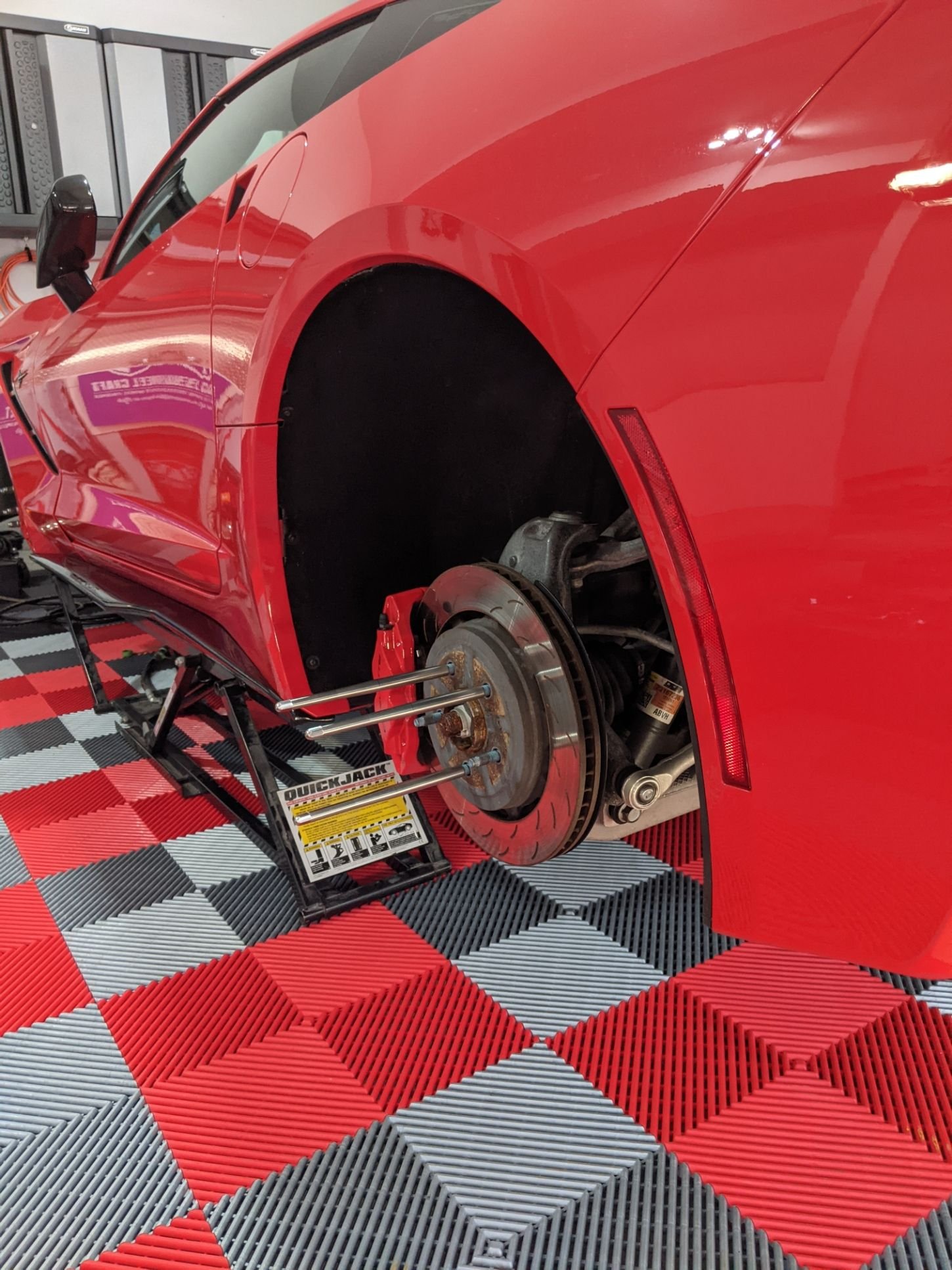

QuickJack will lift it slightly less than 2 feet. Plenty of room to change fluids from a creeper, detail the lower portions of the car, change tires/wheels and brakes. It does take time to set it up. I get the rails in place with blocks and jacking pucks, get the pump hooked up, raise it a little (just touching) and check again, then I check it again when the tires are about to lift off. It is probably 15 minutes before I am ready to get under the car. The QJ has mechanical locks so the car is not supported by hydraulics making it much safer. Fitting it under the car isn't a problem, I have my C7 lowered all the way on the stock bolts and I have side skirts and I still have about an inch between the pucks and the small rubber blocks. I have started using secondary supports for added safety if I'm going to be under the car but it really isn't necessary. No different than a lift. The rails are also heavy (75 lbs. each for 5000SLX) but they have wheels for moving them around and they slide easily to get them in position. I store mine right under the car. If you are considering purchasing them I would recommend the extended length version. I've been reading that the regular length is a little too short for the C8's.
Pros:
Very stable, simple to use, decent lift (~22"), 2 locked heights
Cons:
Setup time, weight, cost, limited lift (~22")
Stored under center of car (see rear)
On the lower of the 2 locking height positions.

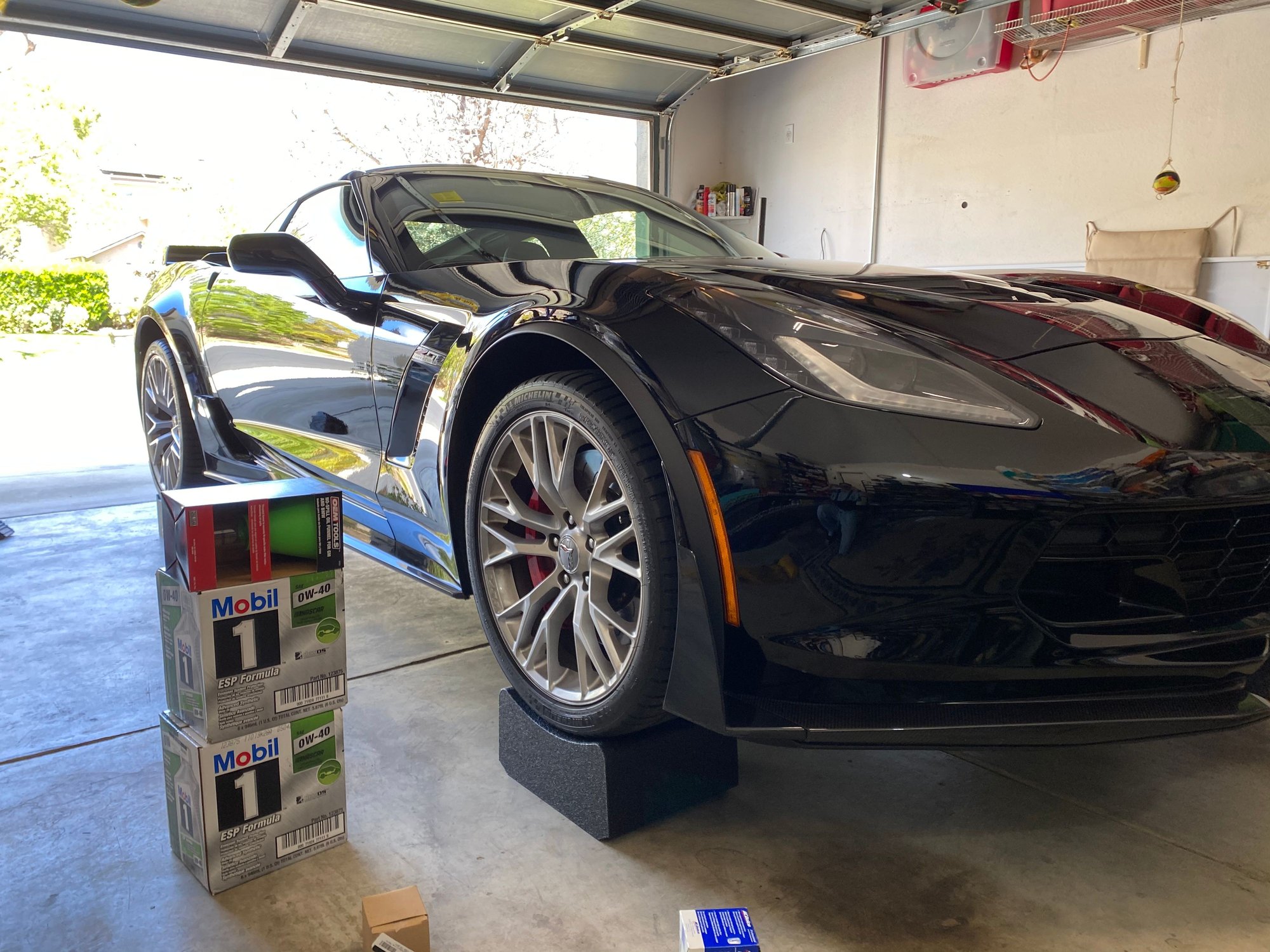

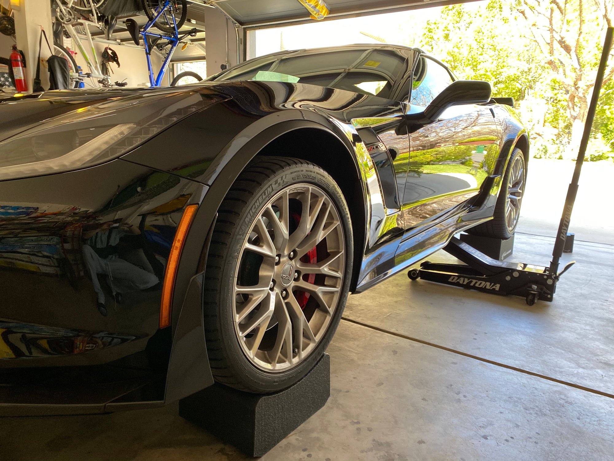

Used the race ramp wheel cribs for the first time for an oil change. Great product

92_383LT4 those are the same wheel cribs I have. glad to see they are wide enough for the z06/gs wheel.
What process did you use to get them up there with the floor jack? side to side or back to front?

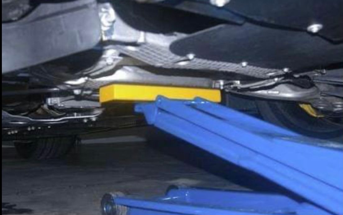

Here’s another option. These cross-brace adapters allow you to jack the front or back using ONE jack from a single jacking point. I just happen to be selling this set that has never been used.🤓
To Wheel cribs

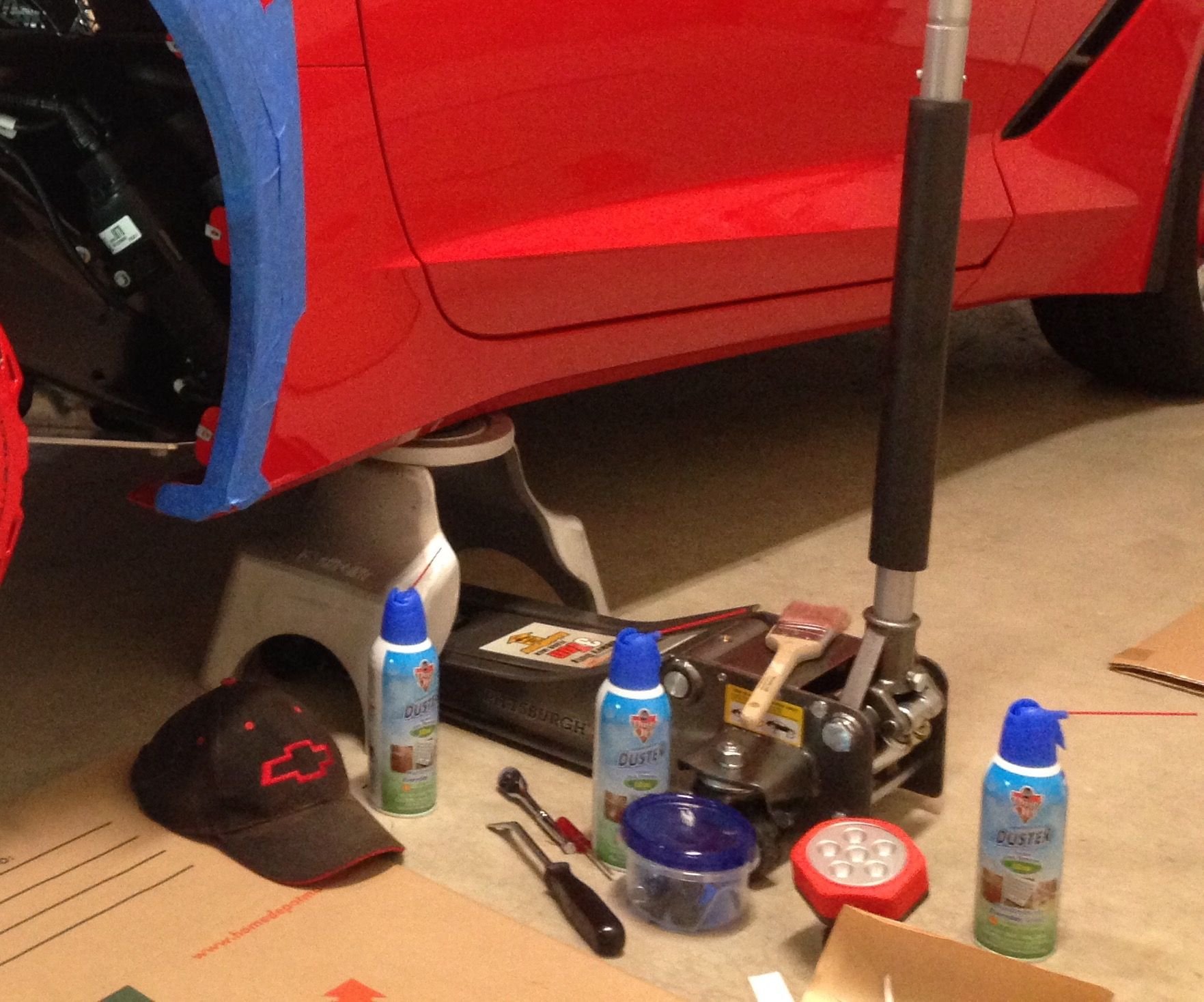

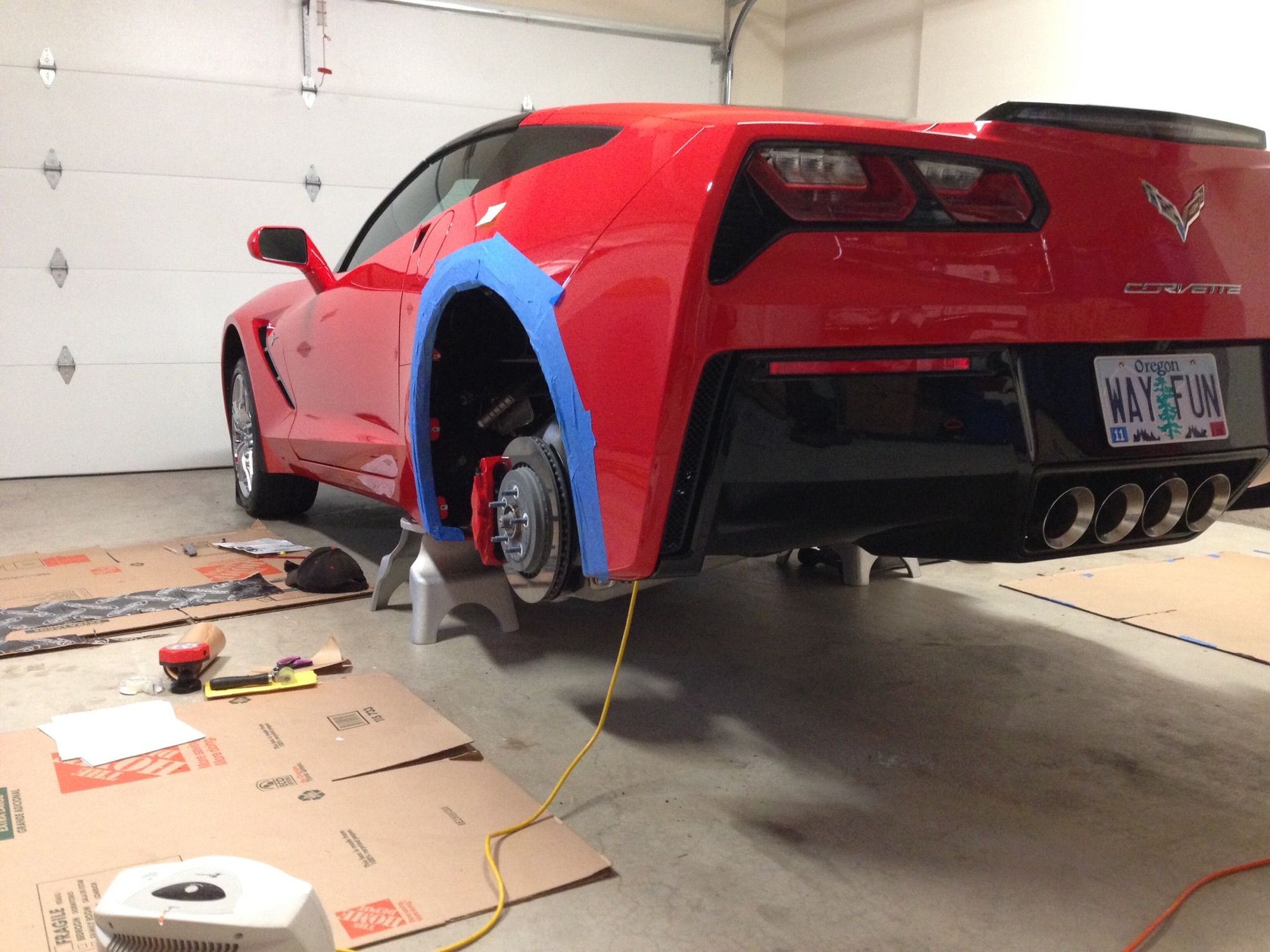

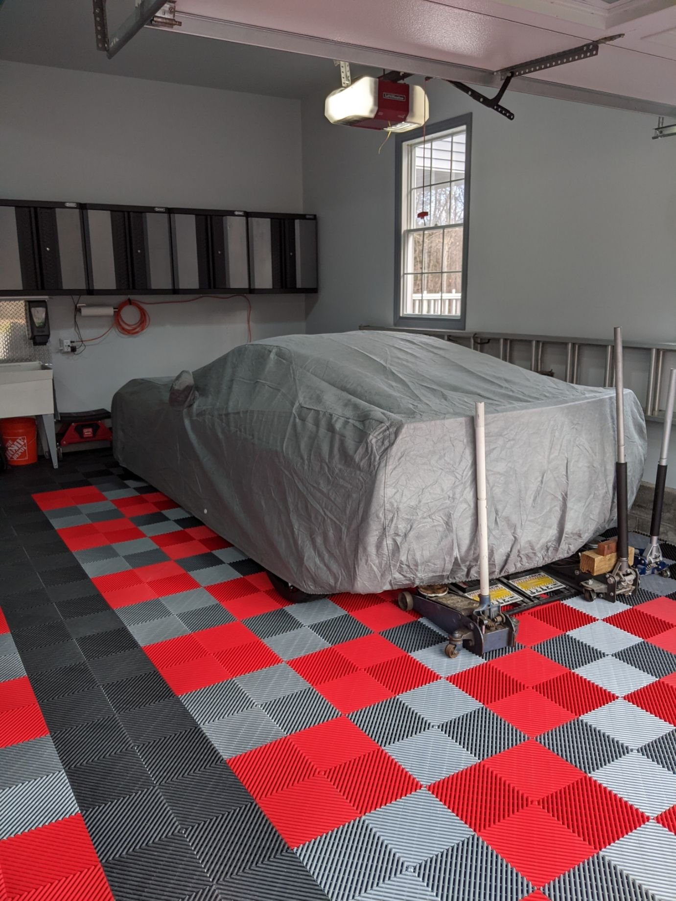

I already had a normal size and a small size HF aluminum jack. After about a year w/ my C7 I grabbed another small one on sale. I use the two small ones at the front frame/puck locations and the large jack at the rear subframe w/ a 2x6.
by https://www.flickr.com/photos/152454123@N04/, on Flickr
The two tabs on the end fit into the cavity just inside the control arms so the board stays locked in proper position.
It takes a little time because I only lift each jack maybe 1-1.5 inches at a time. But this way I don't end up w/ much weird angle. Just changing tires I don't bother w/ jack stands but, if I am going to work under it, I set several stands at frame points. Sorry, I don't know why I get double pics.

front to back. Emergency brake enabled.
started on left front — right front — right rear — left rear.
I did notice that when jacking up the right rear, the right front slightly lifted above the right front crib again.
removal LR — RR & RF (since Front went of the ground again) & LF
