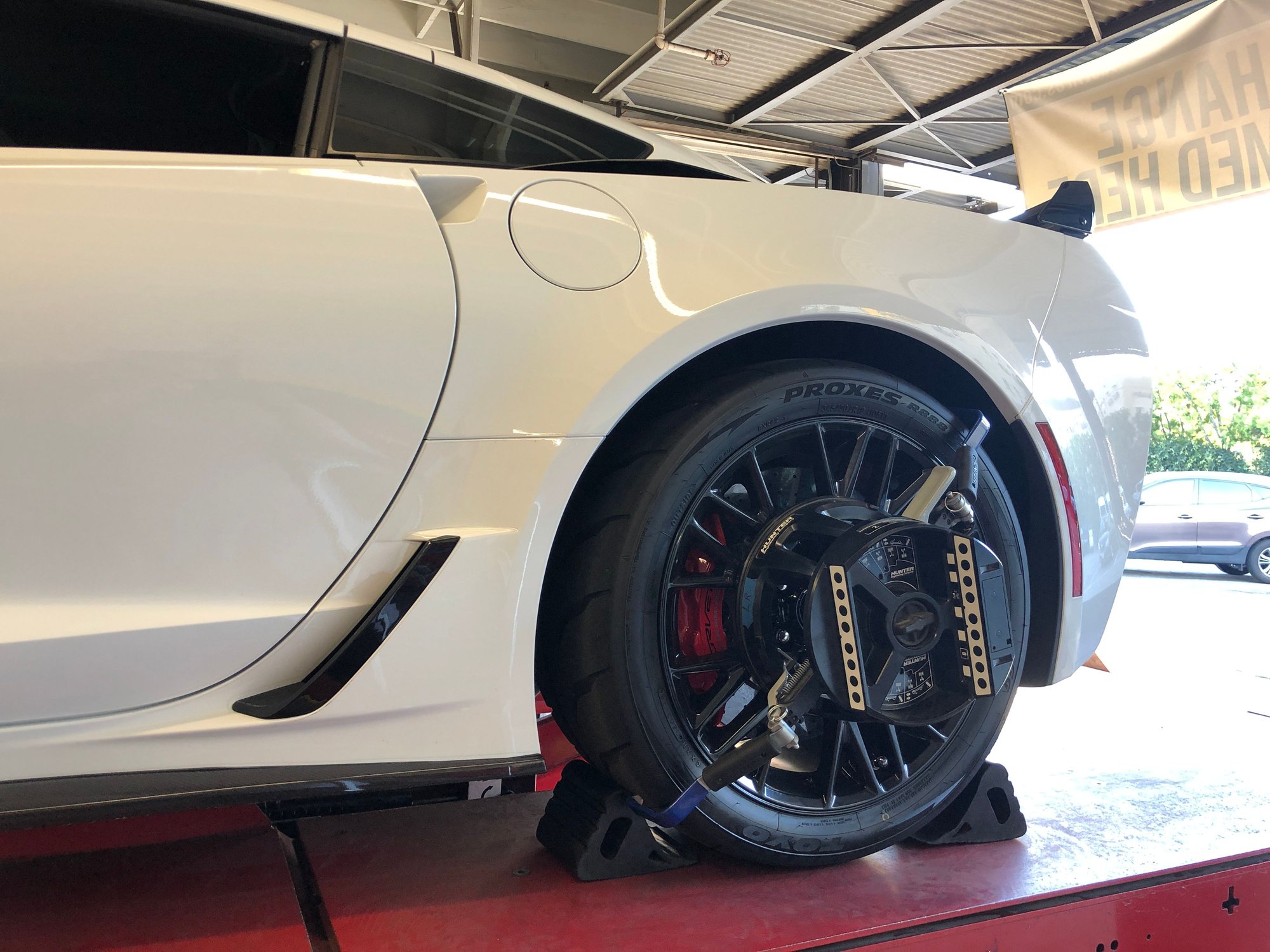

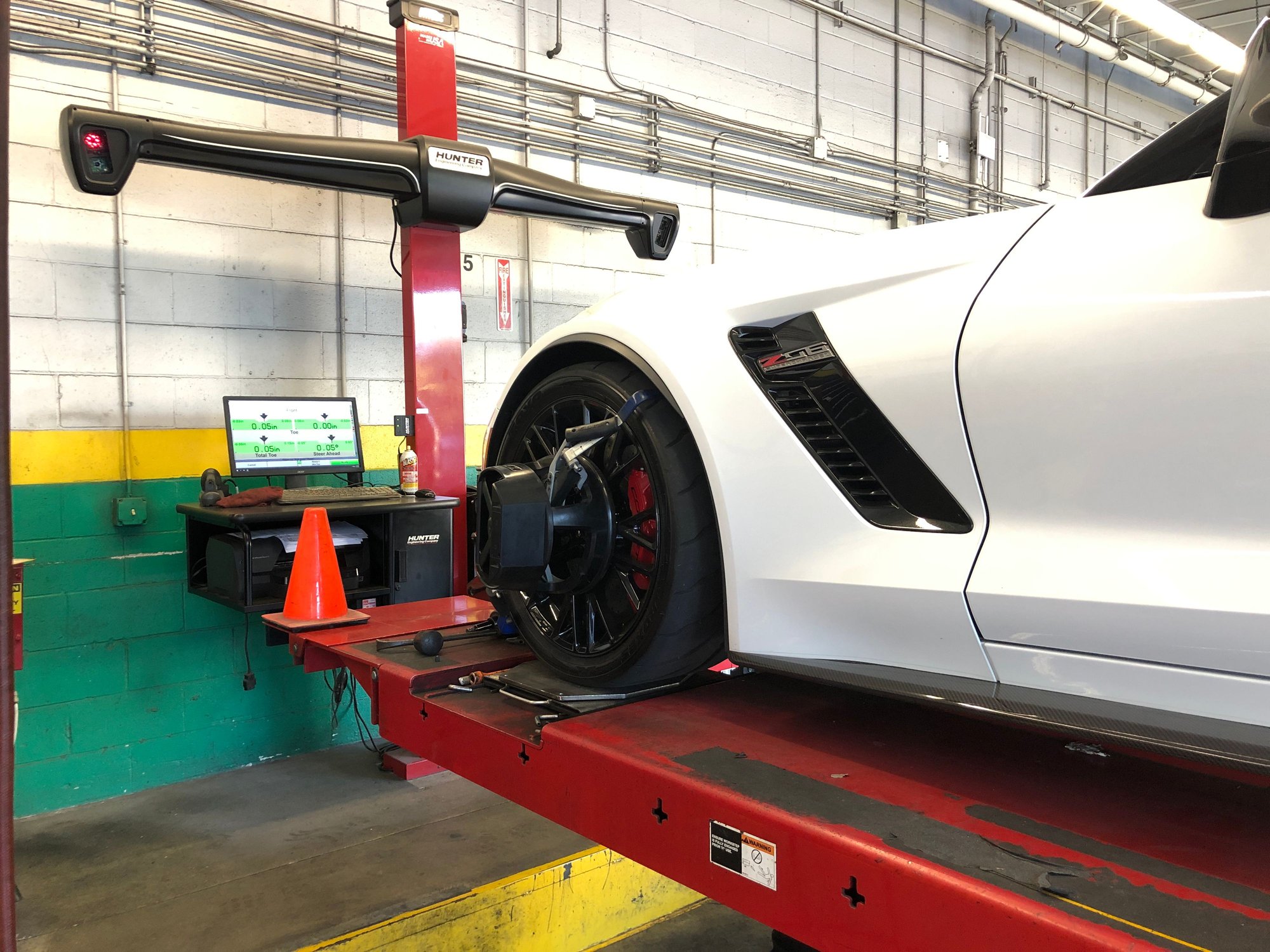

Hello forum family,
posted this in the tech section but got no love. So Repost here
my car has been out of alignment and I can’t seem to figure what’s going on. I took it to a local alignment shop but they did not resolve the issue.
i am using 295/35/19 Front Toyo r888r & 345/35/19 rear r888r.
The car car seems to be pulling around at higher speeds and unstable when turning.
the caster is off on the driver side and the alignment guy said it’s “non adjustable” but there is no way.
the car has never been in any accident nor had any damage wheels, curb rash or anything.
The car car drives straight and feels okay at lower speeds, but once above 70-100+ it feels like the front end jerks around
Going to try another alignment shop today. Any assistance ?

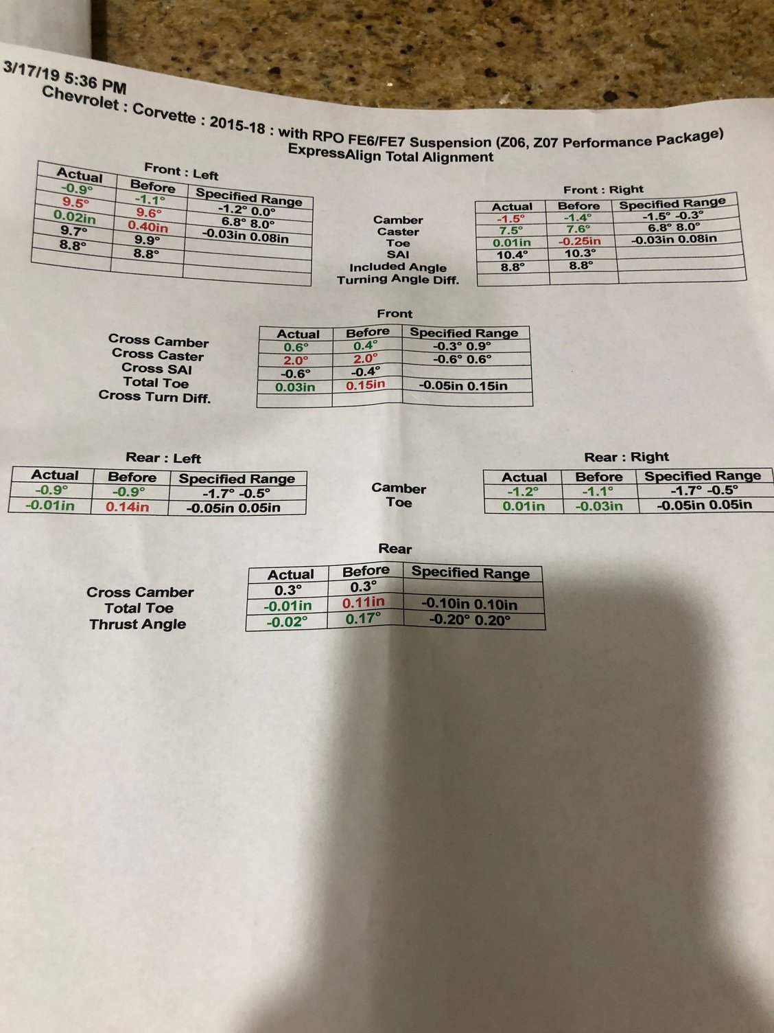

Here is some info about DSCsport's take on alignment. In particular, the more 'racy' the car and driver, the more camber is recommended. More camber also scrapes off the inside of the front tread much faster. Your car has more camber cranked in to the GM spec than the base C7. I also hear that changing caster (and maybe even camber) requires special tools and a very competent tech. Use special care with your choice of shop.
I am getting an alignment tomorrow on my Base C7, and aiming for nominal GM spec values.
http://www.dscsport.com/wp-content/u...nt-sheets1.pdf
Edit - As patternday states in the next post,, I agree those numbers are a mess. Seems best to find a very competent shop, go for GM spec numbers, then do any further changes after you have a decent baseline.

The alignment is an absolute mess. All they did was adjust the toe in.
For a street car, every single spec here except caster on the right front and toe in, is screwed up, and its absolutely no surprise at all that it wont hold a line at speed.

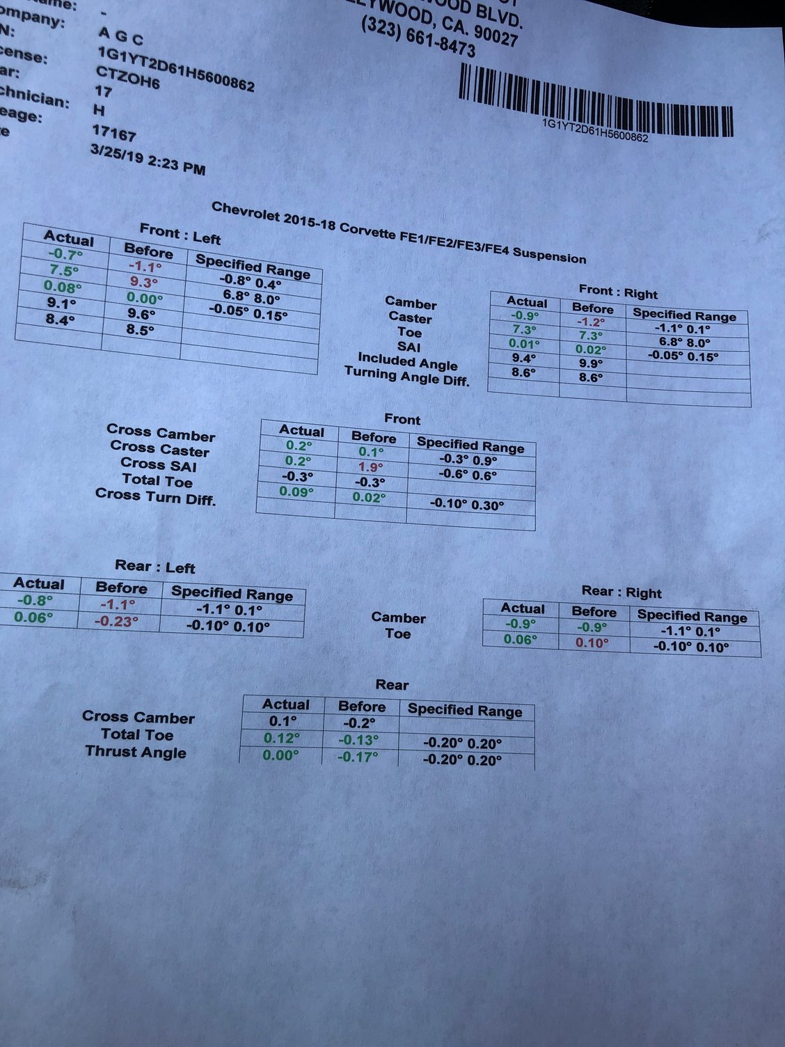

Update w the alignment spec from a different shop
will need to do some driving to see results. He said it was a total mess as well

OP, this new result looks much better.

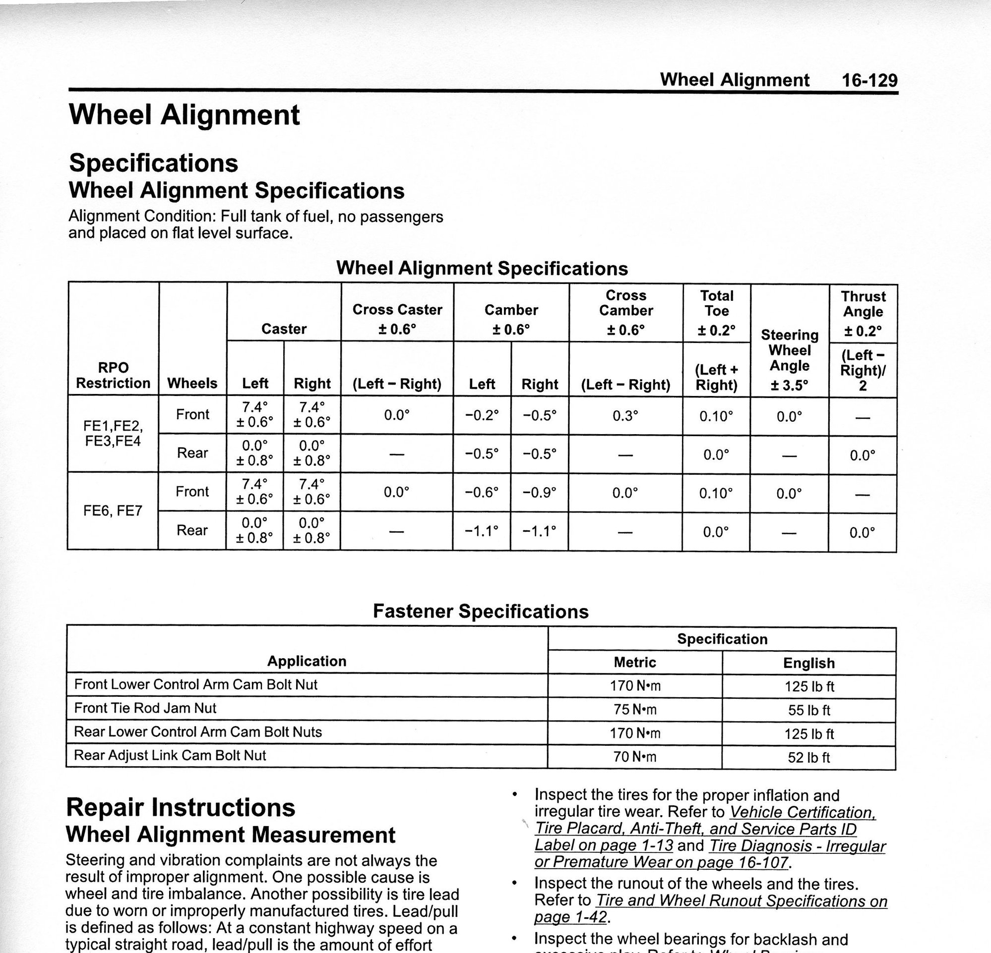

However, it looks like they pulled specs from base/z51 cars, such as FE2,4, etc. Below is a screen shot for the 2016 model year.
From your pic in the first post, it seems FE6 or 7 would be for your car.
The tolerances on their report reflect the spec values shown below for the FE1-4, as noted on their report.
Check your car to see what suspension code is yours.
However, in any case, you have CONSISTENCY among the wheels, which was definitely missing before.
The FE1-4 settings are good street/track combinations and may have better tire wear. You may prefer the FE6/7 version if that is what your car is supposed to have.

Big improvement. I would have went closer to zero on the camber settings, especially since your complaint was the car wouldn't hold a line at speed, but this is much better.

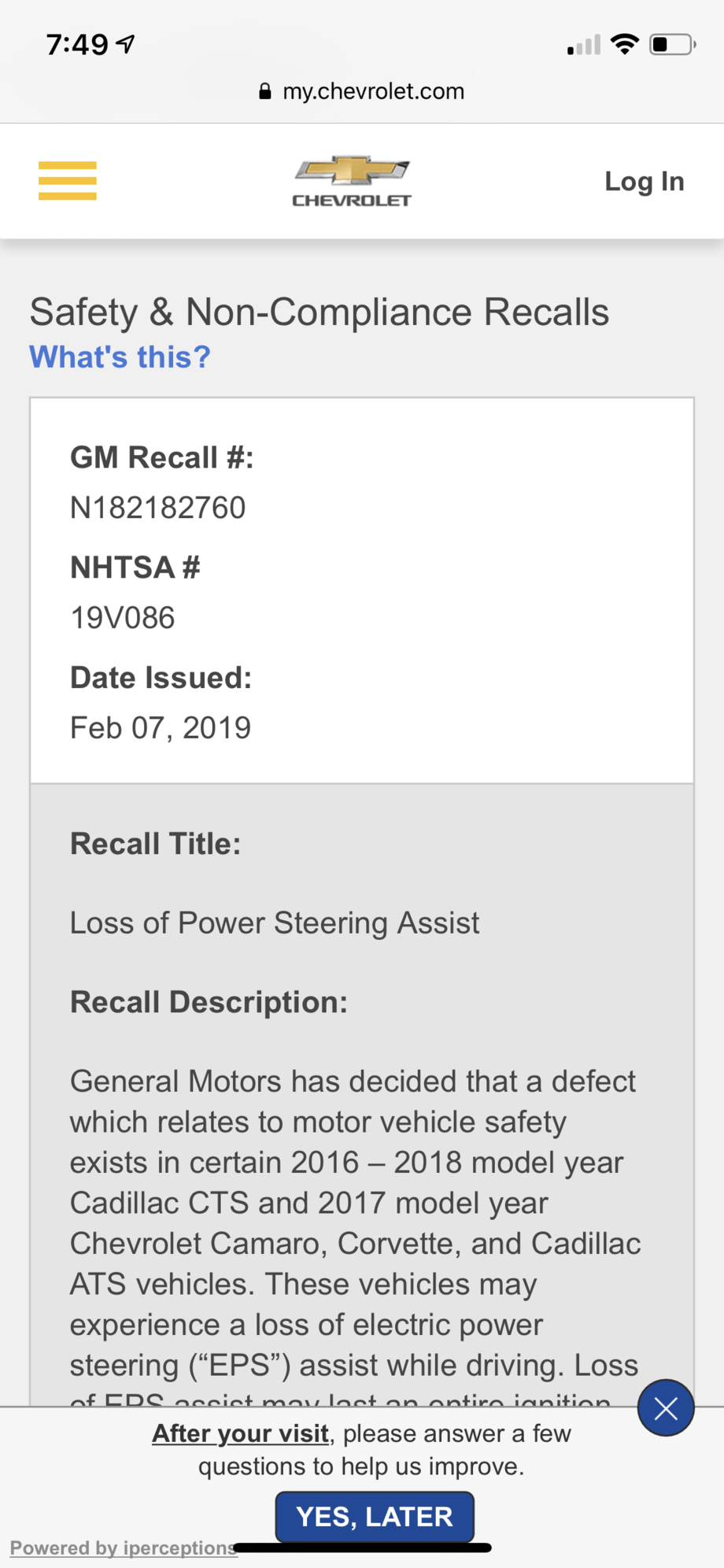

I’ve read that some people issue something with the steering rack which causes the front end to wonder around. I think my vin has the power steering loss recall but I’m not loosing power steering. I’m going to switch the wheels and tires and try the OEM spec. I never had this issue when I first installed these tires and I’ve gone through a few sets
i wonder if the steering rack in internally going bad

Lots of really good very experienced recommendations in this thread. Thanks for posting and sharing your opinions and your results.
Which of the specs listed in the charts pictured above would you recommend for a base Stingray please?
