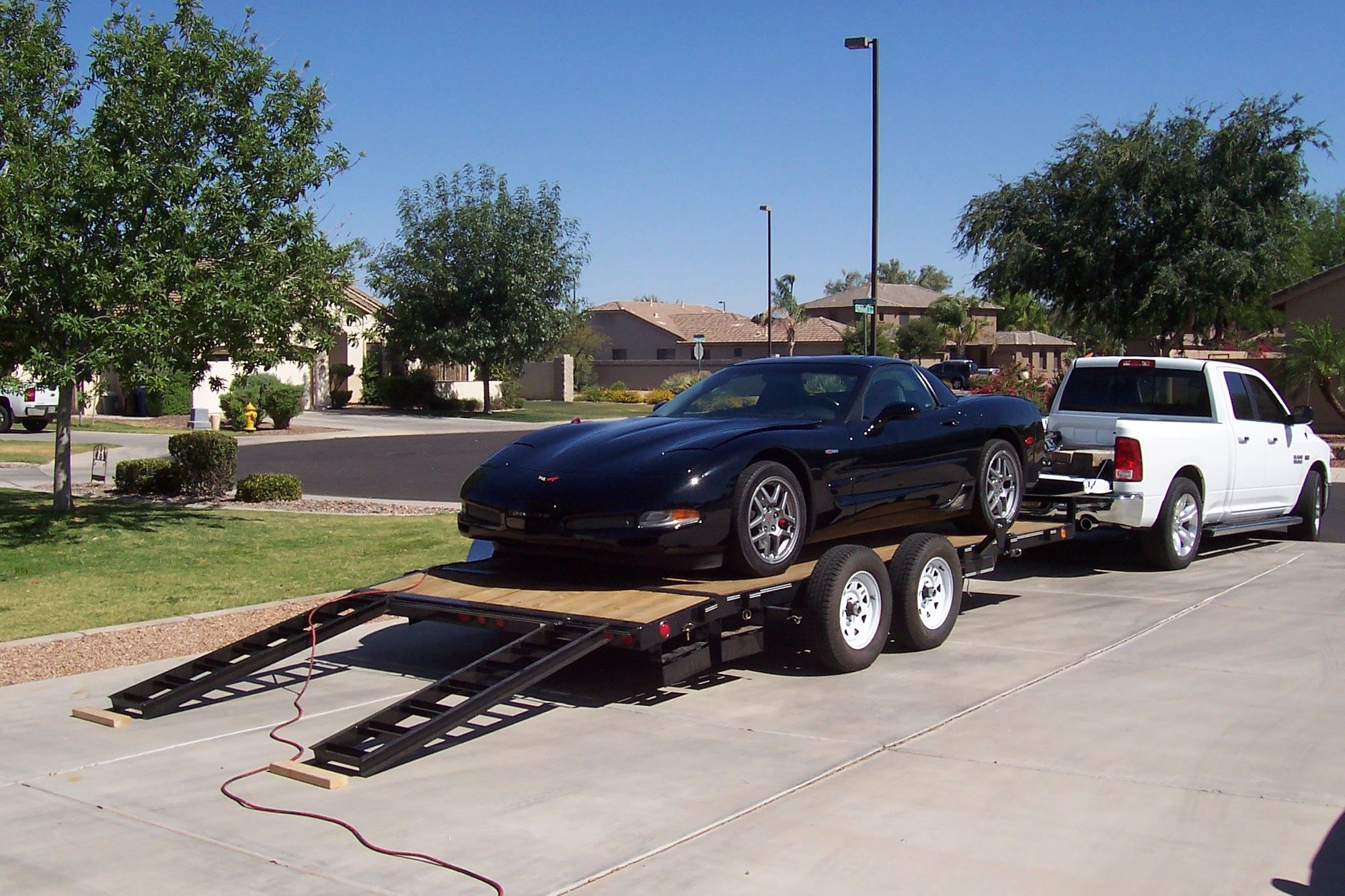

Mine ^^^^^^^^^^^^^^^^^^^^^^^^^^^^^
^^^^^^^^^^^^^^ Not mine.
There are quite a few different ways to easy the ramping angle for cars with low clearance. The U-Haul is actually quite a bit lower than most car haulers so that's a plus. Some U-Hauls also have a pretty high tire stop so I assume that's why the Corvette in the picture above is loaded *** end first. I never have help loading and have gone both front and rear first and I'm kinda liking the *** end first with a manual trans. Auto's are a piece of cake, but if it's your first time loading you better be familiar with your car's clutch if it's a manual. No foot on the brake and one on the gas with a stick. When loading *** end first I use the mirror that's set in a downward position.
