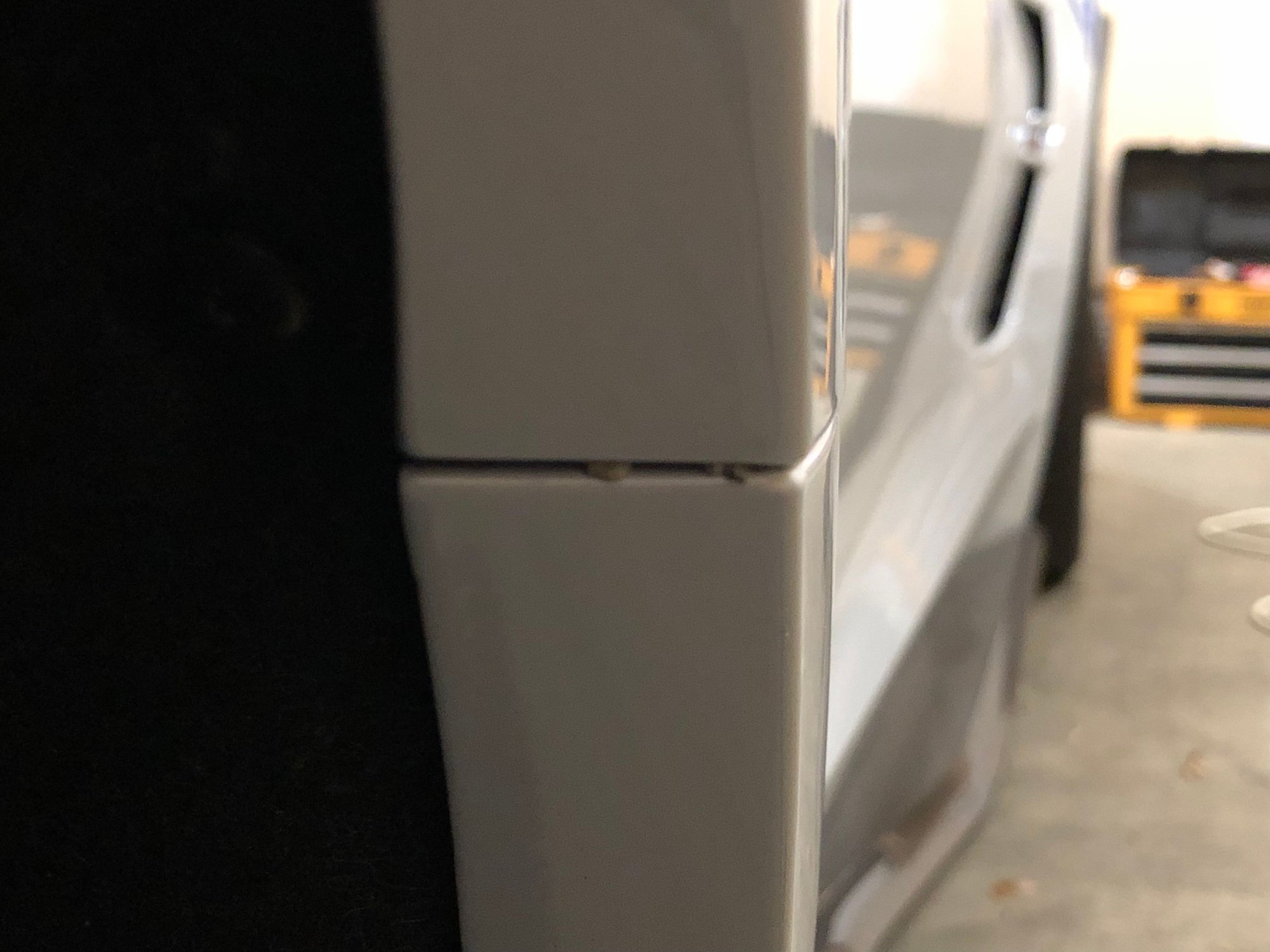

On the C7 what is the best method for removing rocks stuck in the panel gap between the rocker panel and the rear quarter panel in front of the rear tire? On the C6 you simply loosened a couple screws on the rocker panel and voila. On the C7 it’s not readily apparent how this is done.

Just gently push inward with a toothpick and they fall down through the inside. Don't pull them out. That might scratch the paint. Just a gentle push and they tumble down.

Pushing them in with a toothpick worked. Thanks.

Just get a plastic body shop tool and wedge it in the gap, then blow the rocks out with an air compressor.

+1. I'd try to gently expand the gap with a plastic trim tool to mitigate scratching.

i use a plastic tool to spread the gap a bit and blow them out with a compressor....no scratching.
