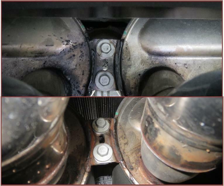

Normal, as is “Rust” on muffler welds.
If you haven't bent down and looked carefully - the 409 stainless aluminized mufflers rust around the welds, where weld spatter stuck and where the heat from joining the exhaust pipes burned off the aluminum coating! If that "rust" on the exhaust manifold bothers you, you'll really be unhappy about the mufflers! This is a PDF of what I used to turn the rust a black/blue. Not a perfect solution but costs under $10, does not require removing anything and can be done in 15 minutes!
http://netwelding.com/Muffler_Rust.pdf
First saw the muffler "rust" on IVERS at Laguna Seca in August 2013! It had been reported on this forum even before the first production. Rust Reformer solves it on the muffler, but not very effective on the cast iron headers. Helps some. PDF has pics on the exhaust manifold application.
Before and after pics of applying “RUST REFORMER.” It’s NOT A PAINT. Looks like “milk” and only converts brown fist to blue/black. DON’T PUT ON HEAVY, a few light coats about 10 minutes apart is all that is needed. NOTHING TO PEEL.
The reason for the mufflerrust is outlined in the PDF.

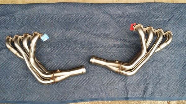

Yep just giving lowest cost parts option. Here's my solution but I didn't install them due to rust concerns:
