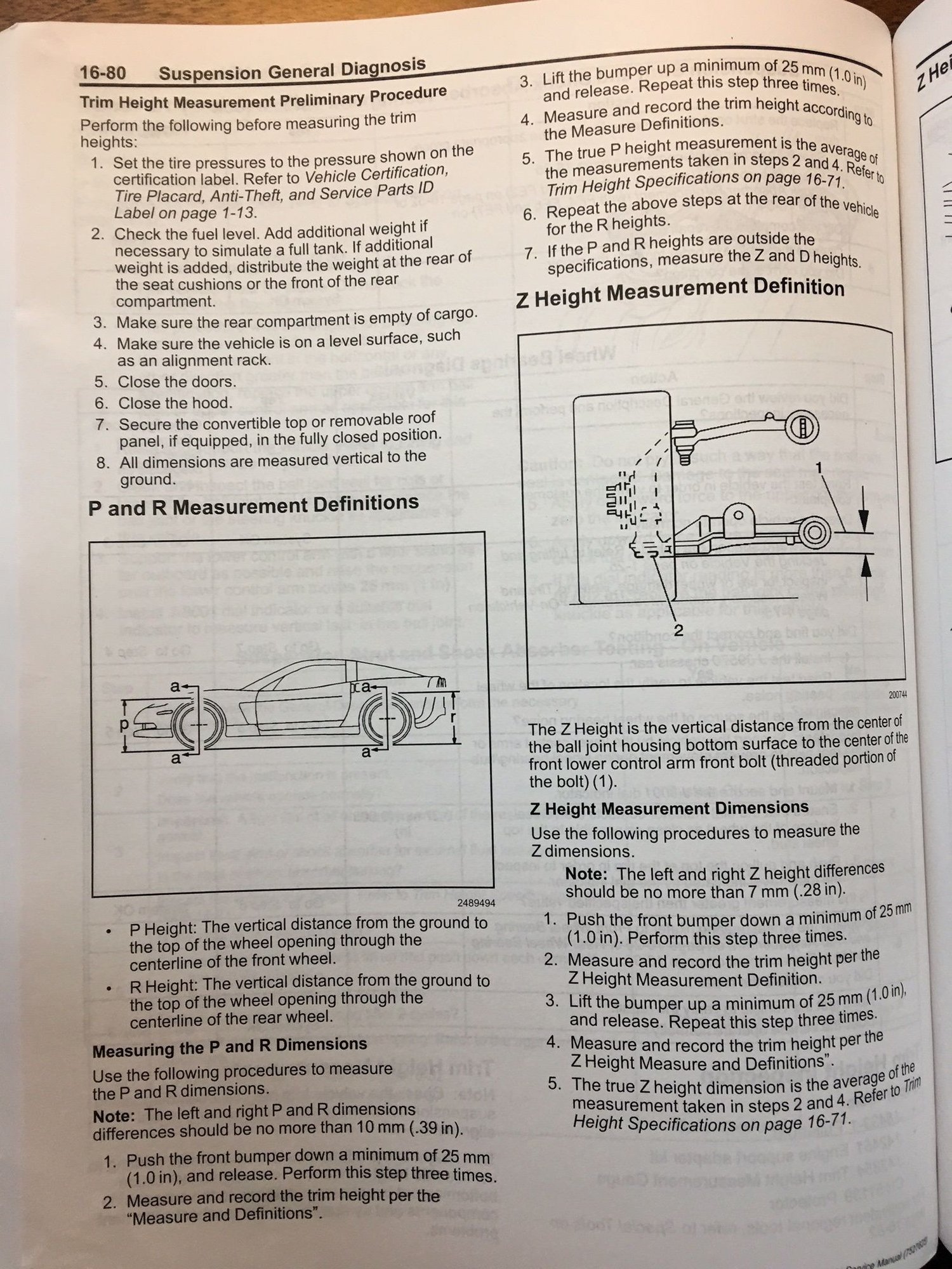

Not sure what you may purchase but I have a 15 Z06/Z07 with the Stage 3 Aero. The tip of the front splitter is 5 5/8 inches off the ground and 34.5 inches ahead of the center of the front wheel where it touches the ground. The stock front splitter is a $2000 carbon fiber part so keeping it away from curbs and steep driveways is important.
Here is a diagram showing my car's measurements. I put these together when I was purchasing a trailer and didn't want to drag parts on the ramp.

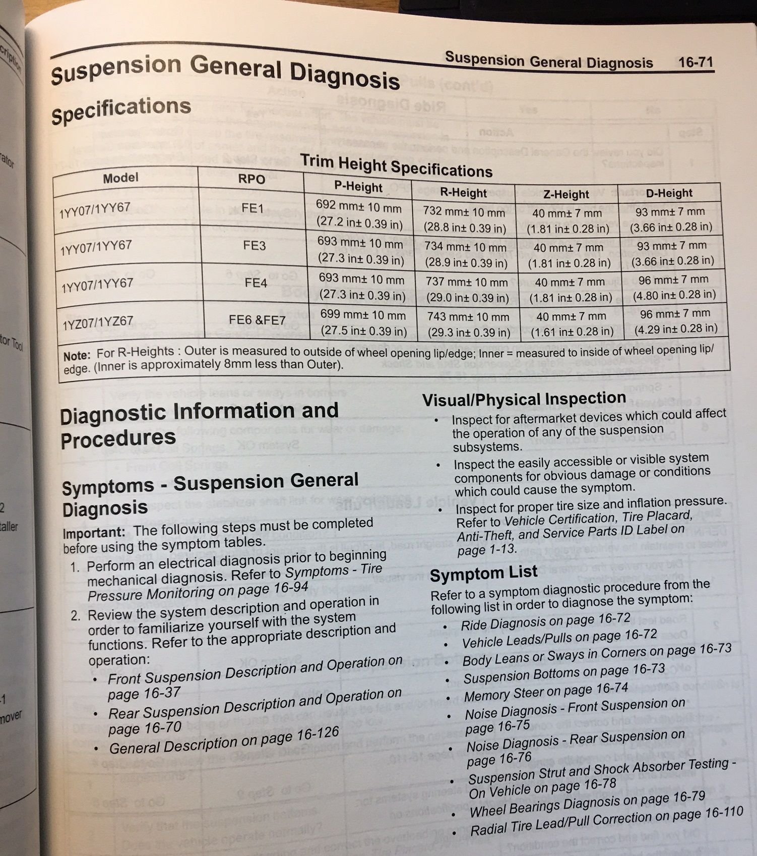

Z07s are usually about a half inch higher than Stingray's, however, GM has something like a .6 inch tolerance on the ride height measured from the ground to the center of the wheel arches.
Here is the GM Ride Height info:
Yes, the C7 can be raised or lowered just like the C5.
