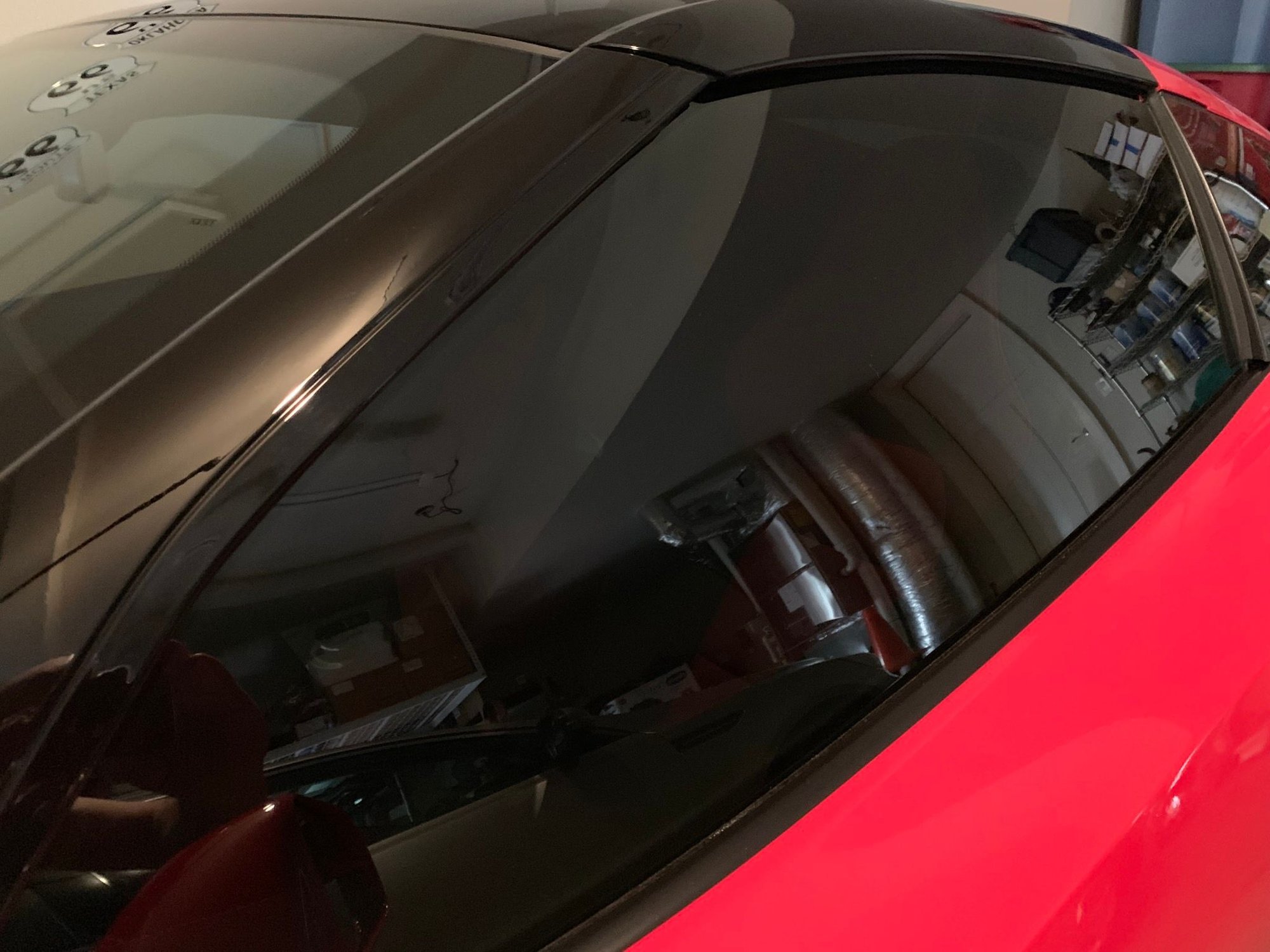

Originally Posted by Maxie2U
Completely UNACCEPTABLE. The tint needs to cover the entire windows like the window came from GM tinted, you should NOT see any edge....NONE.
Could you please send me a picture of how it looks on the edges of the window?
I’ll confirm if that is dirt under the tint or not tomorrow morning. What a giant pain in the *** this has been.
To be more specific, the tint should go to the beginning or damn close to the radiused grind on the edge of the glass, not to the end of the glass.

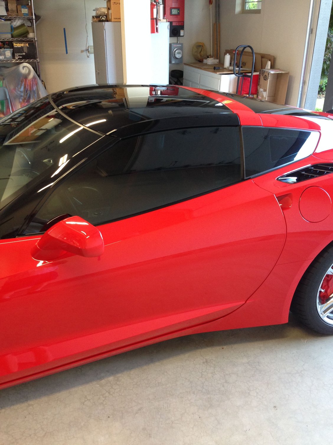

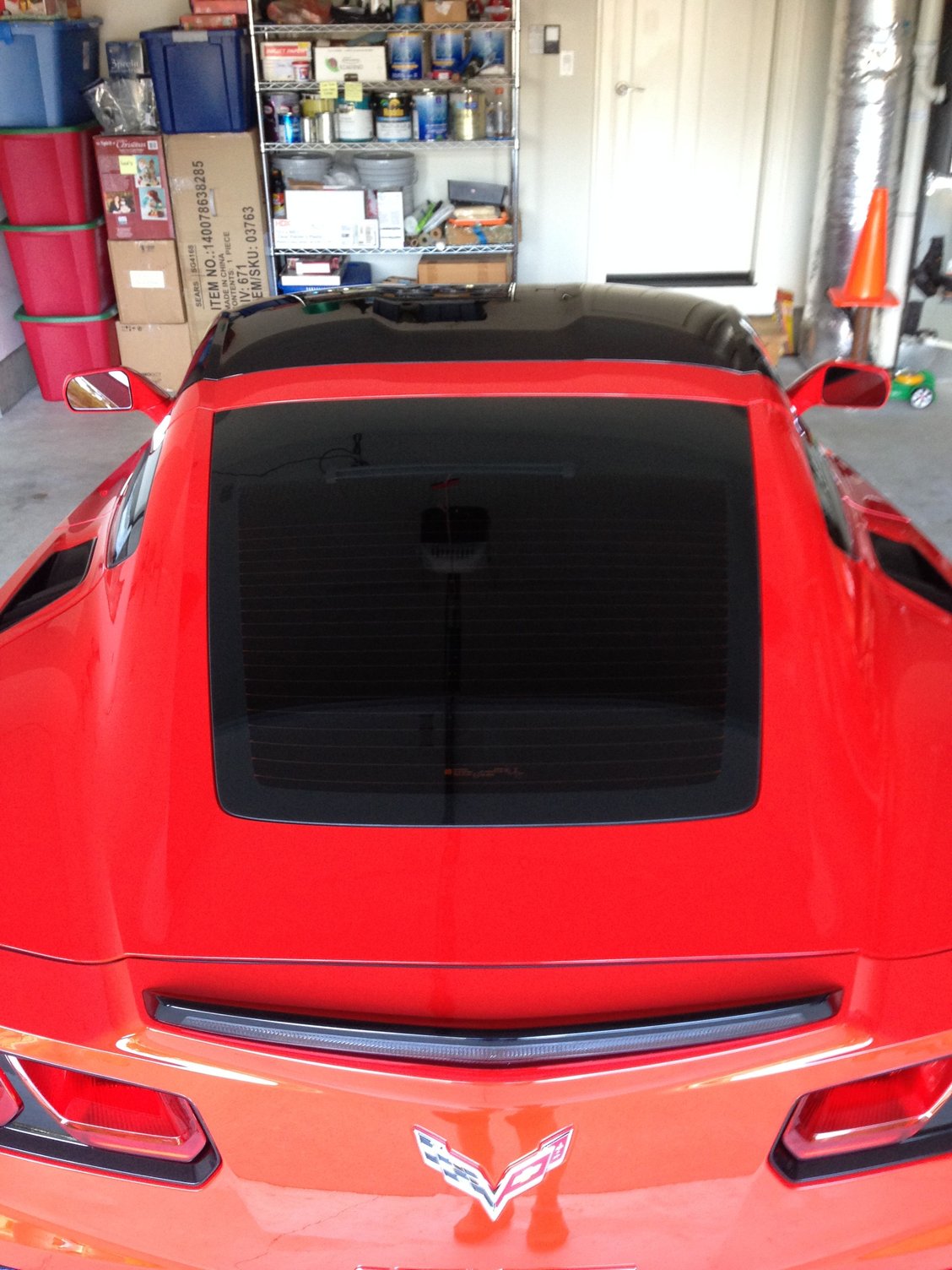

As GTs 58 said, the tint should go to the beginning of the radiused grind on the edge of the glass. That is exactly where my tint ends. Except for the fact the window is darker I can’t tell there is window tint!

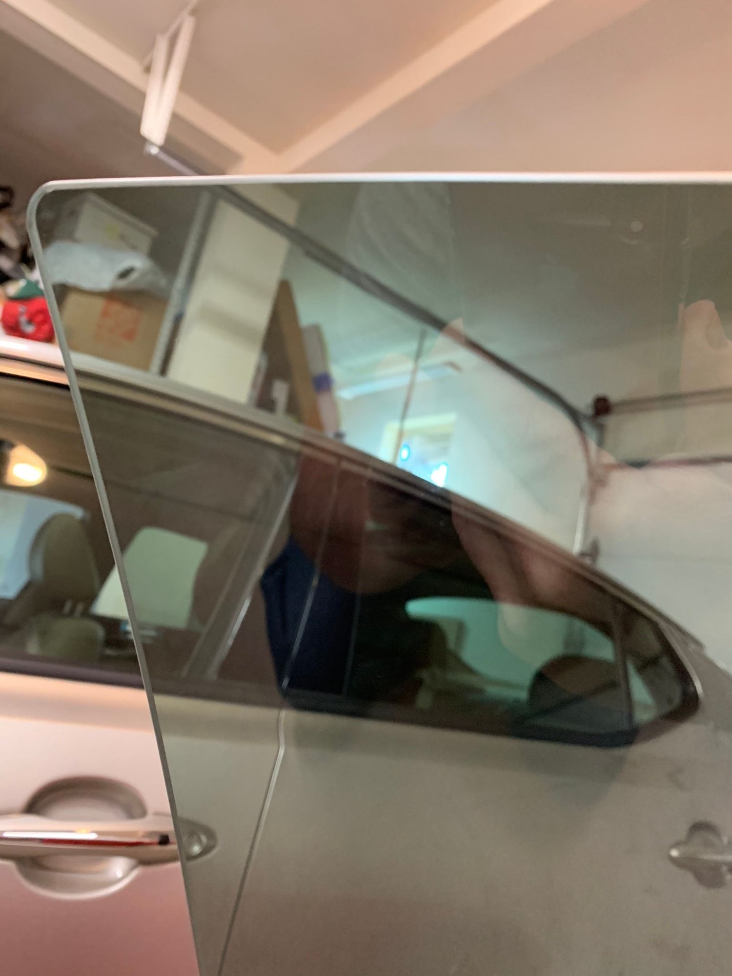

This is in the first video that Maxie2U posted. Looks like that tint is a quarter inch shy. Like I said earlier, the tint does not go completely flush with the edge of the glass on operable windows. The good shops around here leave no more than 1/8" from the edge of the glass.
