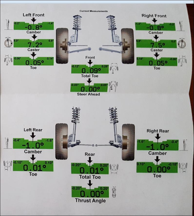

Had my 2019 GS alignment done to give better tire wear. Name:  photo423.jpg

Originally Posted by TNSQUIRE
Had my 2019 GS alignment done to give better tire wear. Attachment 48302444
I pretty much love this.
The guy could have got the left rear a little closer but the front is really good in my opinion.
Old May 9, 2019 | 10:49 PM
TNSQUIRE's Avatar
TNSQUIRE
Joined: Mar 2014
Posts: 1,767
Likes: 338
From: San Diego CA
The guy could have got the rear a little closer but the front is really good in my opinion.
It's a good alignment shop and they do a lot of Corvettes. They found three settings completely out of spec and the car only had 600 miles on it so it came that way from the factory.

Originally Posted by ny32182
No rear caster measurement or adjustment on that one?
No. I actually didn't ask about it. They did this same alignment on my first C7 and I got 38k out of my rear tires.
