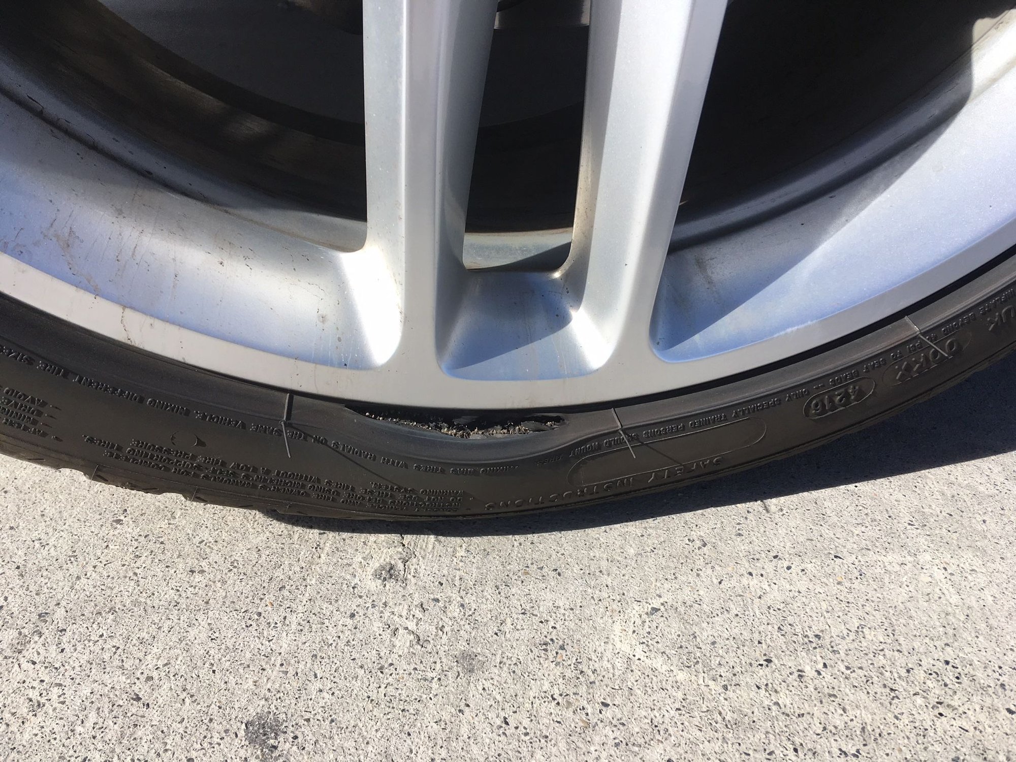

OTOH, damage like in the photo might not be prevented by just a little more sidewall height. Two different tires, one per year.
But so far I'm not hearing of tire damage or bent wheels on base cars.
