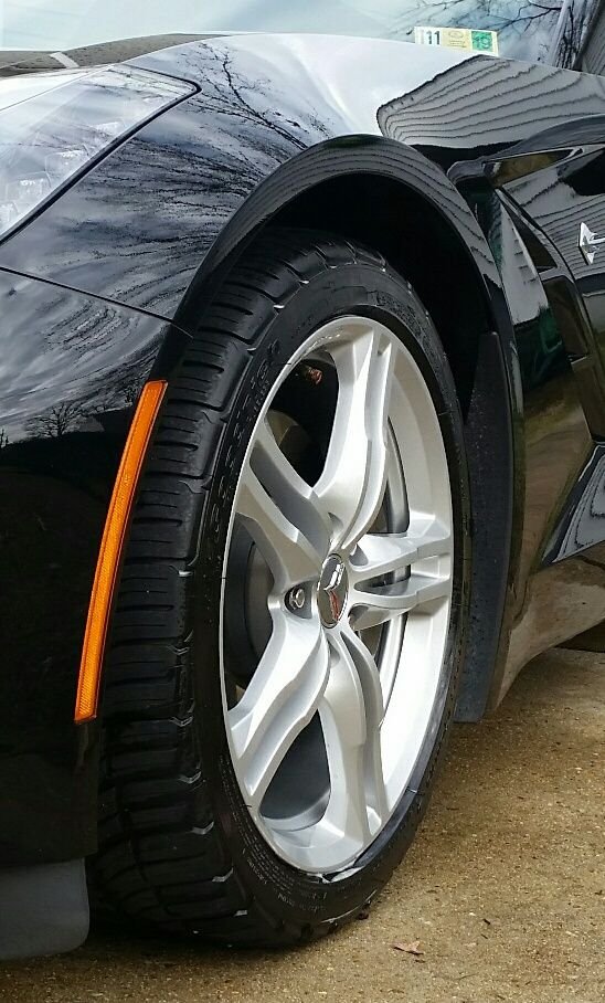

Since mine is a daily driver, including rain and some cold temps, I went with the Michelin A/S 3+ ZP. As @Vetteman Jack stated, the non run flat version of this is the A/S 3+ (no ZP).
I see no reason to stay away from run flats. With the low profile of the Z51 tires, you're not going to feel much difference between the fun flat and the non run flat but you do lose the benefits of the run flats, including the ability to continue to drive with a tire that could not be fixed with a can of slime. There have been multiple reports of significant tire damage that the Michelin run flats took in stride.
