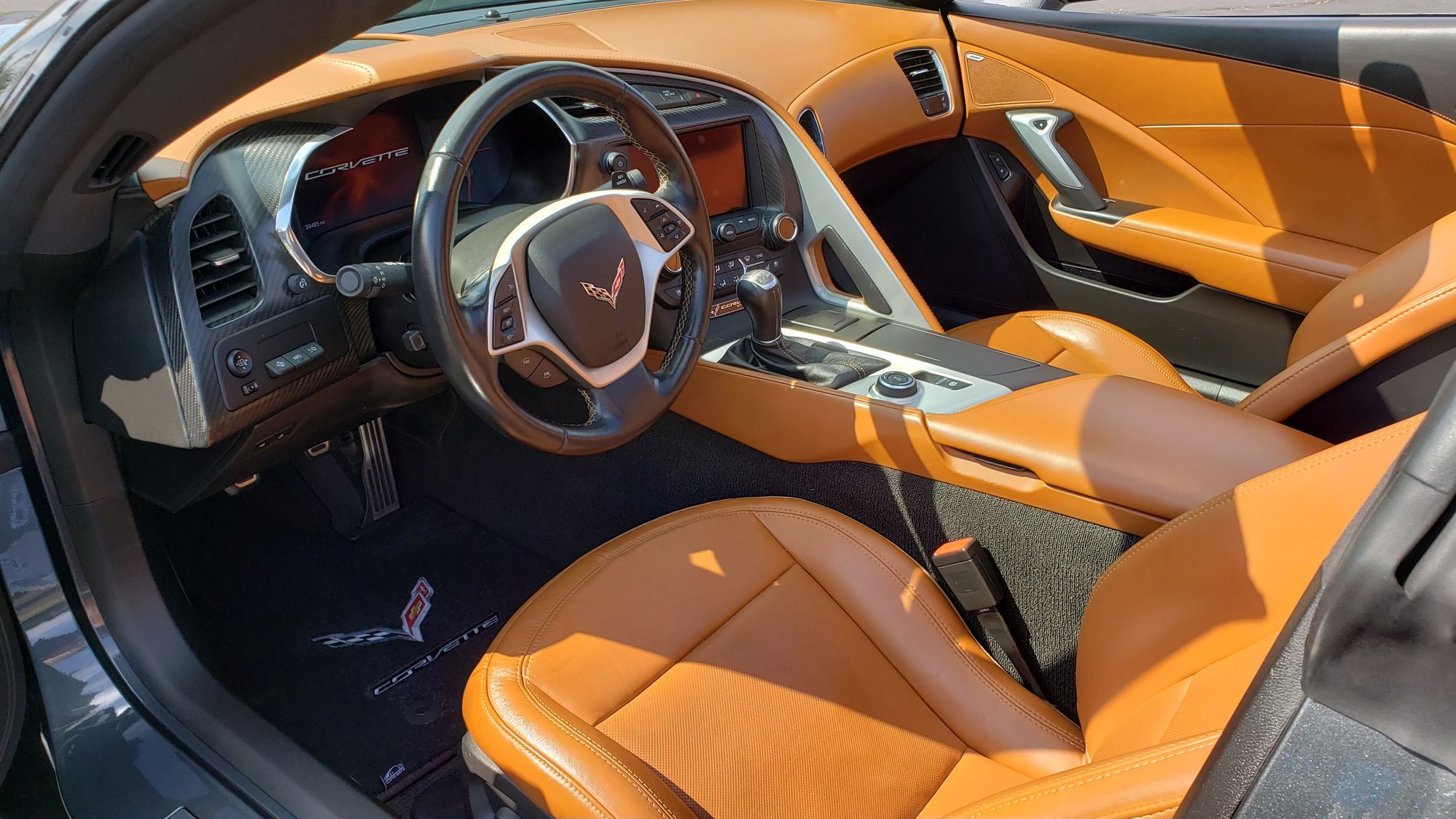

My 2014 was a 3LT - not one issue with its interior...ever! I'll also add, that I dont just clean my leather with water (like the manual suggestions). I always use a leather cleaner & conditioner...to help avoid ANY leather issues:

Man, these Kalahari full interiors are absolutely stunning. Just gorgeous. Wow.
