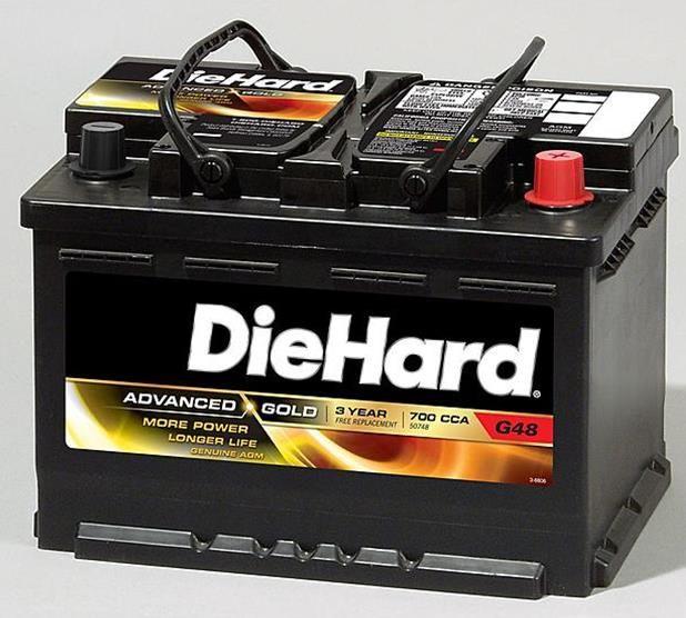

If new is needed the below is a good replacement.

I replaced mine myself, so the GM Service History report may not mean much relative to a battery. I replaced mine with the battery Kevin A Jones shows above.

Could be original, as stated above check the date code.
I just replaced the original battery in my ‘14 a couple of months ago. I went with the one pictured above. Was right at $180 installed at the local dealer.

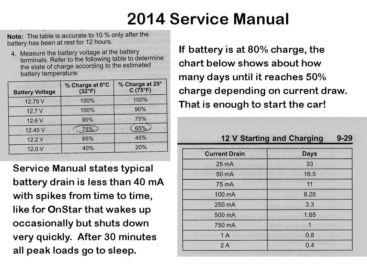

This is a PDF with some replacement "things" to watch: http://netwelding.com/Battery_Issues.pdf
I replace my 2014 with a AGM with 760 CCA (cold cracking amps) versus OEM with only 565 CCA. Paid less than $150. Autozone, Advanced Auto sell they now. I bought a Diehard.
Below is some composite info I made from the 4 volume Service Manual.
